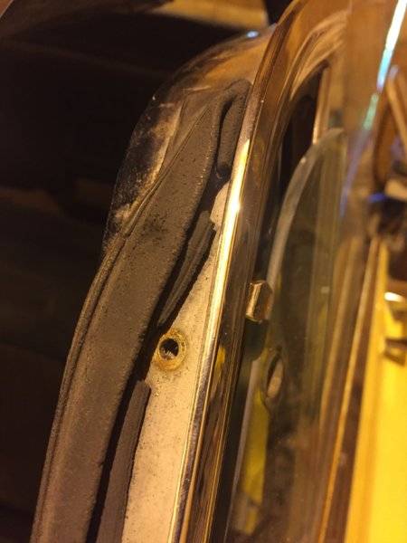

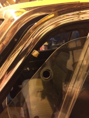

Can’t get the upper pivot out. What am I missing?

Pull back the rubber, is there a second rivet?
Never did an early B but 66 on there are two rivets holding the upper pivot in.

Just redid a set you have to pull it out of the car the pivot is riveted to a channel that the screw you removed holds in. The entire vent frame will need to be disassembled
