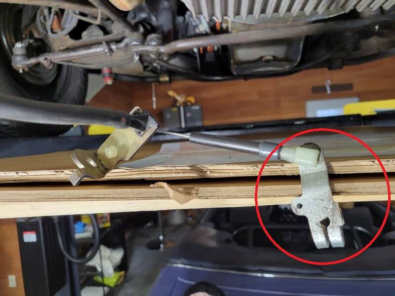

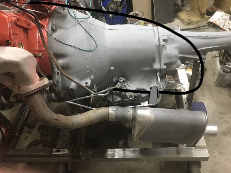

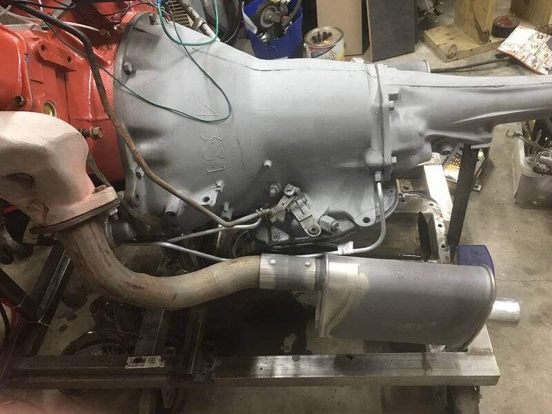

ok, so , im not n idiot after all, this is the kick down cable, i just cant seem to figure out how to hook it up..it was hooked up on the trans where the cable connected to gear selector..

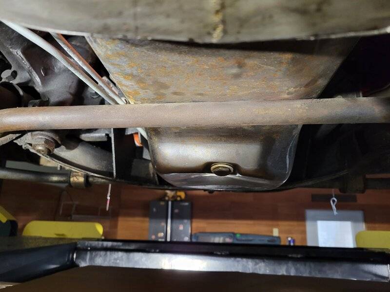

and a new problem !
oil pan is hitting steering linkage !
There should be 2 levers on the transmission. And they should move independent of one another. One should be pointing towards the front. And one about 90 degrees of the trans pan. The last picture you have there above this post. shows the original kick down lever. Notice the D shaped shaft mount. It only goes on one way. The lower one is the shifter lever. The top one is the kickdown.

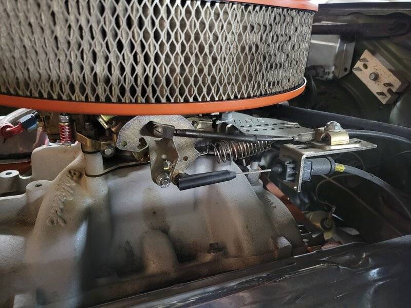

This is my 440 with a 727 the levers should be very close to the same. Notice the top lever hooks to the kick down rod coming from the carb. The bottom one should get a rod from either a floor shifter or a column shift. If that is the case then you have torque shaft that goes from the frame rail to the transmission. If you look towards the front of this transmission where the kickdown rod goes in a 45 degree angle you can see a hole just in front of that kickdown rod. That is where your column shifter would go to from the frame rail. Also that depends on the year I do believe.

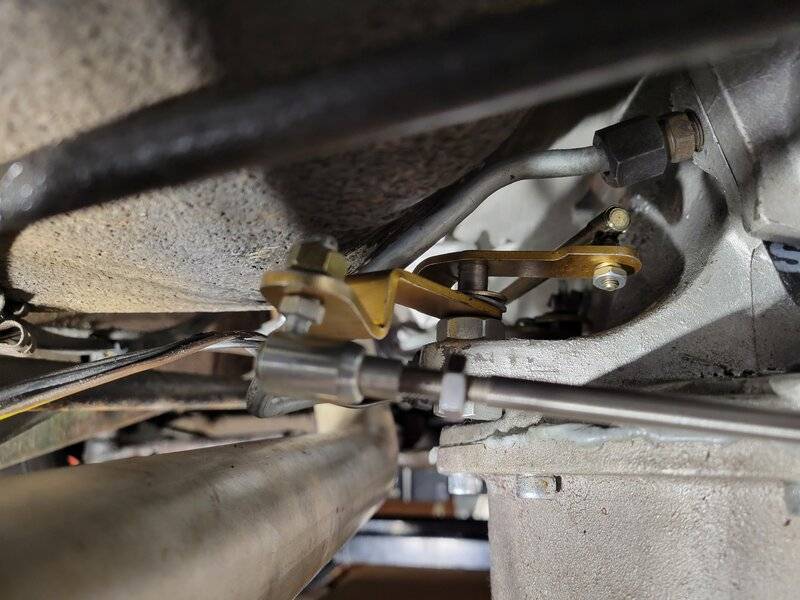

This is your picture Where I have the yellow arrow what does that rod hook to?

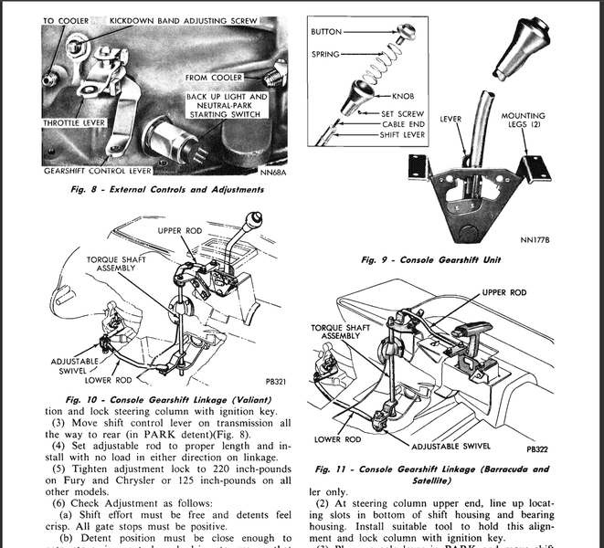

Go here and download the shop manual for your car. Which looks to be a 71 Plymouth https://mymopar.com/service-manuals/
Make sure you download the chassis one as well as the body one.

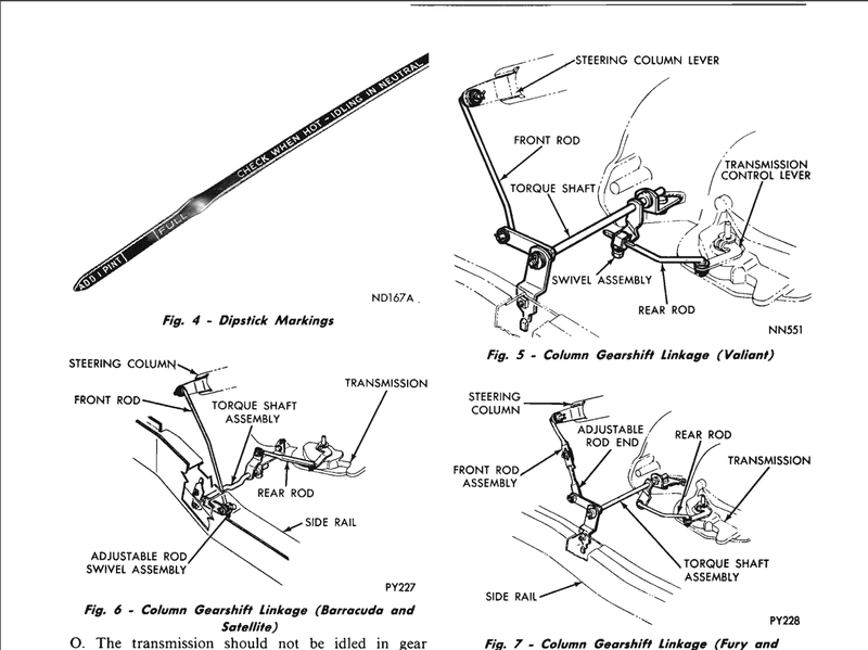

Here is how the shifter from the column linkage is laid out.
Here is the automatic Floor shifter linkage laid out. Bottom right drawing.
Take the top gold lever off, install your old lever put a nut on top of it. Then bolt that bracket that is closer to the cable somewhere on the transmission housing. The rod and lever that are on top are not going to work for your kickdown cable. The one I have marked with a yellow arrow. Take it off and the gold lever too.
Put this one in its place. It only goes on 1 way. Notice the d shaped shaft hole. The cable may come from the back of the transmission but the original kickdown linkage would have come from the front. Your cable will pull from the back.
Should go something like this. This is just the kickdown...
Correct. Same style used on the later magnum engines. The L shaped bracket with the tab should bolt to the ear behind the levers. Then the lever attaches to the top of the shaft. There is a square push button on the engine side that allows adjustment of the cable length right behind the bracket holding the cable.
Yea its just like putting a lokar cable in for the kickdown.

As far as oil pan check all your engine and trans mounts for loose or broken worn out parts.
