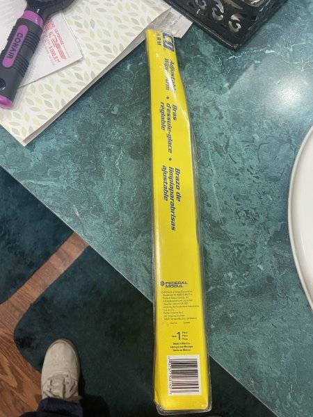

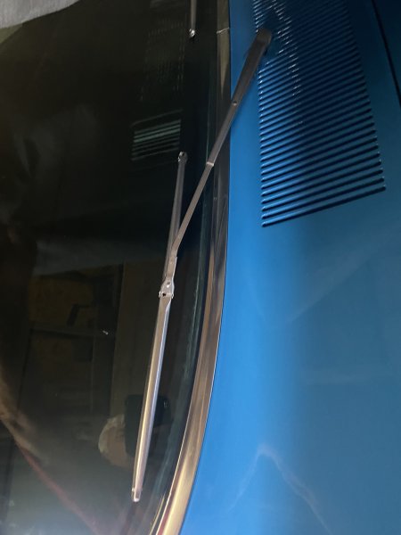

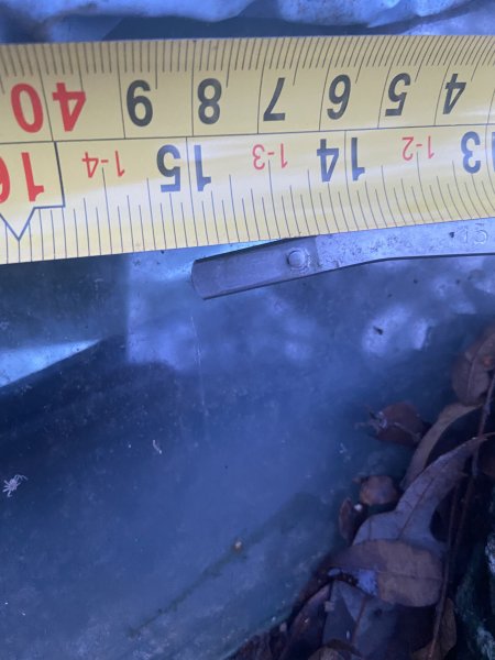

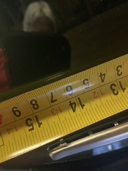

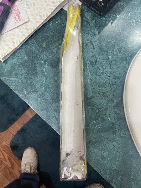

Mine is a 68 Coronet. I installed 15 inch wiper blades but they hit the upper windshield trim. Is 15 inch correct? I have also searched for 14 inch blades but I have not found them with the correct bayonet style mount. Any ideas? I suppose the arms could be incorrect but they came with the car. If one of you could send me the length of your arms I could confirm mine. Thank you and Happy Thanksgiving!
I believe 15 is correct, do you have the right wiper arms?
15” on the blades and 15” on the arm.
Arms should have 15B on them... sounds like someone threw 16" arms on it.
