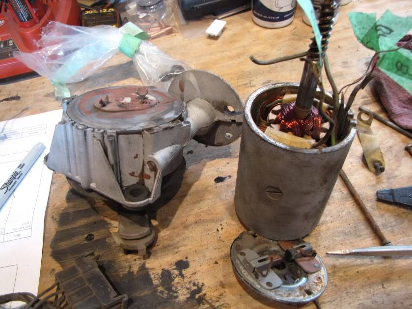

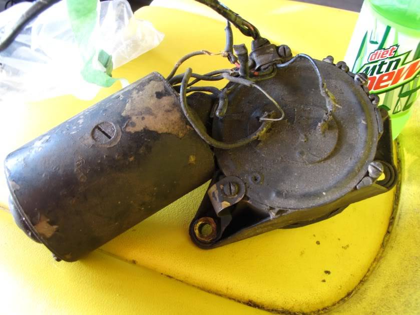

I've removed my wiper motor to clean it up and do a little refurbishing. Over the years it's been painted flat black. I want to take it back to at least appearing factory original. There's a few different ways I can remove the old paint. Stripper, sand paper, wire brush, etc.
What would you guys do? To me best case scenario, I use a chemical stripper, the paint falls off, and all the original finish is there. Though I think that's a little optimistic.
Also, since i'm assuming the original finishes will all need to be redone. What color were the individual pieces on a '67 Satellite?
Any pictures or tips would be much appreciated.
Thanks guys!

Thanks for the link, definitely learned something. It seems as though i have a "Leece Neville" manufactured piece. Which is supposed to be half black.

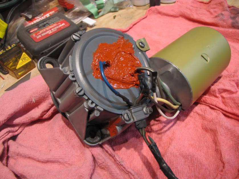

I threw mine in my little booth blaster...Worked like a charm. Replaces the wiring, cleaned up the internals, painted the aluminum cast with cast blast, Used Permatex to duplicate the orange sealant on the face, then used Eastwood's Carb Renew II, to try and duplicate the motor case.

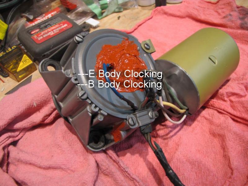

Propwash that's a B body motor although it's "clocked" for an E body currently, probably won't park in the correct position once reinstalled...but it looks like it was not clocked properly from the beginning stages. Rotate the switch plate nib (at approximately 10 oclock), to the position below the "C" or horseshoe shaped timing position and you'll have it timed/clocked correctly for a B Body :eek:)

Wow.....Great to know. I appreciate it very much! I was just going off of what it was like when I pulled it, but the car was a total cobble job when I picked it up, so who knows... Thanks for taking the time to indicate that and modify the pic.

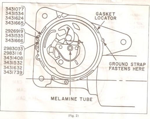

You are most welcome. I've cruised the ole hard drive and scanned the page from the FSM so maybe it's a little easier to understand than my quicky edit on your original photo :icon_eyes:

Thanks '69Net that one was kind of a "gimme" it was the first thing I noticed on Prop's photo of his motor but it helps to back it up with some useful info in case it's needed in the future
Very interesting, that turned out nice. I may try to do that with the old motor I picked up to use as a core. It looks about as bad as yours did to start with. If it doesn't work or there's broken parts inside I'm not out much but time.
