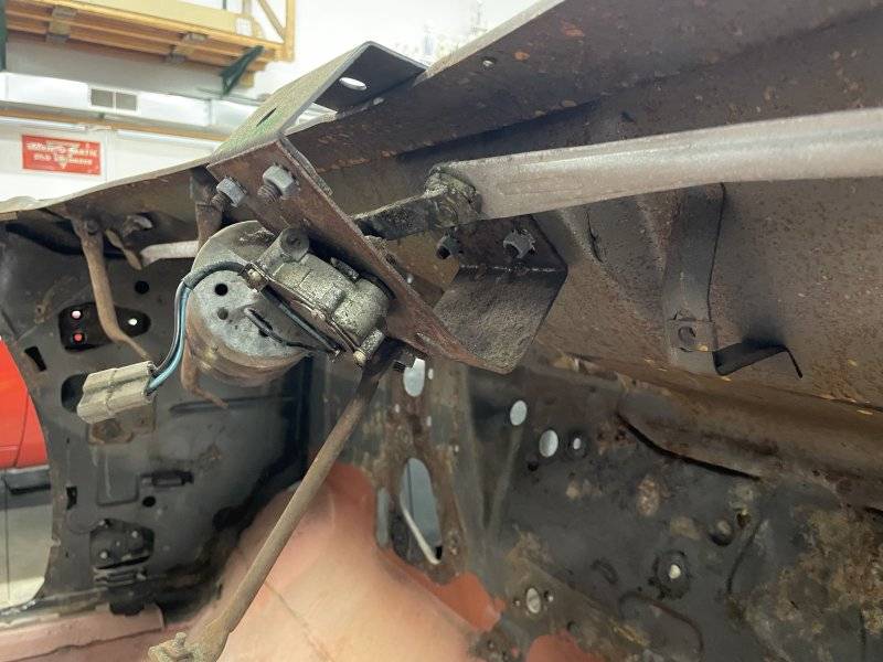

View attachment 1615482View attachment 1615483
Thanks for the pics. Sure does look a lot easier with the dash out! As far as power, I believe we are good there because when I hit the switch, the wiper arms move ever so slightly. That’s why I was thinking the motor was bad

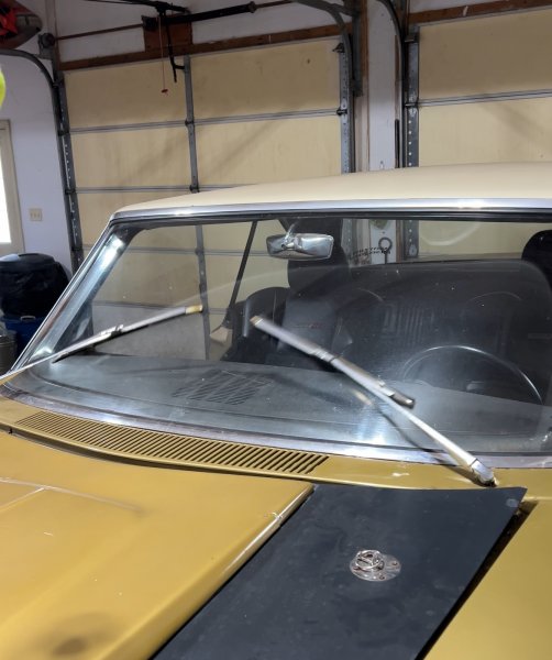

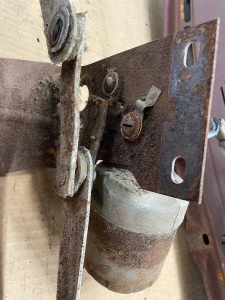

So i got it. Ended up actually removing the glovebox and the radio and managed to get in there to get it out. The motor was bad but also the driver side pivot shaft that goes through the cowl was frozen and didn’t move. Ended up taking the motor and both wiper arm assembly’s out. Freed up the driver side pivot and lubed the linkage. Didn’t have a seal and bushing kit but everything seemed nice and free. Put it all back together and it works perfect now. I plan on completely going through the car in the next year or so and at that time when the dash is out, I’ll get the seal/bushing kit and do it right. For now, just want to enjoy the car
