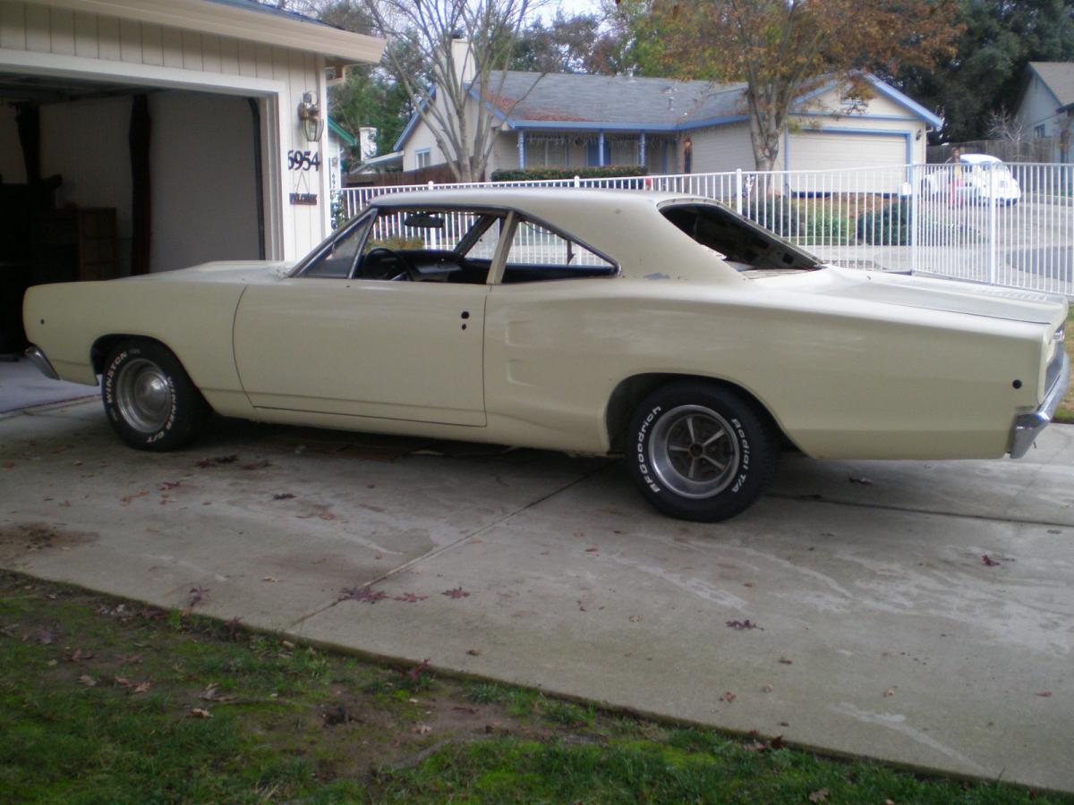

Thanks very good info. It is a 68 Superbee.

No problem... Nice Bee! Good luck with it..
