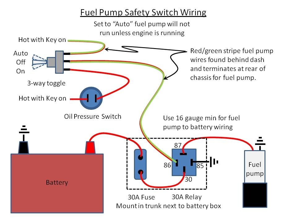

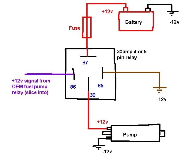

Found this by googling...pretty simple..

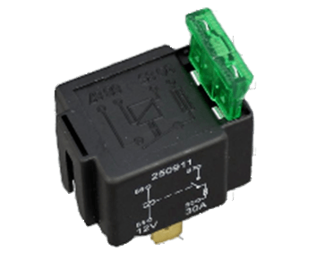

Never seen one of those before, its essentially the same thing but with one component. I have a $4 relay that has a fuse holder built in, a $4 inertia switch + the wire.... Using the tach output to monitor is something new though....
Just goes to show theres more than one way to skin a cat!!!

I have a low oil pressure shut off switch in case It gets into a accident, It shuts off the pump under 5 psi. I do like the inertia switch someone post a link where to get one please.
