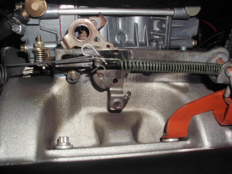

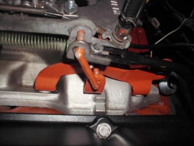

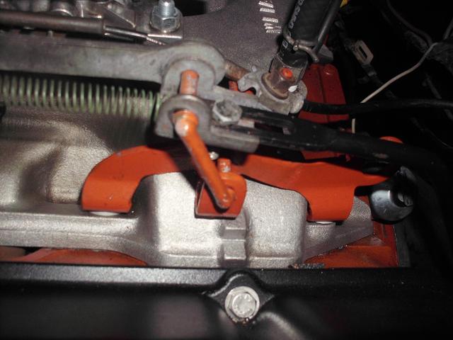

Hey guys been fiddling with the kick down on my car, its a 69' 383 matching 727 combo holly 600 on it, the kick down was for a 2 barrel carb so we had to move the hold down nut for the throttle cable forward and weld the throttle link that connects to the kick down off the carb stud shut some to get it to engage the kick down on the tranny all the way while the throttle is fully engaged. Before this adjusting was done the tranny would shift boom 1,2,3 right away as soon as you took the car down the road. Now it shifts fine from 1-2 and actually engages the passing gear but will not shift into 3rd at all and just whines in second. Any ideas on what will cause this? Pretty stumped on what to do.

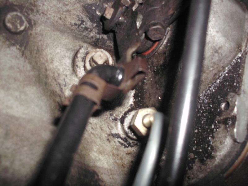

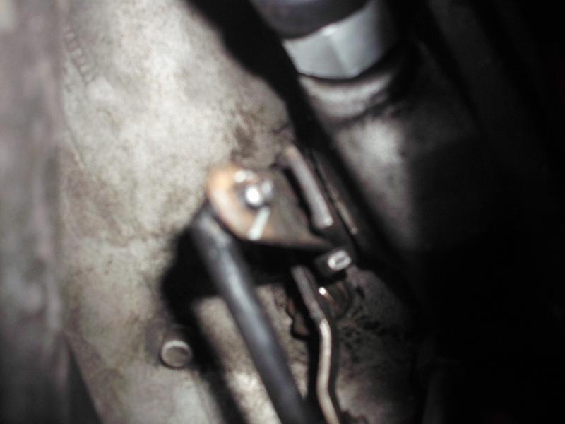

Ok well here are some photos of the kick down, it fully engages the kick down lever on the tranny when the throttle is all the way engaged. Any sort of suggestions on what would be causing this issue would be appreciated! I still have no idea if the kick down is the problem.

OK, just at a 1st glance it looks like the linkage arm is all the way at the back of the butterfly arm. Have you tried putting a spacer like a bolt or something to move it further back and see if you have any better results?
I may be totally wrong but it just seems too far back.

The easiest way to check is to have have the throttle all the way to the floor(not running! LOL) and try moving the kickdown lever on trans to the rear. It should NOT have any more movement to the rear. Everyone else is correct.Kickdown linkage tells the trans where your throttle is, in relation to what governor is seeing while spinning around. They all interact with each other.

with the system cobbled like it is now it is hard to get the right set up but not impossible. just pop the bar off at the carb and run around the block, if it shifts 123 then your trans is still ok. but don't keep it this way as you will burn out your clutches. if all is good then the easiest way to cobble it up is to play around with the length of the bar at the carb. or as in your case you have some adjustment up top as well. rule of thumb is you need to have the throttle lever down on the trans all the way back at full throttle.and when you are at idle there should be some free play between the slot on your bar and throttle pin on your carb not to sure of the exact spec i do it by feel. then i ususally play with the adjustment till it feels like i want it to.i find that if the trans is downshifting hard automatically as i slow down i have it set to tight. so you would give it a bit more free play or slack. you may have to shorten the bar or slot it some more to get what you need sice it is not stock anymore, it does not have to jam the throttle rod back to hard to work ok. hope this helps. cheers
