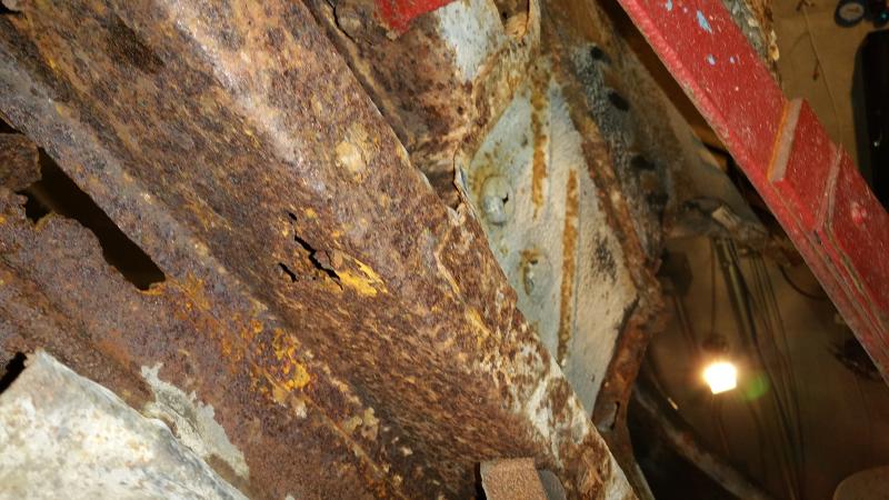

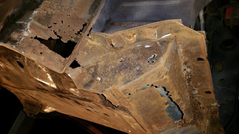

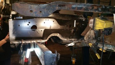

i guess ill post my progress here for my 71 bee
working on it almost everyday excited to see it come together, my first resto and classic muscle car.

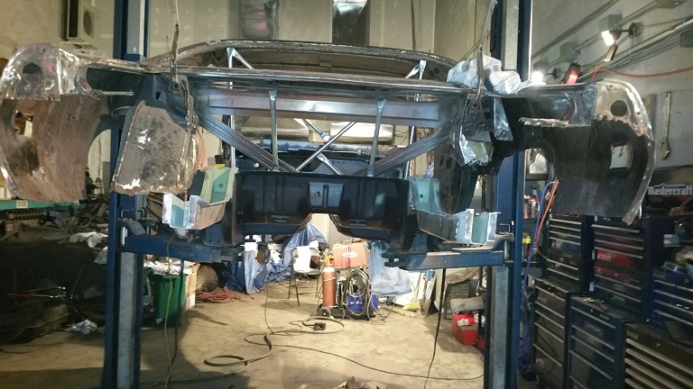

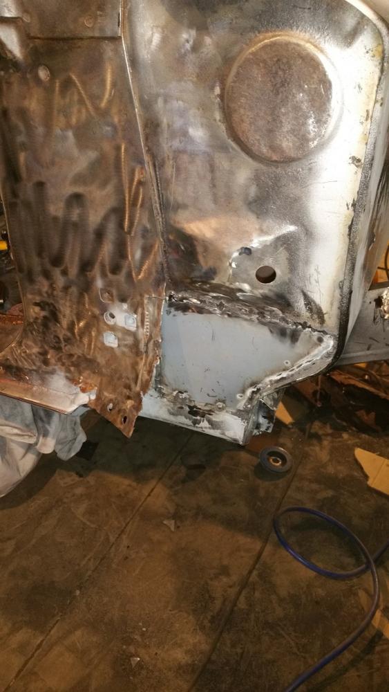

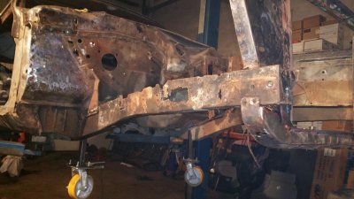

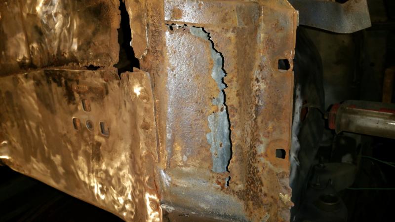

both frame rails replaced. now working on driver side outer rocker panel

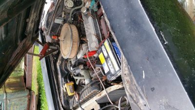

History photos with before pictures:
$_27.JPG20151005_095808.jpg20151005_095823.jpg20151012_200046.jpg20160109_031112.jpg20160114_141411.jpg20160114_141418.jpg

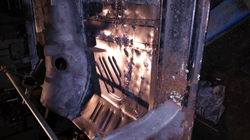

Restored so far:

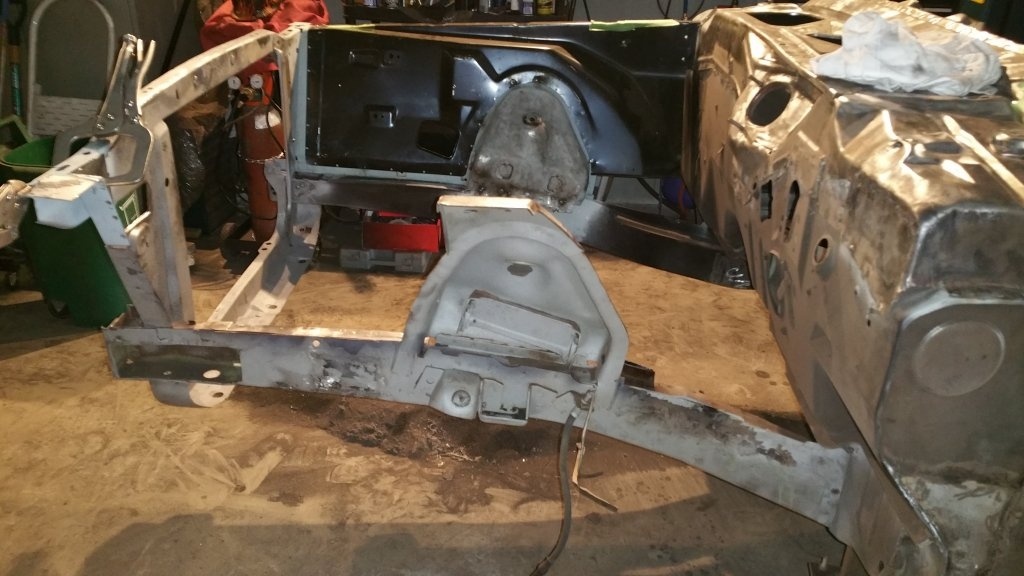

Front passenger frame rail:

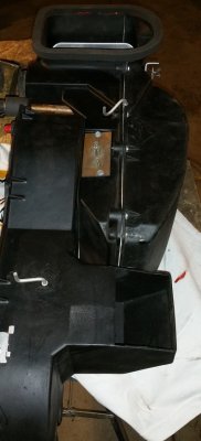

Heater box:

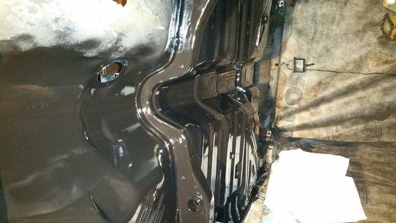

Primed most of the bottom: (sand blasted)
Driver floor:
Passenger floor:
Driver front rocker:

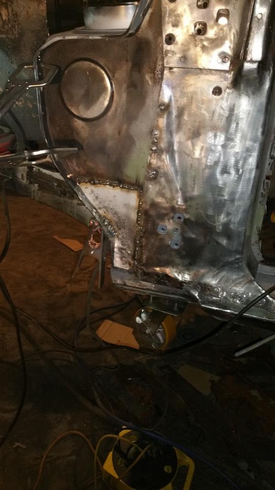

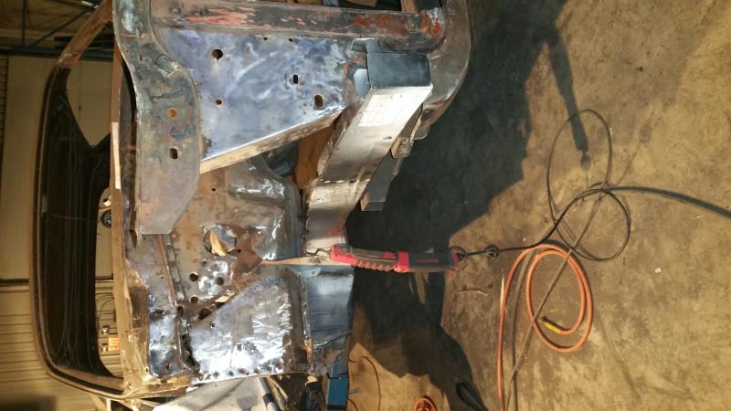

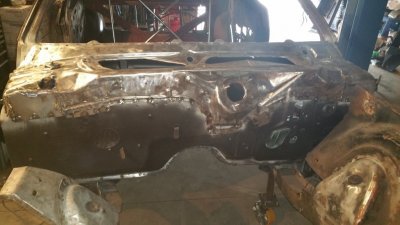

Welding on firewall:
Passenger front rocker:

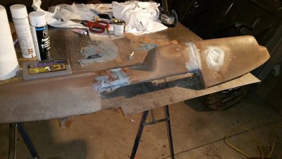

Was working on my dash pad:

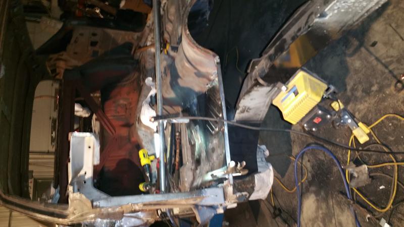

Now we are working on side firewalls before we weld the remaining firewall front
$_27.JPG 20151005_095808.jpg 20151005_095823.jpg 20151012_200046.jpg 20160109_031112.jpg 20160114_141411.jpg 20160114_141418.jpg 20160124_050056.jpg 20160130_005715.jpg 20160303_165022.jpg 20160303_165032.jpg 20160325_023616.jpg 20160325_023625.jpg 20160307_094448.jpg 20160129_163513.jpg 20160205_123957.jpg 20160213_002113.jpg

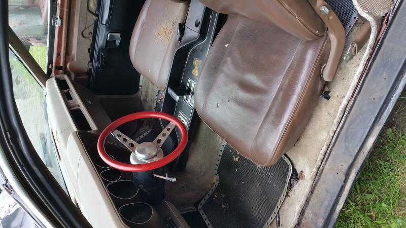

Holy crap that's a lot of fab work! My I ask why your building that car? Is it a real bee? Or a family car? It just looks super rough,it might just be the pictures though! Ether way you have my respect for saving it good luck I'll be watching

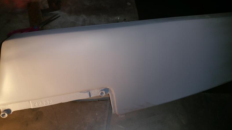

It's a real bee the original owner put a scoop and flares which are all coming off with the new quarters I'm putting on.
When I bought the car I didn't really know what to look for and we thought the rails were good but ya that changed after taking it apart. I'm going to drive the car myself no plans to sell it so gonna complete it making a lot of progress lately
Well a bee is a bee and it's worth fixing ,good luck I'd I'll be watching this

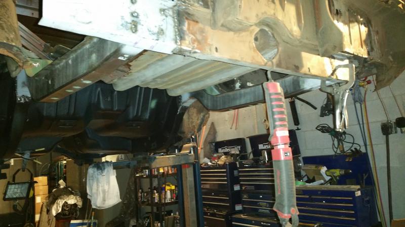

finishing up side firewall panel last night driver and passenger
now we will be putting back on frame tower and other brackets on the passenger rail followed by new inner fenders

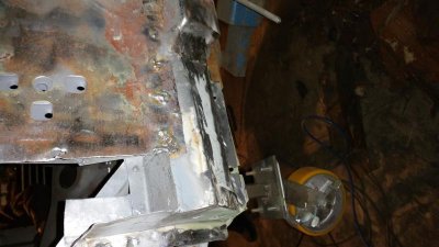

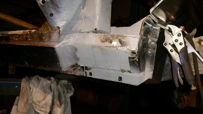

working on rear inner rocker driver side
was going to do shock tower but ill wait until friday for that when help is with me

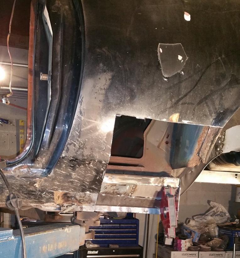

Posting update. hacking away at rear ripping out wheel wells etc
i had a question. should I install quarter panels first with everything else clamped on ? someone told me I should seal the rear side of the butt weld and that would be alittle difficult once wheel wells are on. any advice?
What is going on with old truck behind the bee, looks a dodge?
oh in the original picture? im not sure lol its not mine its where I picked up my car
he had some chevs there as well that he was selling and a mustang
im not installing the full quarter but the partial hand molded as only half of the quarter was rusted out
the person told me if i dont seal behind the butt weld it will start to crack and itll come through the paint? it wont come apart but the bondo will crack. wondering whats best approach? if i primer over the welds from behind, is that good? id be using an epoxy primer
Not sure about your joint question? Are you welding or gluing the quarter on. I would think if you're gluing the 1/4 on it would be fine, welding I'd seal it. Anyone else want to chime in? I might be wrong but that's how I'd do it.
I tacked in my wheel wells then hung the full 1/4s.
the issue is in the window chamber how to seal in there when wheel wells are back on

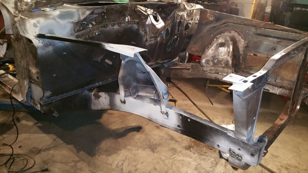

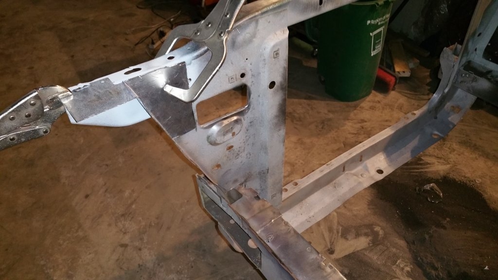

Welded shock tower and fender support bracket. Next fender goes in Monday
working away at the bee
working on driver side fender and repairing rad support.
