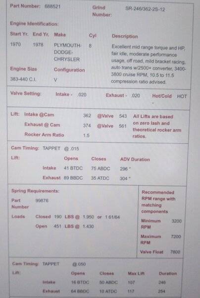

Would this cam work good for my engine?
67charger383
2:03 AM
Dec 13, 2019
1,258
5,095
Maryland
Engine specs: 383 bored 30 over, forged rotating assembly with TRW 12-1 dome pistons and 915 heads, Weiand tunnel ram, E85 carb, Msd 6al2, and a Milodon gear drive.
4.11 gears and a 727
The cam is a crane 688521 sr-246/362
Solid roller. Here's the cam card:
