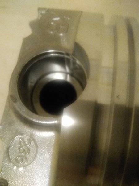

Below piston picture with cirlclip on 236, am I right?

Pressing the wrist pins out is fine. Problem is the pins no longer friction fit the rod. Will they all end up the same? Who knows. But I wouldn't chance it with them. You either have press fit pins or circlips. Not both or they will bind. The 236 is set up for press fit or float.
