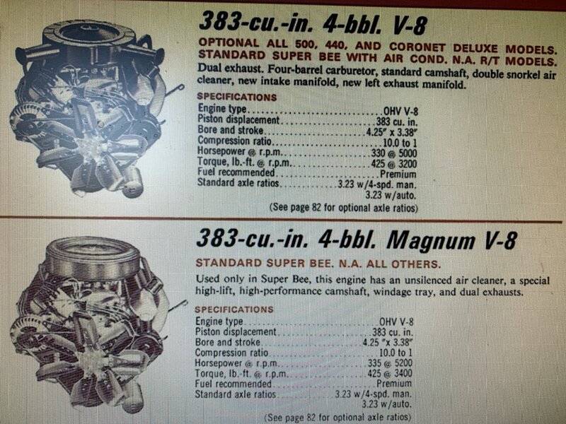

I can tell you the info for 70 is wrong. The 383 magnum was available in the 70 charger and was most definitely orange.
here is the factory literature for the 70 charger.

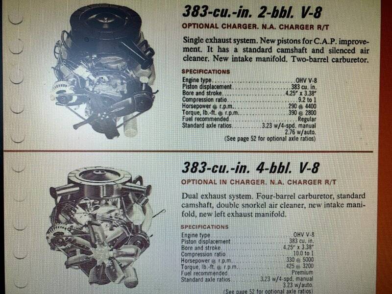

Some of this contradicts the dealership data books, unless I’m reading them wrong for 69 models. Do the dealership data books contain incorrect information?
From the 69 coronet section.
From the charger one.
Yes. It's one of things that leads to and perpetuates confusion.
The data books do not and cannot explain all of the nuances of the installation applications. That info can be derived from broadcast sheets and Lynch Road fender tags.

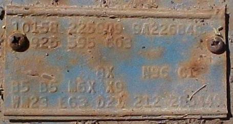

Here's a pic of a 69 Charger Broadcast sheet. E63 383-4bbl four speed no a/c. The 925 engine assembly is circled. This is the same assembly that will be shown on an equivalent Road Runner, Super Bee, Sport Satellite or Coronet broadcast sheet or Lynch Road fender tag.
69 B bodies with 383-4bbl and four speed with no a/c got the orange 335 horse assembly regardless of the actual model.
