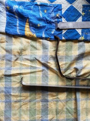

now I am no mopar guru but i have a 69 plymouth satellite and I ordered a pair of stainless tank straps from classic industries and when I went to install the new tank I noticed the straps are not correct. it appears that the new straps have been stamped incorrectly. specifically the end with the 90 degree bend that is facing the opposite direction of the oem part. am I correct?
i contacted classic industries and sent them photos only to be told thats all they offer and have not had any issues with this part in the past. they clearly did not understand that it appears the part has been manufactured incorrectly.
thanks for any input.

The tank strap obviously did NOT receive the correct bends....It is perfectly straight, lol....Anyone looking at your photo can see that a mile away.....
Yet your response from classic was, "we never had a problem with them'...."we dont understand how it was manufactured that way"........
Thats great quality control there.......For both companies......

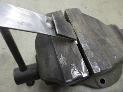

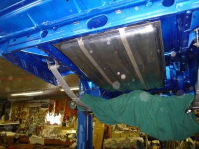

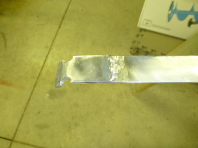

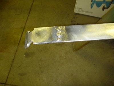

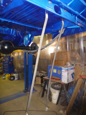

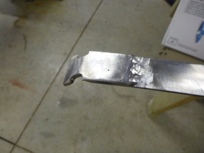

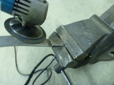

My straps were bent and welded backwards.. had to cut the reinforcements weld, then bend the other way and re-weld.

Inverse1216, I think that Classic sent you a 66-67 B-Body fuel tank strap by mistake. Possibly it was incorrectly labeled or placed in the wrong area or got put into the wrong order. As your doing, attempt to see if they can resolve your issue.
