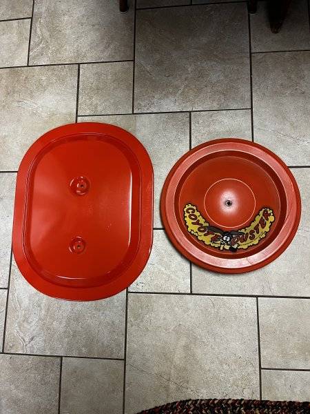

70 rr Not sure which Cover I need to be correct the the for a 4 barrel 383 The long one or the standard cover will consider either one. I also need an end cap for the flapper door closest to the vacuum actuator if there is a difference?

Do you have the base already? If so that determines what lid or cover as you say… They do not interchange the base determines that.
I do have the oval base!

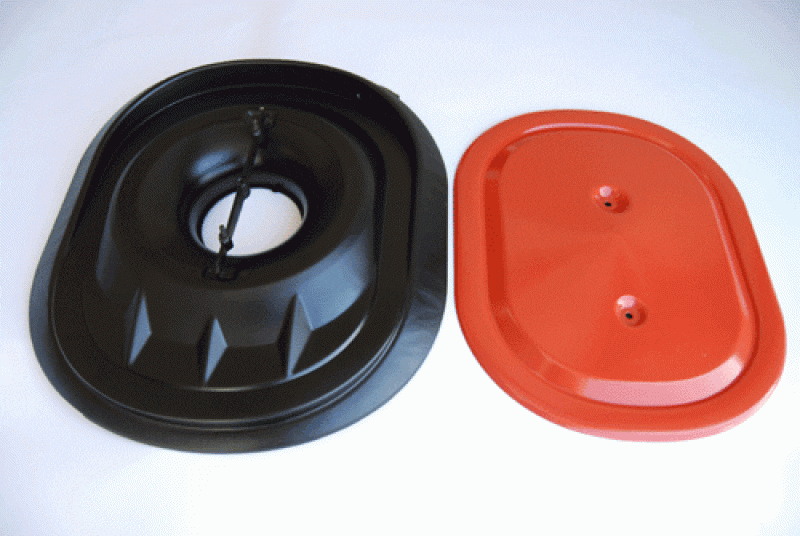

Ok. That determines what lid it takes. If the base has 2 studs on it, it takes the Large Oval lid like the one on the left. If no stud on base it uses the carb stud and it is the one on the right. They do not interchange. That said also be careful when buying a lid on the left as 6 pack is similiar looking but the screw hole spacing is different.

Correct that is 1969 and back except for Hemi they used those oval ones into 71. That said I believe either type would fit the 70-2 air box…

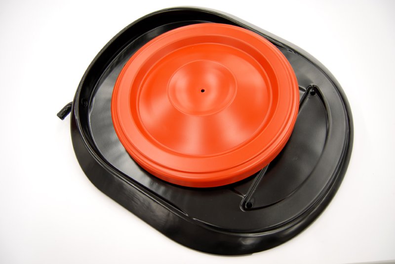

The correct 70-2 oval base looks similar to a 69 base except it takes the small round lid and filter…

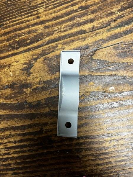

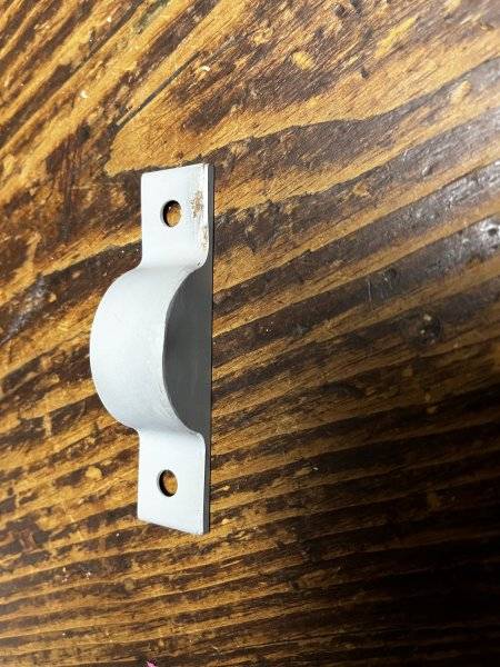

Found the reproduction end cap.. Pm any interest.

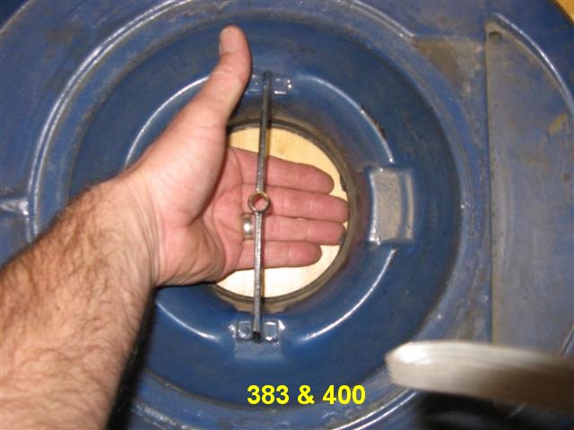

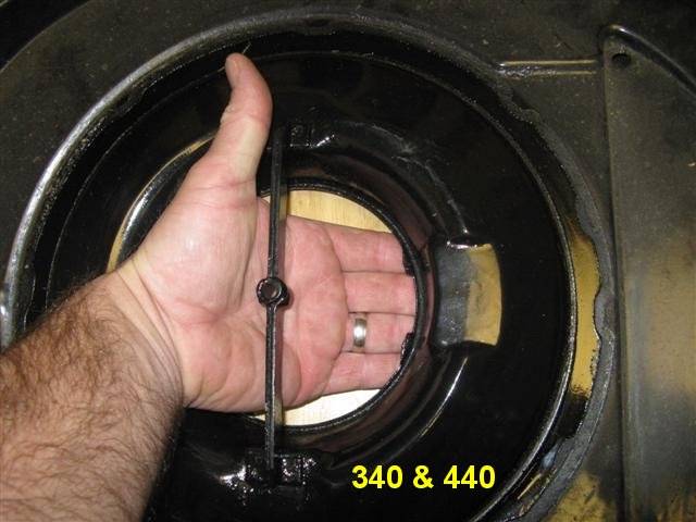

Note that the air cleaner bases are different too based on which engines they were used on. For 383 engines the "throat" is taller due to the fact that this engine sat lower in the engine compartment than the 440. The below pictures are not mine - I forget where I got them from but they hopefully help detail the depth differences.
So bottom line is not all bases are the same either - there are two types and you need the correct one for your 383 or it will not seal well against the gasket on the hood.

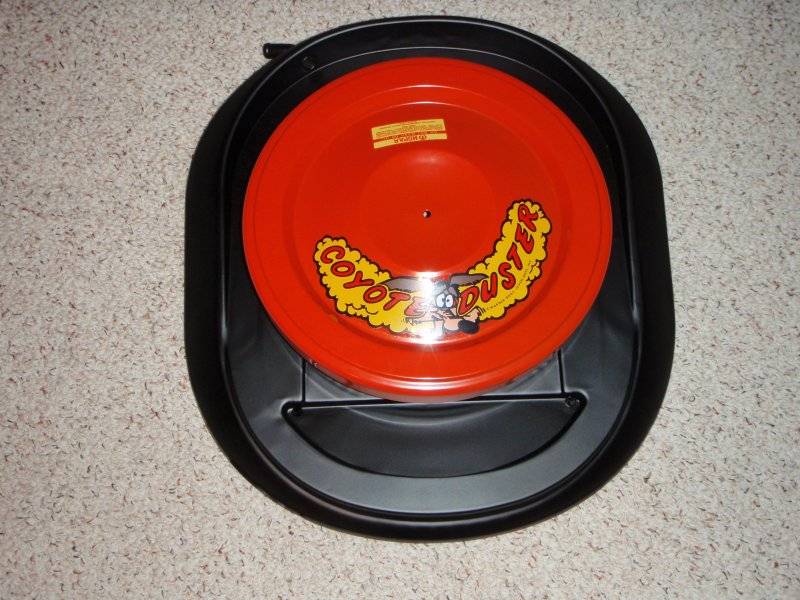

A 70 Road Runner air cleaner assembly should look like the below picture (same as what @QuickBpBp posted, this picture just includes the decals as well).
Those pics are from me on Nicks air cleaner page… I recognize my hand in the pics above!
I'm glad - I like to give credit where it's due, so now I know! Thanks for the pictures - Nicks air cleaner page was very helpful to me back in the day!

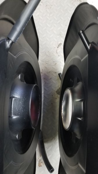

Edit: I found another picture (this one's mine!) that shows the differences. 383 on the left and 440 on the right
