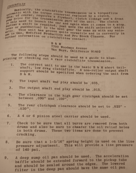

The MP Chassis manual has a short overview by B & M and a 22-point setup/spec list if that's any value.

That would 100% be useful to me
Ancient info from the '70s DC Racing Manual. Also in later editions of chassis. Not sure if it was in earlier Hustle Stuff.

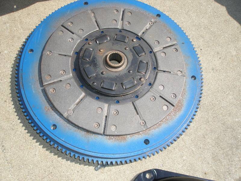

I bought a B&M Clutch-Flite in 1975 for $2600.00 along with an E&R clutch, pressure plate and flywheel.
I was building a "Race Car". Glad I never got to use it! I sold the entire setup, brand new to a fellow
member here about three years ago. Don Prudhomme ran one in a couple of his funny cars. They were
pretty strong and didn't waste any time shifting. They are illegal for racing now because the H.P. levels
that we have reached with better parts available. Mine was brand new and never used. I just put all of the
parts together so at the right time I could put it all together. Glad I never did though, because I still have
the 68 GTX that I was going to ruin and chop up!
