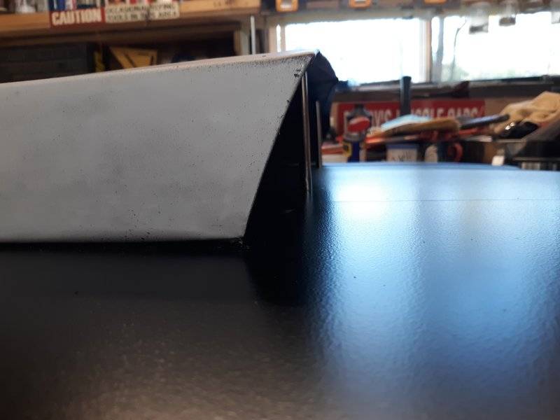

I'm going to change nozzle and needle and try again. Try to smooth it out some..
As it turns out, the paint settled and looks great this morning. Onwards to the roof! Well, as soon as I buy more activator that is...lol.

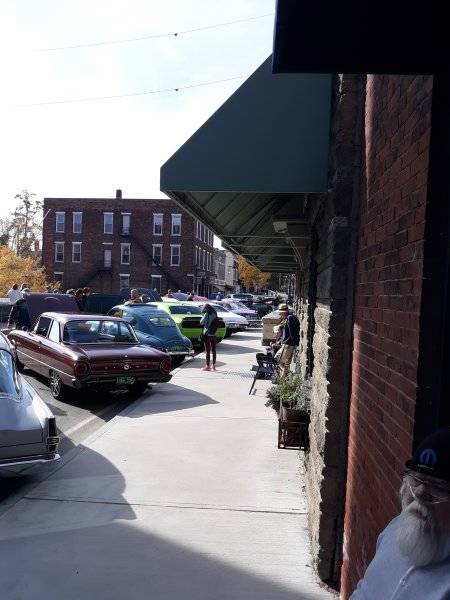

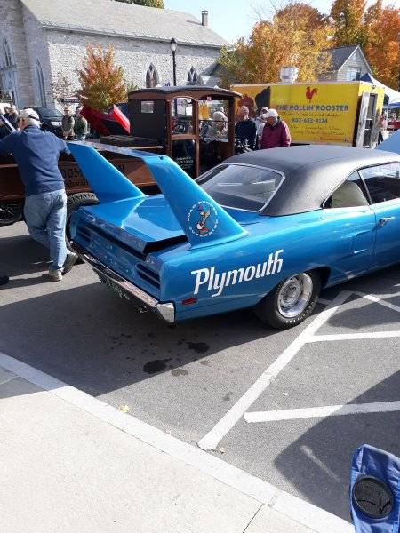

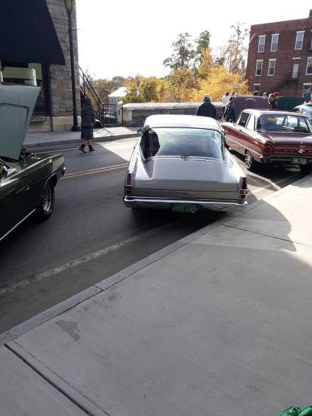

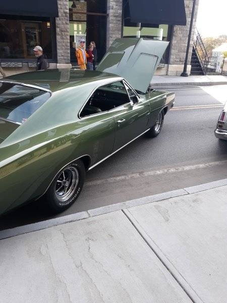

Went to a local car show today, not much there. About a half dozen Mopars and the rest was local junk. The Blue super bird is my pal Gary's. 1 of 308.

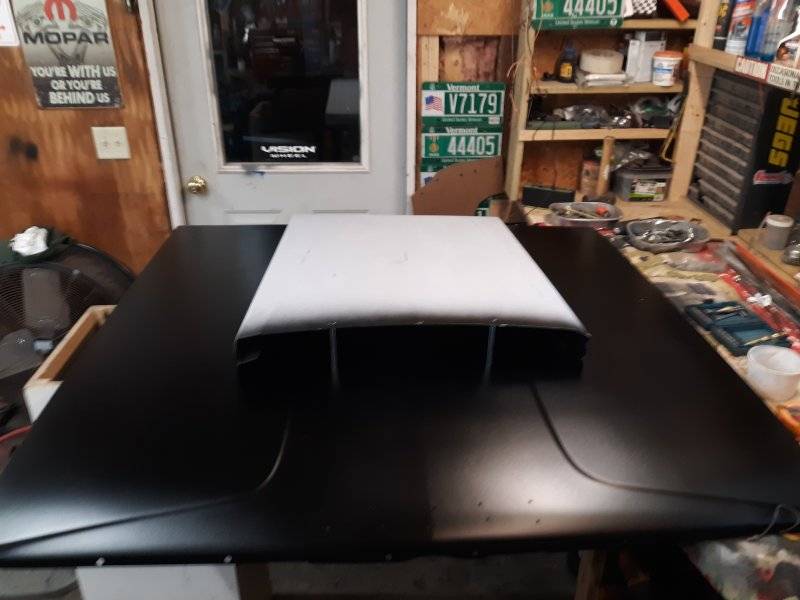

Plus I put the scoop on the hood in preparation of glazing the scoop to smooth it out. Fabricated the scoop lip hold downs.
I'm going to eventually have to round up two or three guys to help me hang this hood on the car....

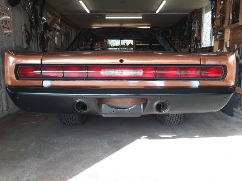

Thanks! Here's the list of all mods that have been completed.

fabricate the entire rear face of the car to accept 1966 Thunder Bird tail lights.

1970 Road Runner rear bumper lengthened 3 5/8" and recurved to hug the sheet metal. TTI exhaust to exit through those back up light holes.

You probably covered it but.....Are those taillights from a 66-67 Charger?
