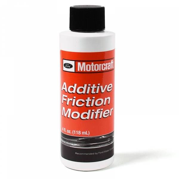

Shitcan the synthetic. Get a good brand of dino oil (my friend who ran a one-man rearend shop always used and recommended Torco), and two bottles of ford/autolite lsd additive. Take two aspirin and call me in the morning.

This is my first time to use syn rear end oil after doing a bunch of research and probably won't ever do it again! Just shows to goya......but I used 2 bottles of the Mopar LSD additive. So far so good but like I said earlier, going to get things warmed up good and see how it acts. So far so good with a cold rear end.

That's what I put in it initially....Mobil 1 syn 75-140 with the LSD additive built in....then I added some more additive and it didn't help at all. So, It's out and in went the regular oil with the Mopar additive and it's acting better.

Talking with Cass aka Dr. Diff, he stated that they did a study on the additives (friction modifiers) and the one that held up the longest was the Motorcraft (Ford). They do break down over a period of time. Any local Ford dealer carries it for around $7.00
Oops, said ford/autolite. Guess i meant ford/motorcraft.
