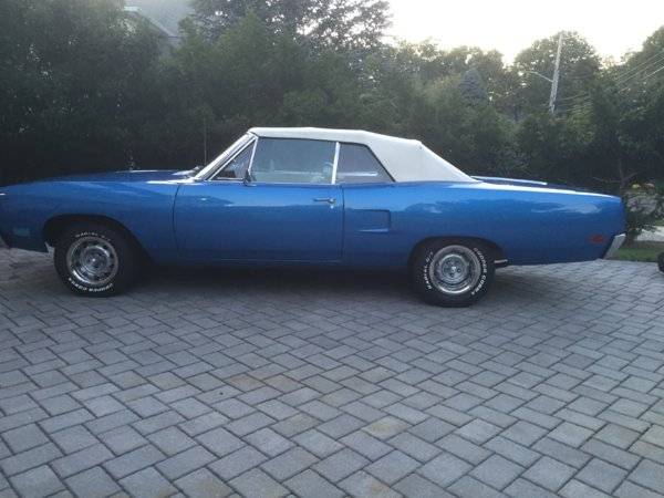

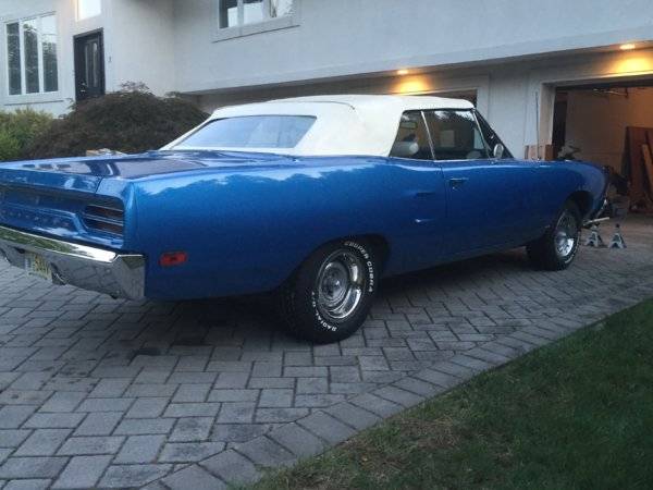

I agree. I have 235/60 front on 7" rims and 255/60 rear on 8"rims, on my 70 Satty droptop. Love the look and the ride.

I put Cooper Cobras on my 70 Satty. They ride very nice. I had BFG Radial TAs on my 70 RR and the Cobras are just as good, at a much lower price. With the black side out, it's a no brainer.
