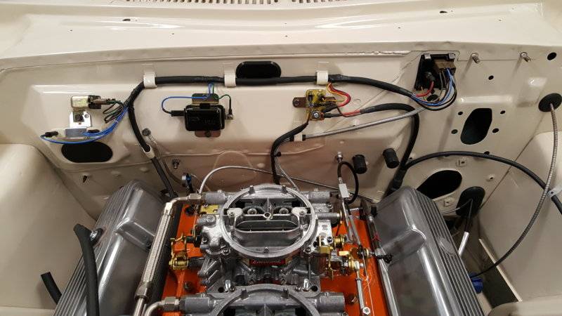

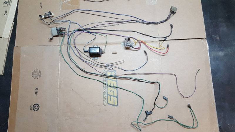

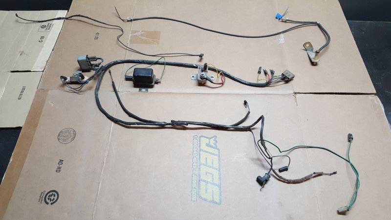

Some of mine is new, some is original. If they were soft and pliable and no signs of corrosion especially at the connectors, I used them.
If they were brittle, cracked, corroded, I replaced. You can buy any size and color wire from NAPA. They have a lot of connectors like what was used originally also. Special connectors can be bought also.
Original firewall harness...
Original stripped for inspection...
Finished product...

Finished product...
Kid that's just nice and clean.
