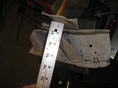

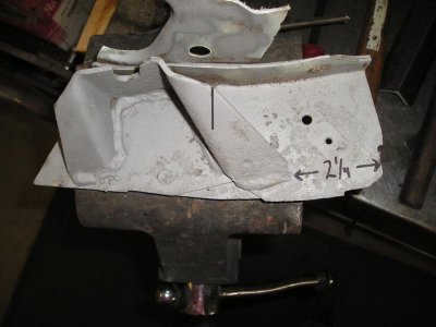

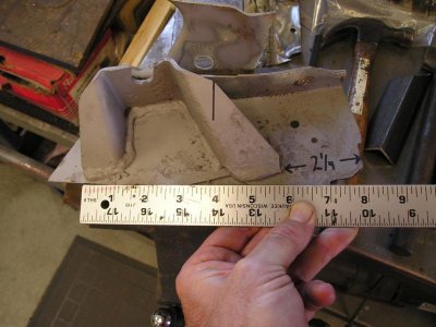

Here are a few shots of a '68 frame rail with the bracket attached. If you compare the pictures to your car it will make sense.
A few more pictures if you want to compare.

I don't have anything other than what's in the pics, and they are really not complete enough to replace all of what has been removed. Shouldn't be too hard to locate what you are looking for as you could get that piece out of any 66-70 B.
