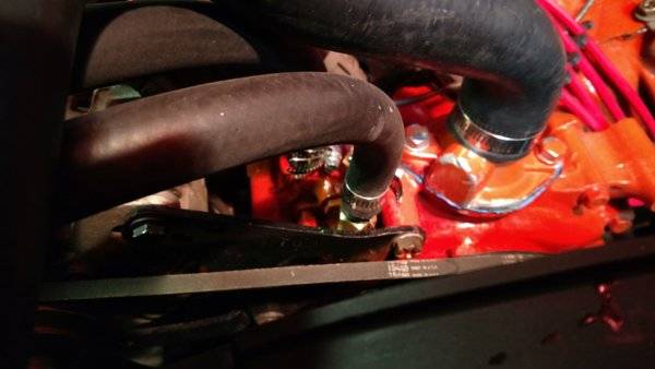

1/4" heater hose outlet on a 440??
crap. I thought I uploaded this pic yesterday. sucks gettin old lol
Yep, exactly where mine is. :)
I'm thinking now I'm going to use the 1/4" hole for the other hose and route it as normal. What's the worst that happens, slow flow through the heater core?

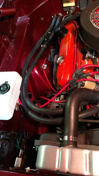

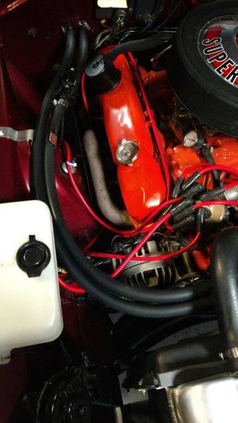

I decided to use 1/4" NPT outlets adapted to the 5/8" hose fittings on both sides, just out of paranoia more than anything else:
I also installed a regulation universal type 5/8" hose quarter turn heater valve on one side as well. Although I didn't go so far as to do so, it is the type that will work with a push/pull cable (like a choke cable).
I also chose this time to drain out the straight distilled water with Water Wetter and put antifreeze in her (with a fresh bottle of WW). Rascal took over 3 gallons of pre-mix!
I let her get warm as she would (which wasn't very warm, really - the Griffin is doing the job!), then decided to turn on the valve in the heater hose and pray that the existing core wouldn't leak.
Knock wood, I didn't detect any leaks. :)

I couldn't help it. Fetched the inner fender bracket and the one that stands off the top alternator bolt and installed them:
Yeah, the alternator one is on there. It's just hiding under the radiator hose.
P.P.S.: Yes, I know those are '69 brackets. You'll notice the valve cover isn't the correct '68-only one, so this was the only choice.

Hey, that 1st engine bay pic looks eerily familiar.:D
Don't reference it as "correct", its just this old shadetree hack making it work.

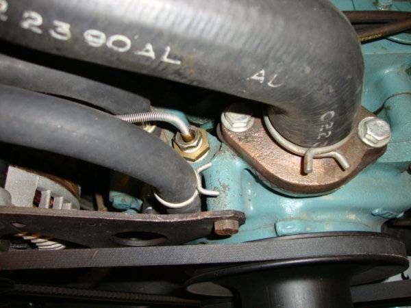

Somebody that knows more than me can speak to the pump housing differences by year, but I'm thinking you'll have plenty of heat.
That was the #s matching engine, but now has a quite radical 383. The "new" engine came without hose nipples. Simple trip to local NAPA, and picked up 2 long ones- Chevy application IIRC worked. Neither were 1/4 though.
