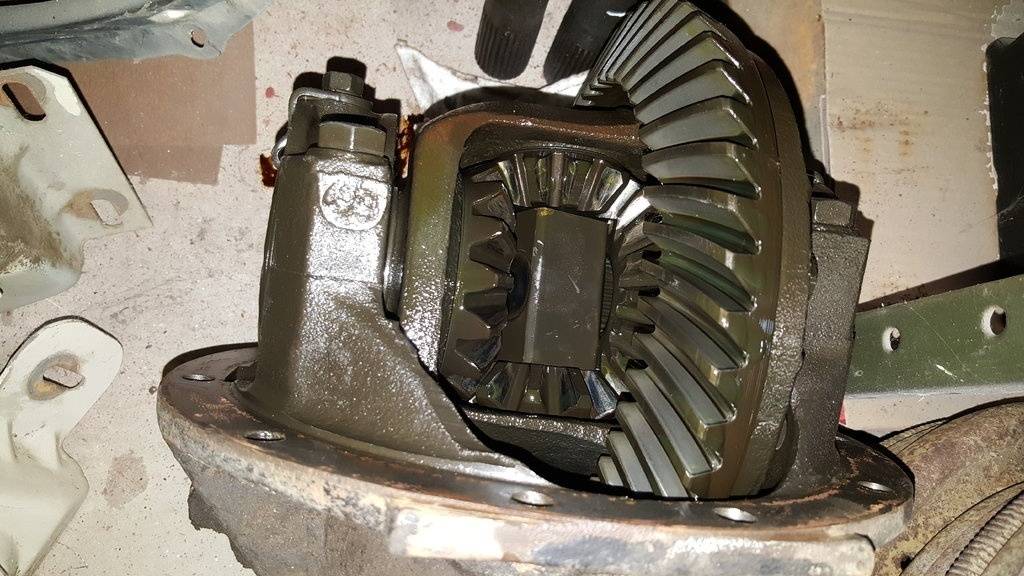

Hey Kurt, I have the same thrust block in my 1962, 741 open diff that I just pulled and replaced with a suregrip.I'm 99.9% positive the 741-case 2.76:1 unit I pulled out is original to the '68 Satellite, so it stands to reason the round thrust block is the correct one for that era. From what I could tell, it had never been removed until I pulled it.
Might look into some of the '50s Mopar forums to see if I can dig up any more info on these square blocks.

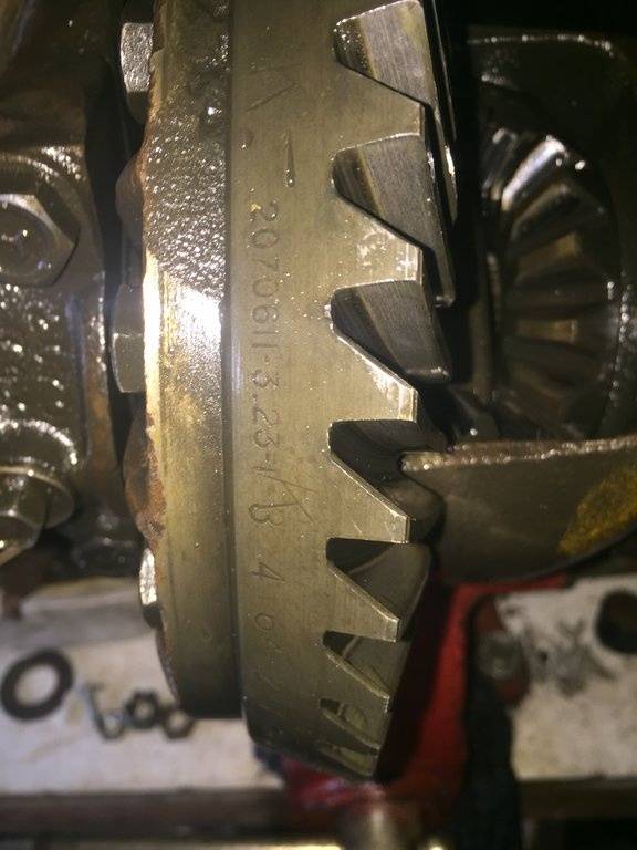

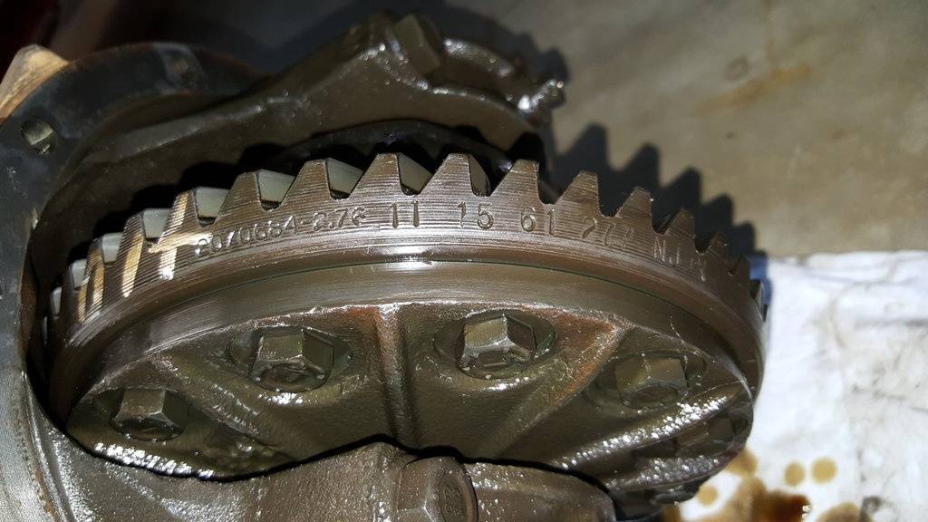

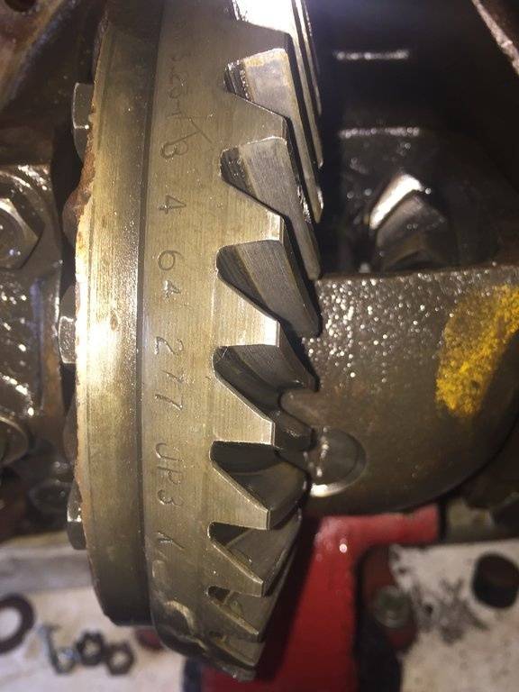

I guarantee it's just a piece of square tubing. I can even see a burr on the end of it from a saw blade. Thinking about it, it's all that's needed on a open rear to butt the axles up to, to set the bearing play. Can you see a date stamped on the ring gear like mine? (11-15-61)
