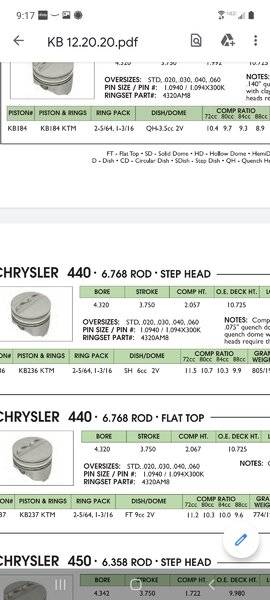

This is a bit general but from what I have found over the years lower compression engines lack a little "snap" down low but when they get a bit of engine speed up they are only a few HP off what they could be ideally.
They tend to be reliable and not temperamental so I think it is right " don't fix what isn't broken"
