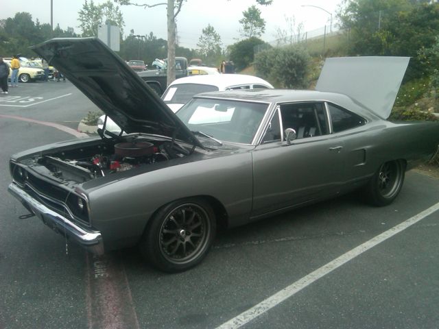

Considering B Bodies are zero offset that is high
Typical is half the overall rim width (add 1/2" for the lip) So 18 X 8 with 4.5" and 19 X 10 with 5.5" because some people go half the sited width I split the difference and went 4.25" and 5.25"
Well, you tell me if it works? :eusa_whistle:
Looks good. How wide is your rear rubber?
Front:
255/45r18 or 27x10r18 (-.8" width difference vs. 275's)
Rear:
295/45r18 or 28.5x11.6r18 (-.4" width difference vs. 305's)
With 6.3" backspacing, +30 MM offset, and .200" spacers; a 255/45r18 is the widest available tire for a B-Body with stock style spindles. Keep in mind, I run Dr. Diff 13" Brembo's so they widen the track a bit more than stock. Realistically, this opens up MULTITUDES of wheel options from Ford for Mopars; be different! PS: expect a serious workout with manual steering and larger front tire combo's at slow speeds.

No modifications to the wheel well or even the fender lips. It's a perfect fit overall. Well with the rear mount turbo, can't really go any lower in my case. Sits perfectly level now with the old super stock springs, I believe the Hotchkis rear and front swaybar pull the car down a fair amount.

Factory ride height. Handles awesome with the Nitto's and like I mentioned, Hotchkis front/rear swaybar setup (soon to add Bilstein shocks/Hotchkis torsion bars). Comfortable like a new car, yet is actually predictable in the turns with minimal body roll (which is really surprising). I couldn't carry anyone in the back seat with my drag radials, but it has multitudes of travel now. My father and girlfriend rode in the car with me, no issues whatsoever. I had a Z06 Corvette, Saleen Mustang, and now an SRT Challenger; so I know a bit about handling!
I run disc knuckles from a 75 Dart. 18x9 wheels, 4 3/4" BS and a 275-40-18 tire.
The bottom of the pinch rail at the very front (just in front of the two bolts which hold on the front fender - just behind the front tire) is 7 1/2".
The bottom of the pinch rail at the very back (just in front of the rear tire) is 8 7/16".
It's pretty low by any normal car standard. The car looks just slightly raked, but not like it did with my big 15" wheels and BFG radials. That was more of what I'd call the Hot Rod look. I'd say (hope) this is more of the road-race/NASCAR/Autocross look - modified for the fact that I need to get in and out of my driveway!
I think to go any lower you really have to go with a coil-over front end like Reilly Motorsports. I'd love to if I had the $5,000, and another $3,000 for a 4 link to match in the back. I have a cars-and-coffee-friend who owns the "20 Screws" car (a '70 RR that's been in the magazines- he's a very nice guy BTW) and he's running huge tires with RMS suspension and tubbed rear wheel wells. That car is REALLY wide and low, but it takes cubic dollars to get there.

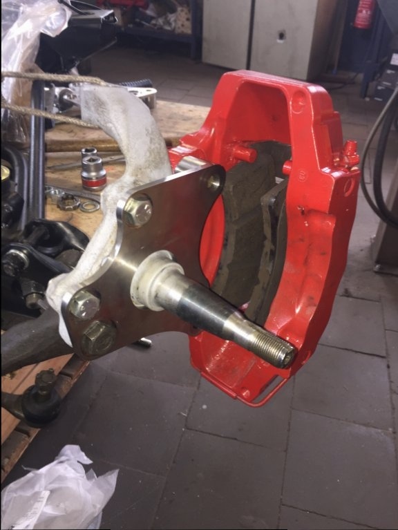

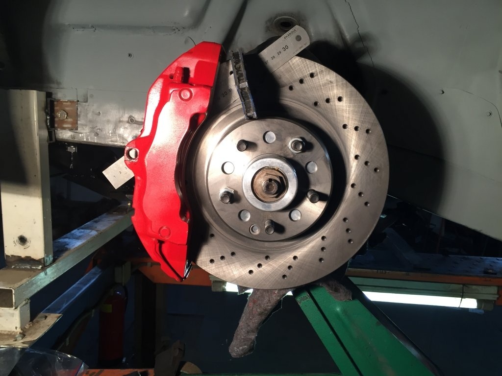

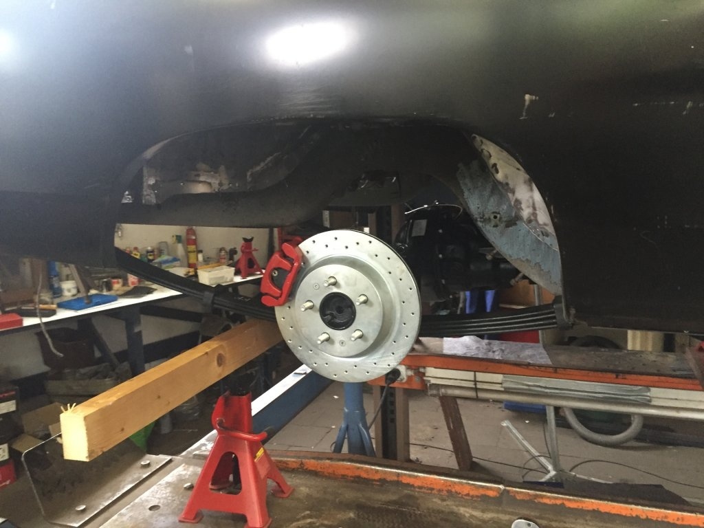

I've ordered my 18x9 and 19x10 wheels at Bonspeed. I'm using Dr. Diff's 13" rotors and hubs up front but with my own Porsche Cayenne 6 piston caliper. Reinforced stock k-member, upper control arms and lower control arms. At the rear I'm using Dr.Diff's 11.7 rotors with Cobra calipers. The has Hotchkis leaf springs at the original location. No mini tube.
Which BS do you guys recommend?
It's for a 70's Satellite.
I want to go 255 on the front and 295 on the rear.

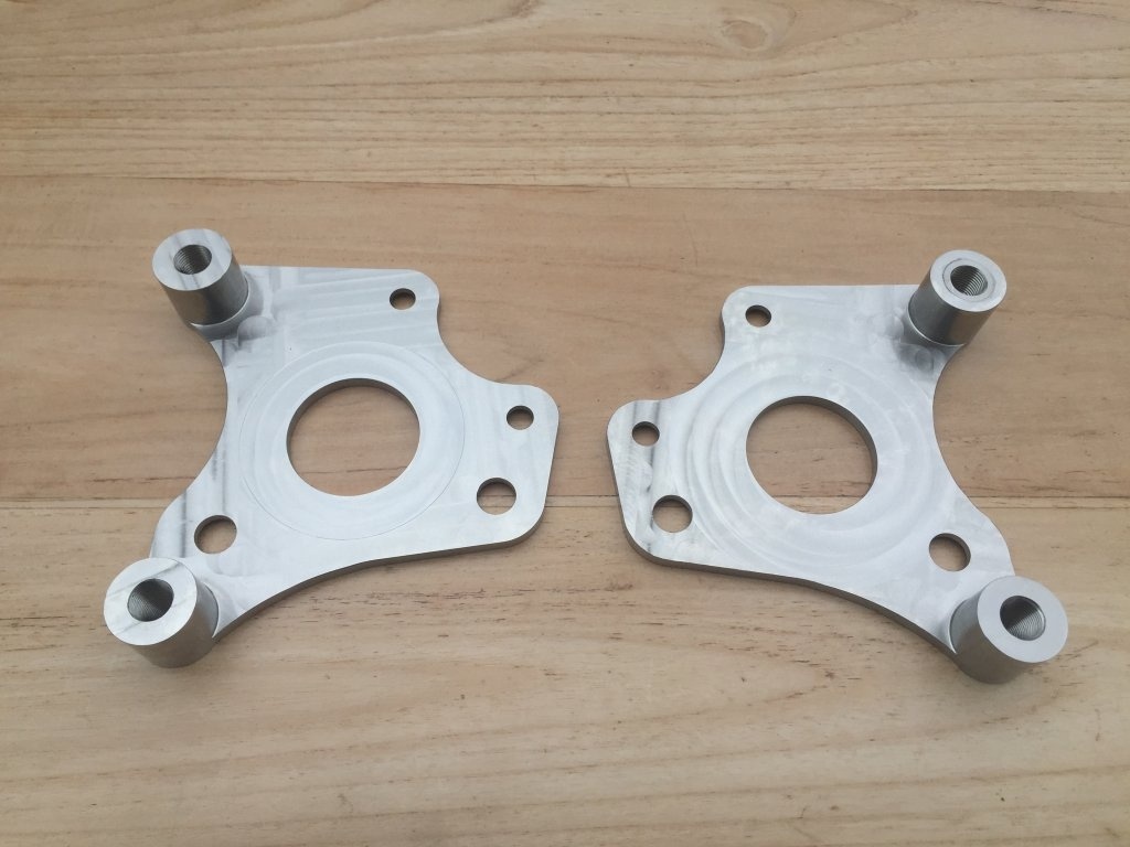

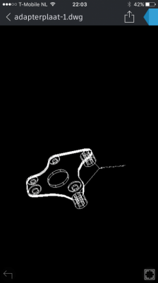

6 piston Porsche calipers ??? I'm guessing that the caliper brackets are NOT a part I can get at Auto Zone!
No. Autocad and Cnc are your best Friend on this one.
Well you might as well be speaking Ukranian because I still don't know what you mean. I don't have contact with any high tech machinists. Who does this stuff?? It does look cool. Complicated, but cool.
