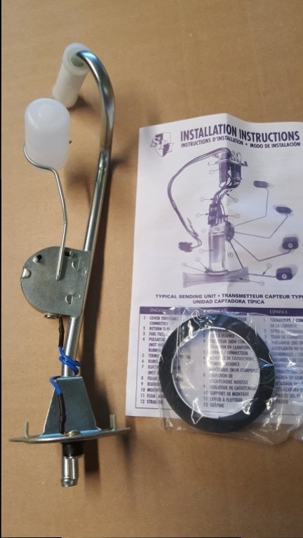

They are made by Spectra. You can see the SPI logo on the instruction manual plus I looked it up. Here's what you get.

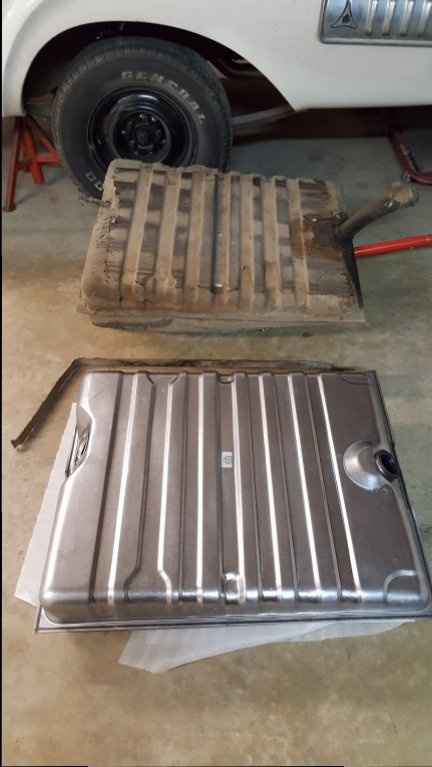

Lol, no didn't need any. Easy job when you figure it out.
First thing you need to do after unbolting the strap, is to hold up on the tank and swing the bolt end toward the drivers side. Then the strap drops out of the slot. The strap being there, won't let the tank come down any farther than halfway.
In the past few years I've purchased 3 Spectra tanks and 3 Quanta sending units. In my opinion the tanks are a quality product, two of the sending units work fine, the third I haven't installed yet. The nipples are shorter than stock, so there isn't much room for the ground straps. The lock rings are pretty flimsy, so you're better off if you can use your original one or an NOS ring.

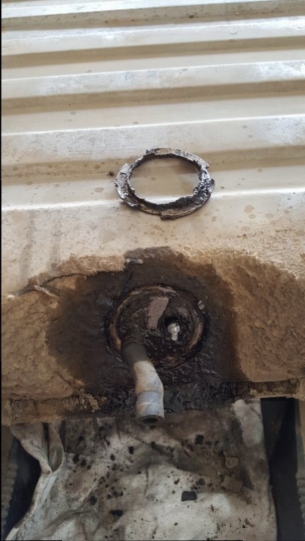

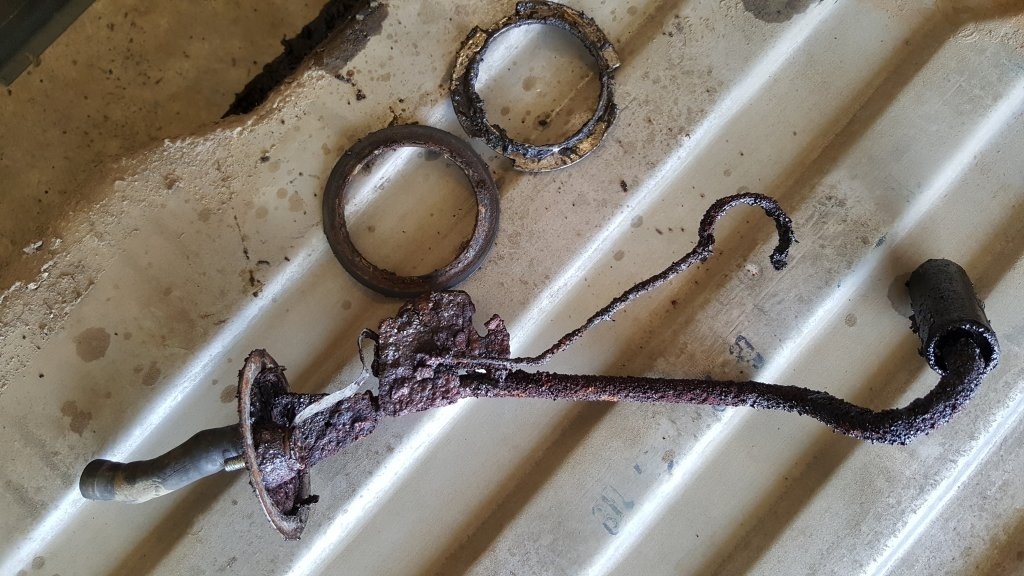

I had to dig out all of the undercoating to save the old ring. It's in good shape and definitely heavier than the aftermarket one.

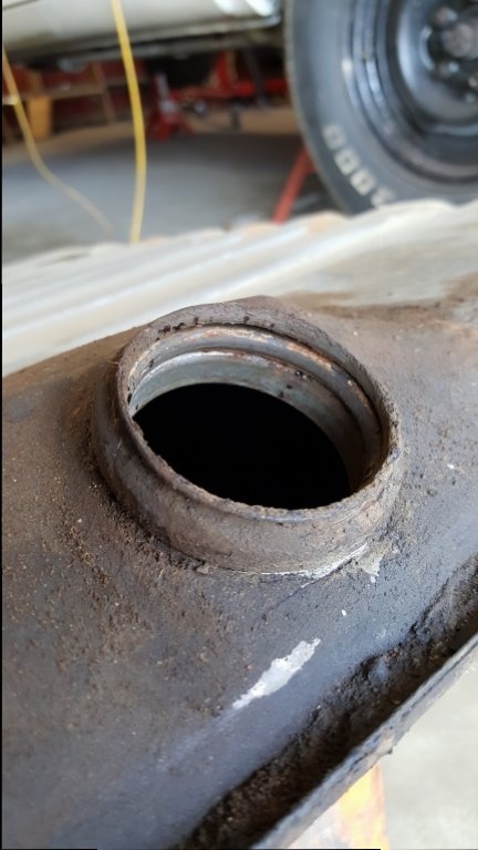

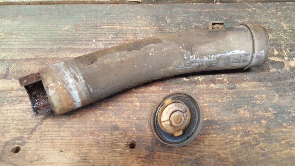

I gave that filler tube about a quarter of a twist and it came right out. It wasn't about to let go while it was in the car. (You can see the original O-ring). Tube is a little crusty. I'm soaking it, might hit it in the blast cabinet or buy a new one.
