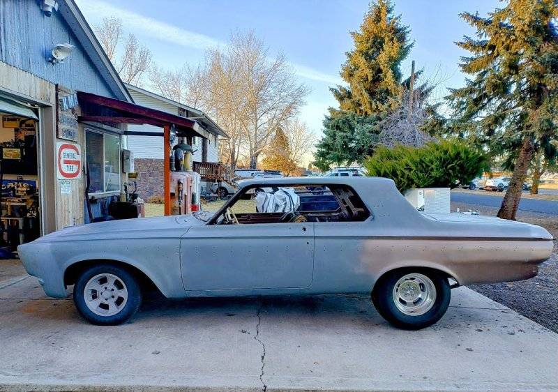

I acquired this '63 Sport Fury from the original owner's daughter last fall and it has been waiting it's turn in line with my other projects. The husband of the the lady that I got it from had it mini tubbed, springs moved inboard, installed subframe connectors and had a narrowed rearend built. The car had also been blasted and the body work done. I've slowly been gathering parts and working on bits and pieces for it over the last year. Here it is as we found it and after we got it out of the container.

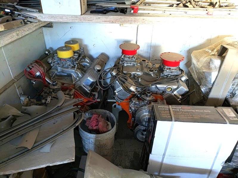

The Mazzolini engines in the front of the container and the paperwork that we found for the one with the crossram.

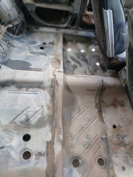

The car spent it's whole life in the Mojave desert, it has no rust. Here are the floors after I cleaned out all the parts and at least 3 cars worth of trim and stainless.

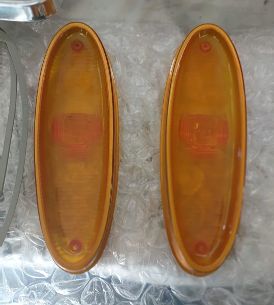

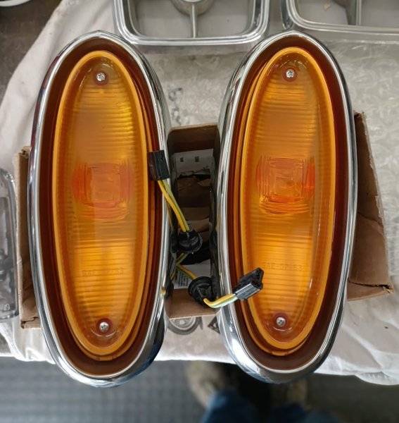

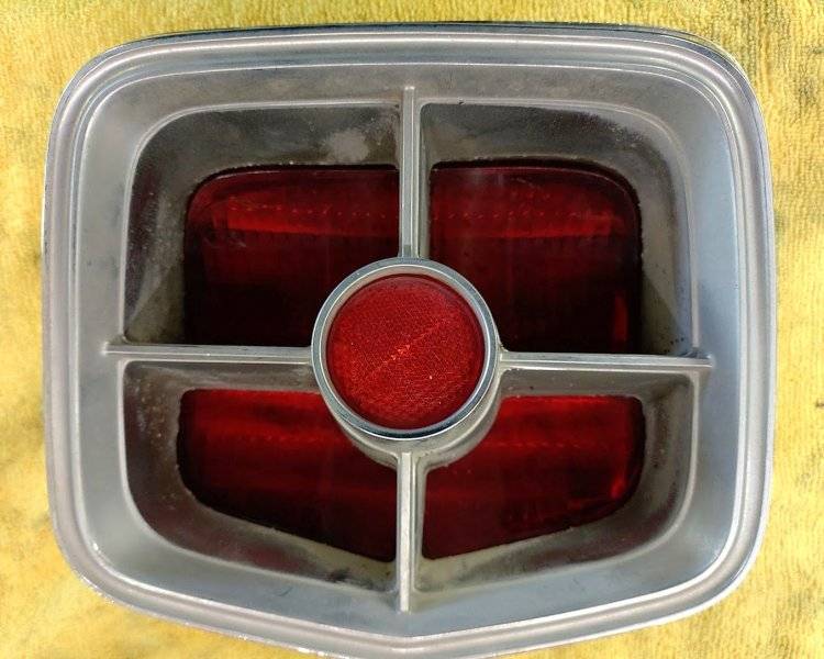

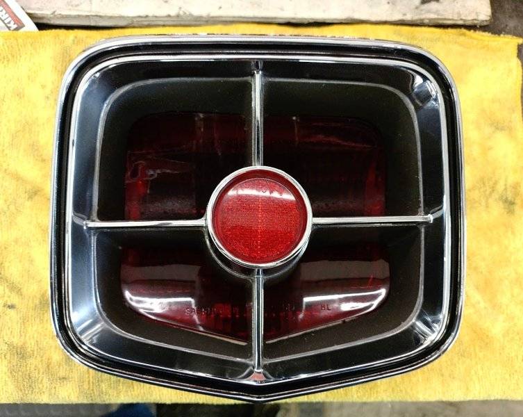

I cleaned and polished the taillights and front turn signals. There was an NOS set of taillight lenses with the car and I found the amber fronts from a parts seller online.
Before
After

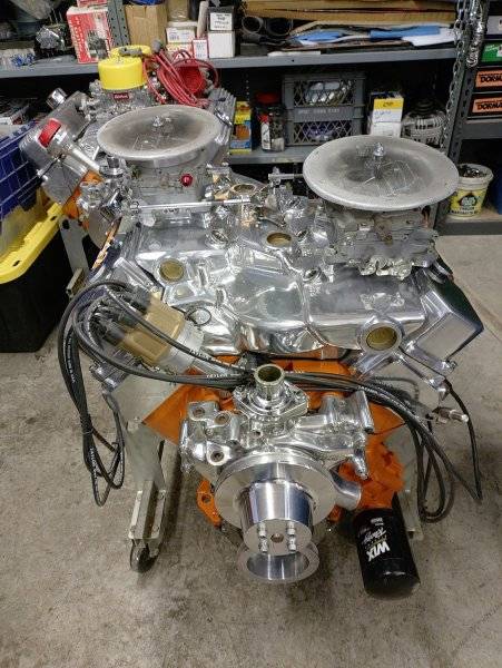

The engine after hours of cleaning and polishing. The billet pulleys and extra long plug wires will be replaced. I have air cleaners and velocity stacks for it.
Good luck with your project. It looks like you have a good start on it. '63 Fury's are great looking cars.
If the c/ram is to be street driven, be prepared for overheating with the underdriven water pump.
Since Geoff mentioned it, those do look like the pullies I took off my wagon. Under driven for sure. Have it corrected now.

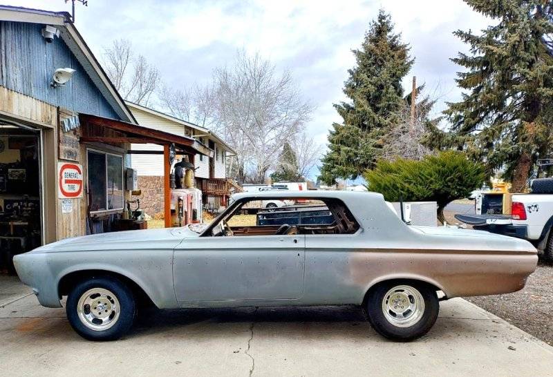

I got the matching front wheels and taller tires mounted this weekend. Taller front tires gave it the stance that I was looking for.
