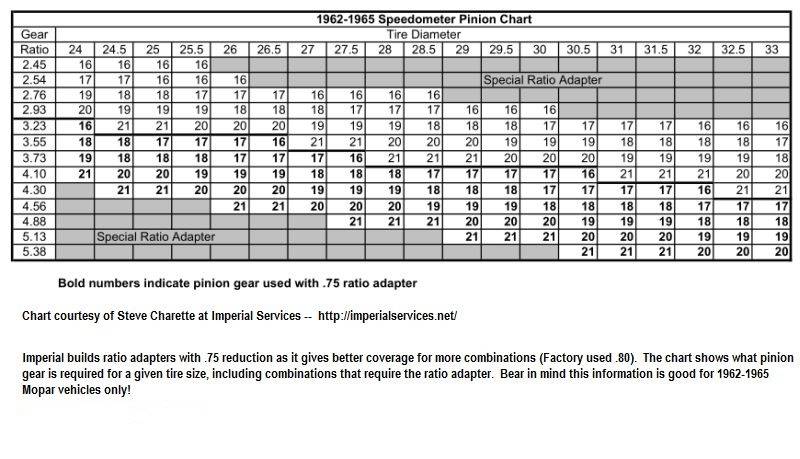

Here are some pictures from Ebay. The bold lettering in the chart requires the adapter.

I see that I am in the bold lettered area, so I would need an adapter. I've been into the early 1962-1966 Plymouth and Dodge vehicles for too many years and I have never had or seen an adapter. Even with the Max Wedge Plymouths that I've had including the two that I have now, not one had or have it. Nor on my 1964 Dodge 440 426 Street Wedge.

i've been up-down and sideways with this thru the years. once you get past a 3.55 gear you have to have the ratio reducer, period!

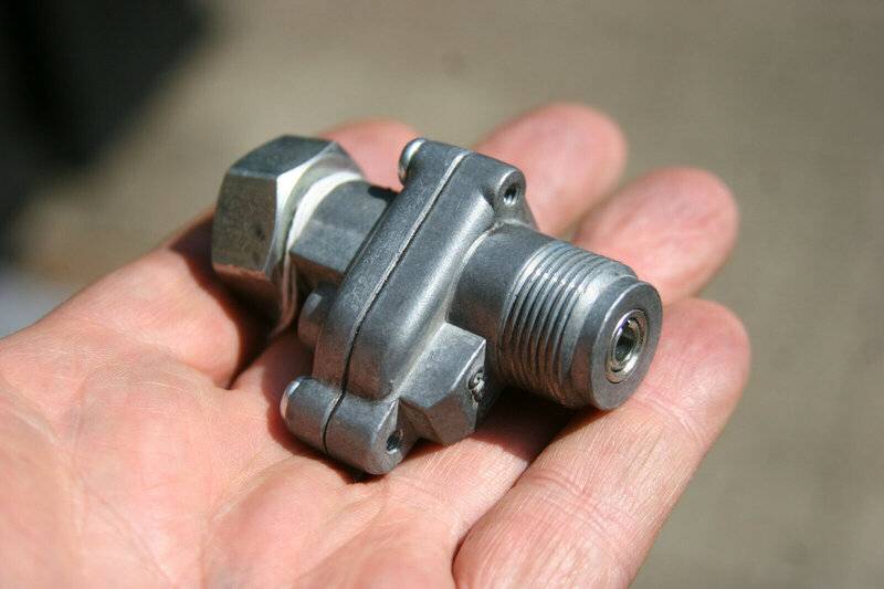

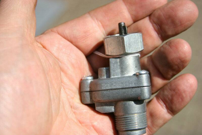

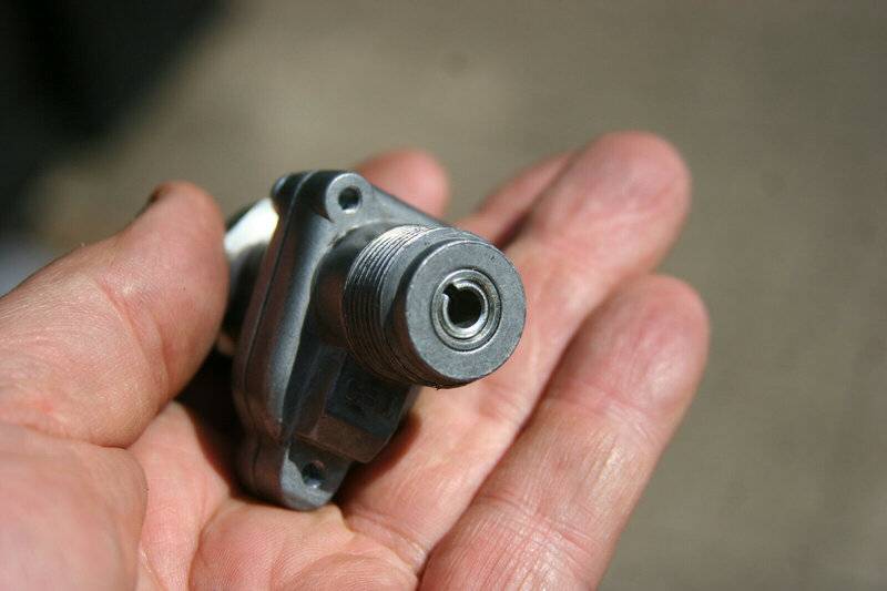

the ratio reducer in the photo is a .90. i got it along with a cable from imperial services years ago. it's my understanding they could have been made with several gear reduction choices; probably 5% increments like the speedo pinions. to the best of my knowledge this is the only type of reducer that will work with the early speedo configuration. it's obvious that an early speedo cable will not work with this reducer. i'm fairly certain a '66 cable came with it. a .90 with a 21 tooth pinion should work with a 3.91 gear.

Yes, that is the style and you also need to change the speedometer cable to a 66. In 66 and maybe 67 Mopar used the screw on ends on both ends of the cable. I got a complete assembly for a 66 Belvedere from Rock Auto for less than $20 if I remember correctly.

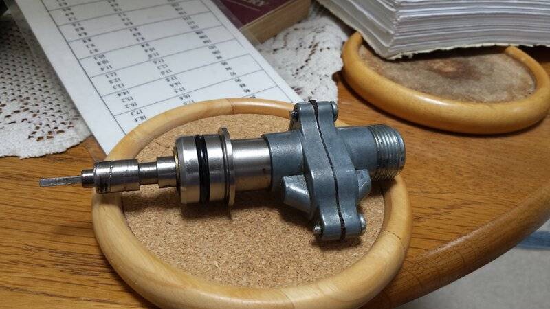

Looking at the photo of the proper reducer I’m betting that with an old speedo cable, a common reducer and some basic machine shop skills these could be combined into an equivalent surrogate. I might even have a speedo cable end kicking around. I’ll take a closer look this afternoon.
