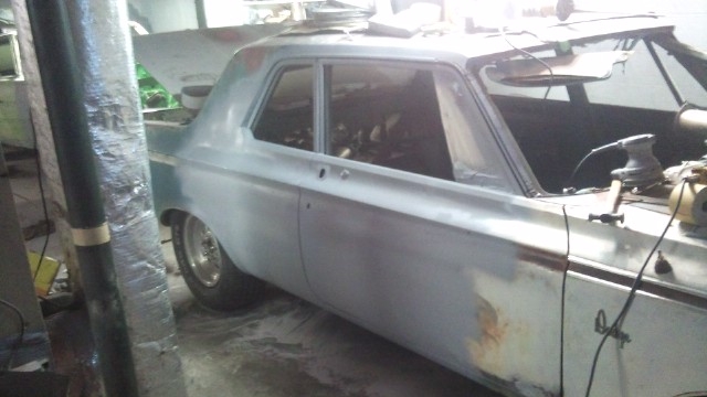

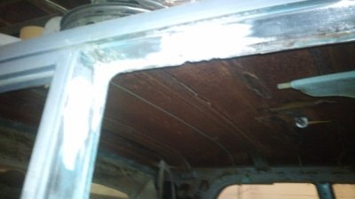

Thanks for the kind and inspiring words guys. One of the valves in my compressor broke off and the the new valve is 7 days out, so I took a .010 feeler gauge and trimmed it down to fit in it's place and it works! hopefully it will last until the new part comes in. But I was able to finish the sanding and get a few coats of primer on it. You can't even tell it used to be a 4 door now.

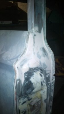

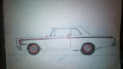

Thanks for all the input guys, and that wagon looks great. I've been working on the door jam area, welding up the holes where the 4 door B pillar was and cleaning things up, I'll post some pics tomorrow. I was looking on google to find a pic of a car that looked like what I want to build and I was unable to find one, I was actually very hard pressed to even find pics of a 2 door sedan in 440 trim. So I decided to draw the car I wan't to build but I ain't no artist lol. But you can get the general idea.
64 440 2-dr sdn

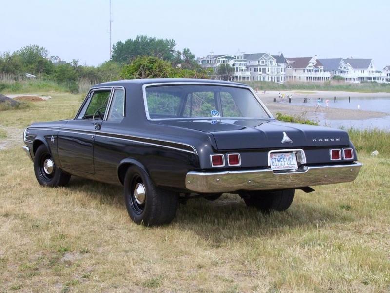

The only pics that I had in my collection.
Jeff

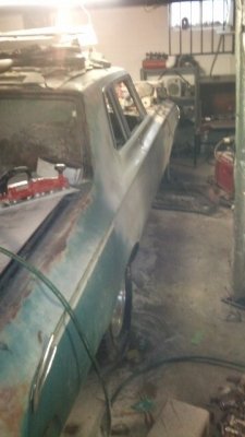

I hoped to have the door jam in primer by tonight, I've got a little more sanding to do and I'll get it in primer tomorrow, it's coming along well.

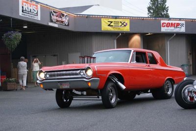

heres a couple of pics for inspiration,about all i could find.youve probably already seen them, but...

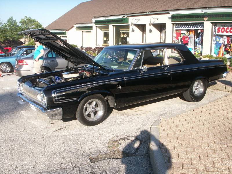

Here's my 64 , 440 2 door sedan. Look's like you're doing a great job with what you're doing to yours.
rear window
You will need to cut out the rear door jamb to accommodate the rear window track, If you want the 1/4 window to go up and own?
I see that you finished it off nicely but you didn't leave room for the rear track.
May be too late now if you welded in the 1/4 rear section.
If you look at a two door, that area is wide open, you can see the whole inside wheel well.
If you didn't do the drivers side yet you will see what I mean.
Steve
