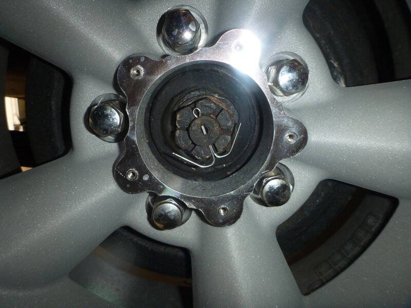

Man this thing's a great cruising boat, nice and quiet on the highway... hands off the wheel at 60mph and she goes straight. Can't hook those Cooper Cobra P275/60's up in the rain though ! Rear wheels should be offset a 1/2" more inboard, as there is a good 1.25" between tire and spring, yet any small bump has the tire rubbing the outer wheel wells side. BFH time...

Wayne, you know that if that has the original rear axle in it, the 64 axle housing is the widest of the early B body axles. The 65s are about an inch and a half narrower, the 62-63 axle is about 2 inches narrower. Swap in an earlier or later axle and you’ve solved the tire rub problem. Years ago, Cragar actually made a special rear wheel for the 64s with a lot of offset.

if you are going to change rear ends, try to go with a '66-'67. They are narrower, plus they get rid of that tapered axle set-up and all the hassles that go with it.

A little disappointed but more motivation to put a non-taper axle rear end in her. Manages to turn BOTH P275's nicely, yet I find it's NOT a sure grip unit, but an open 3.23 rear. Dang..

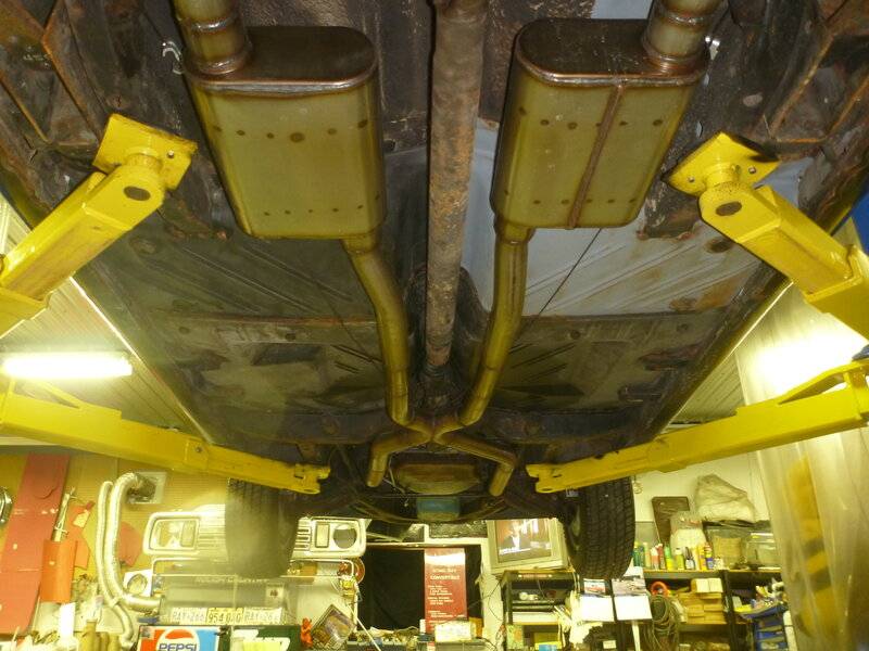

Quick inspection to see what I actually bought.

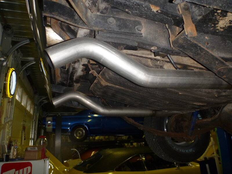

3" stainless tail pipes, probably adds to the quiet with slowed down flow after 2.5" front head pipes.

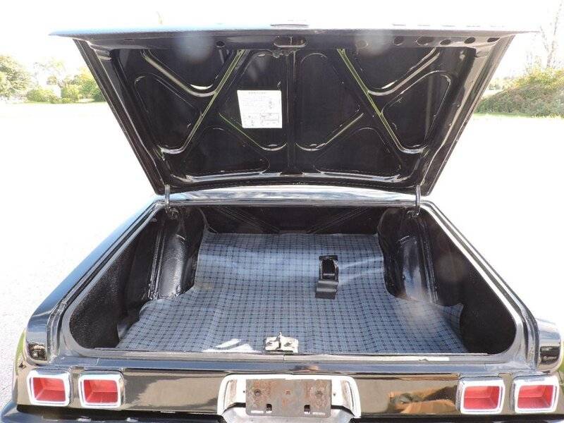

Trunk is solid. Should be gray spackle I believe for '64, but I hate that anyhow. I bought all the jack and tire hold down parts last night on FBBO for 85 bucks.

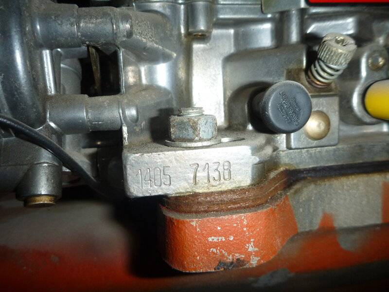

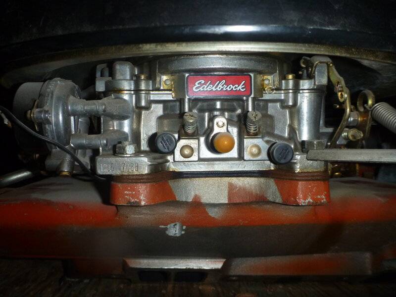

Keeping this in the back of my mind as I go, to turn it into a Max Wedge clone, but that will lead to max wedge exhaust manifolds.. and.. and.. now on to that basement day care centre first.

Trunks were painted as yours is, with the plaid mat.
Really nothing wrong with the tapered axles, drag cars ran them for years without any major problems.
You need the side filler panels for the trunk, they are repopped but easily fabbed out of luan.
The MW setup looks cool under the hood, but there are much better choices, 60 years of technology you know. Not really sure how a MW manifold and 60 year old AFBs with 3:23 gears would work out. Remember that you need heads to match the ports on the manifold.

What the Wife bought me is a step up, I think, from 60 year old AFB's. That said I'm not set on installing it, not to this engine at least which appears to be a 73 block, probably out of a truck.
