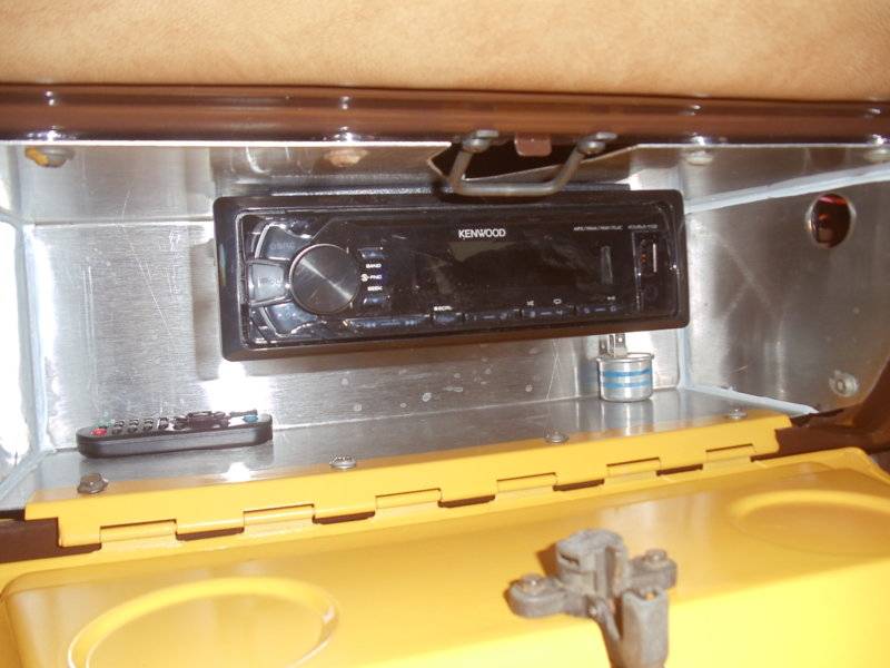

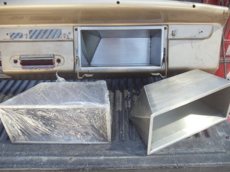

I have mine made from food grade stainless steel at a shop that fabricates restaurant equipment. First foto '72 B Body, second foto '65 A Body. I make sure they fit by drilling the holes myself.

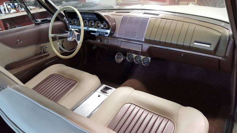

The box in my '62 was very easy to remove and install. Just slipped it through the opening with the door open. Several screws holds it in.
I was thinking about removing my pad to dye it the same color as the rest of the dash. The color I have had a brownish looking color on the pad compared to the rest of the interior color which is a rose color. They are all like this.

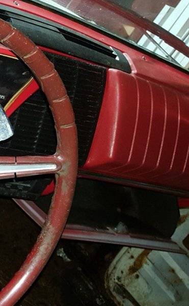

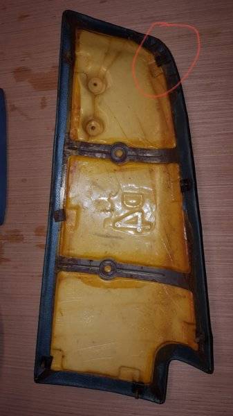

Dash pad, on my 2 door I never would have been able to remove the top right nut without at least unbolting the dash above the pad, and possibly on the right side. It had been removed before when some moron took the dash and pad out, spray painted both, put the pad back on, before the paint dried, and left that top nut off!
There is, iirc, an inward seam right below the bolt which prevents a wrench, and the end of the bolt was up against the firewall, so no socket.
I had better luck with my 4 door, the nut was on, but a little more accessible, and I bent that seam a little, and unbolted the dash as described.
I ultimately took the entire dash out, same day, so I'm dumb.
You have to be a little bit of a contortionist, remove the seat, or remove the dash a little.
Your results may vary, like I said, 2 door no way w/o removing dash, 4 door possible with removing a few dash bolts.
If needed, I can get pics with my pad just set on my dash.

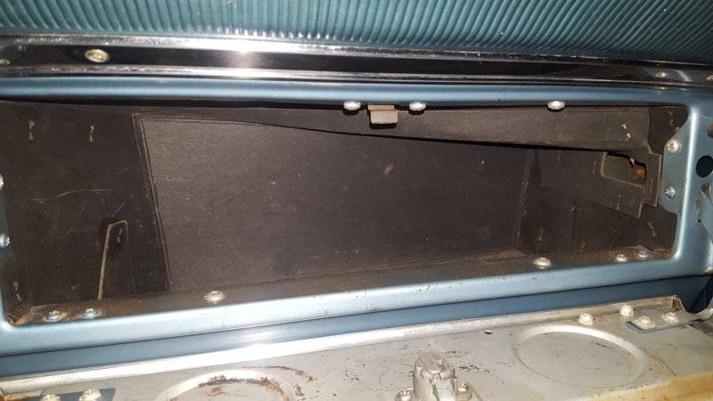

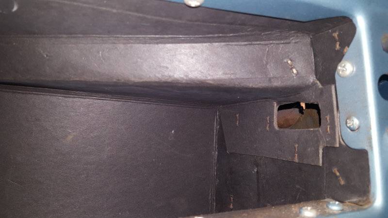

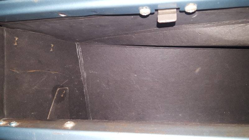

Here's my dirty glovebox. Only pics possible.
I would say original, the car was complete when I got it and the po had it for decades.
Interesting, it looks like the same construction as the repro. But the shape is actually a little different slightly on mine I've noticed. I'll post pics when I get home to show what I'm talking about

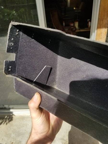

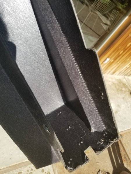

This is the repro. If you notice one part inside isn't stapled when it should be and then it leaves an odd flap. Also the shape in the top right corner is off and doesn't dip down as low as the original. The diagonal curve isn't steep enough. That's also the part that rubs on the body and needs to be massaged into place and you have to sort of bend up the box in doing so. And then you do all that only to realize you need to take it back out to put another hole in the proper place for the screw on the right side. I'll make it work for now but I'm going to try to make my own at some point.
