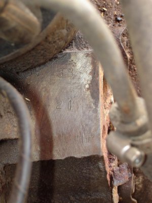

DSC02747.jpgI had a 64 Ply cop car, 2dr sedan with 383HP and column shift 3spd stick
As Far As Police Applications Go For The '64 Model Enforcers, These Chryslers, Dodges And Plymouths Ran Two Versions Of The 413 Motor. A 340 And 360 Horse 413! No 426 Wedges Were Used In Police Applications!
I have an article that shows the 413 police pursuit in a Dodge 880
Does anyone know if these police engines had a decal on the valve covers?................................MO
Look behind the starter to look for a DATE (YEAR)...& that can help....you might have a 413 out of a...300C car (plumbers delight) 2x 4BBL.....also HP on the front" porch"next look at ----->BUL1!TT picture. :happy11:
sonny has a # matching car from the bell housing back just the( short block is not correct )
heads & etc are. (block crack)
no I believe a 413 did not come in a 64, B Body...361, 426, 383, 318 p, slant6, 426hemi (race).
