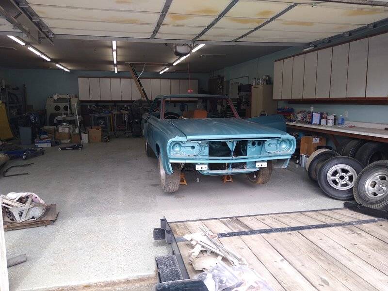

I aquired a 65 Coronet 500 for my next build. This will be my 1st b body. I know I'll be calling on help with knowledge from people. Will try to post pics on the build. I get in too much hurry and no post pictures. Car will be turquoise.a pretty color.

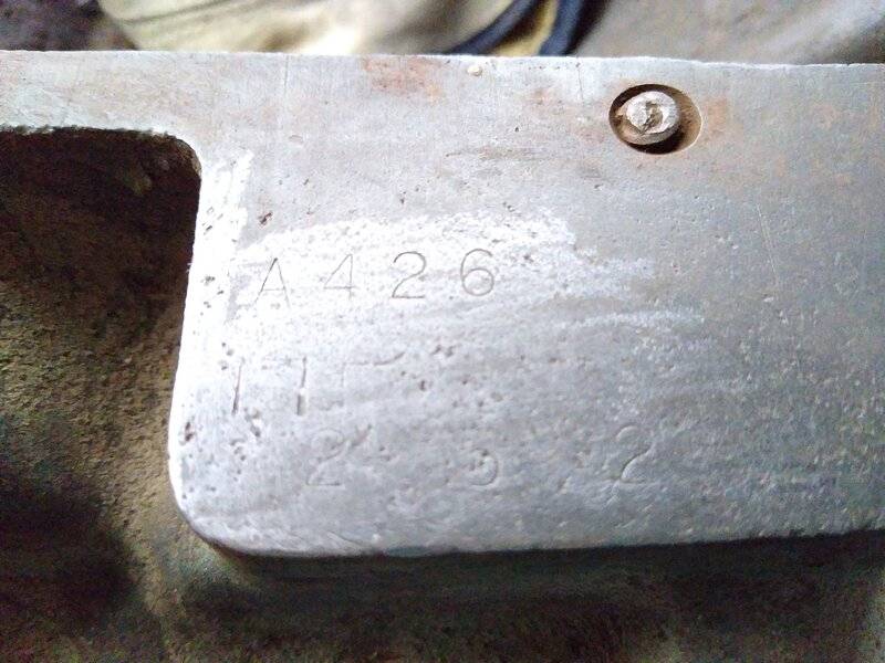

426 wedge original motor/transmission/rearend.
The completed photo is what I want to end up with

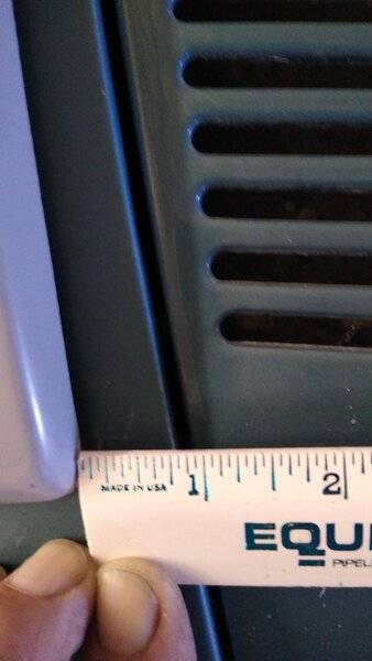

Jim914, Can you give me the measurement of the back edge of the hood to the back edge of your hood scoop? Getting ready to install mine on my 65 440 Coronet

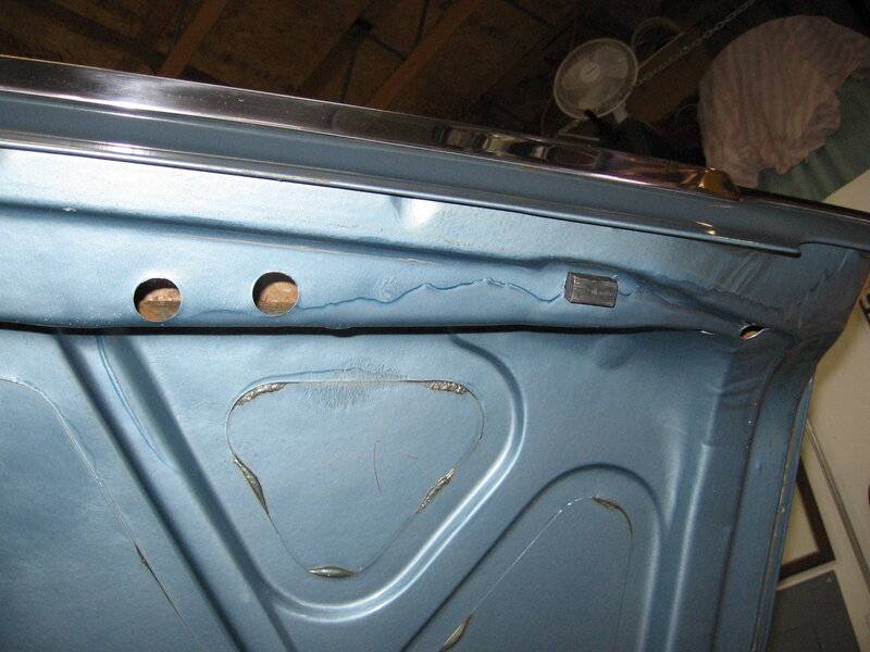

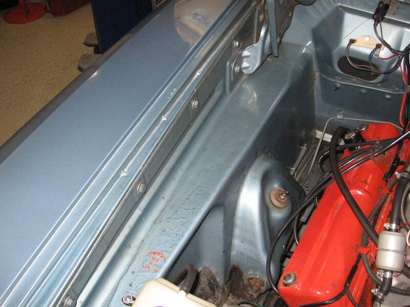

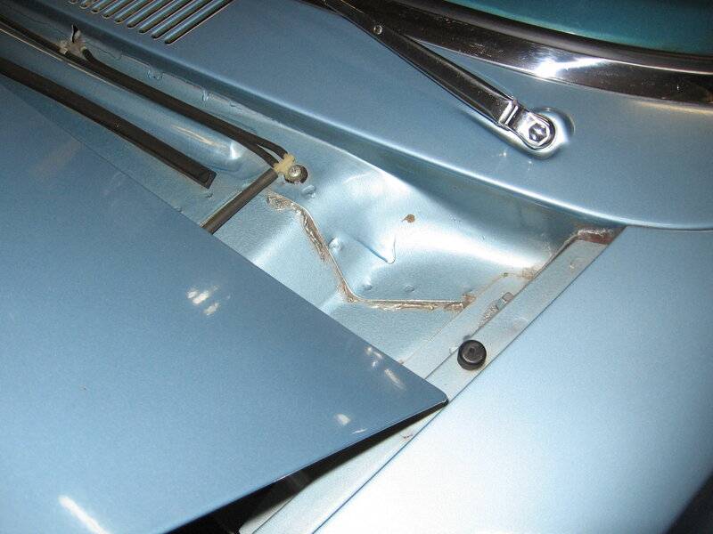

Here are photos of my 64.Also the same.Body, under hood, door jams,trunk. 12,000 mile survivor.
I took these for a guy that wanted to do a 100% resto and was looking for drips and runs.My car had lots of them.Thin paint too.

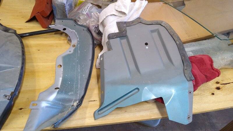

We're these front fender shields in place when the cars were painted at the factory?
Just trying to do it right.
Thanks
