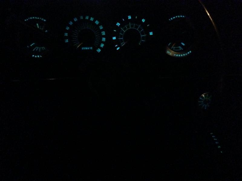

Yep, there are signs of life, that's good. Might be as easy as cleaning some grounds. Like Bob said the dash light problem could be the switch. The number for a BWD switch is S426, should be under $20.

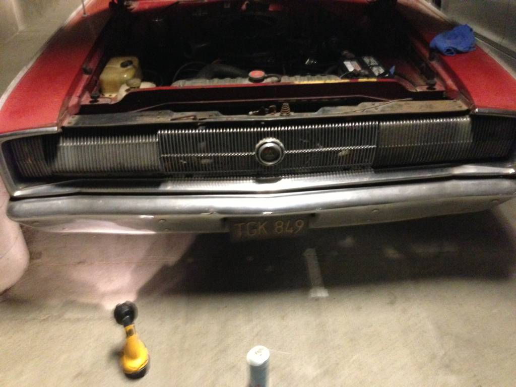

My car has one headlight that hangs up once and a while, will stay shut while the other opens. If I give it a rap it works again for a while. My guess there is a connection in the motor that is bad. I have another motor to swap out.
