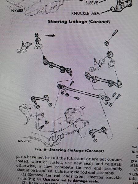

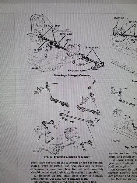

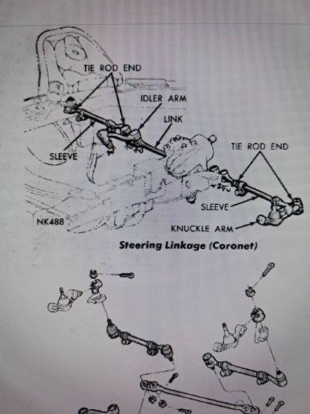

My 1966 Coronet's k-frame takes the idler arm on the right in Mark's post below. I've had several members tell me that's wrong for 1966, but correct for 1968 and 1969. Also, I posted pics from my 1966 Factory Shop Manual below, which show the earlier style idler on left and in center of Mark's post. Are you sure your original K-frame for 1966 takes the idler arm on the right?

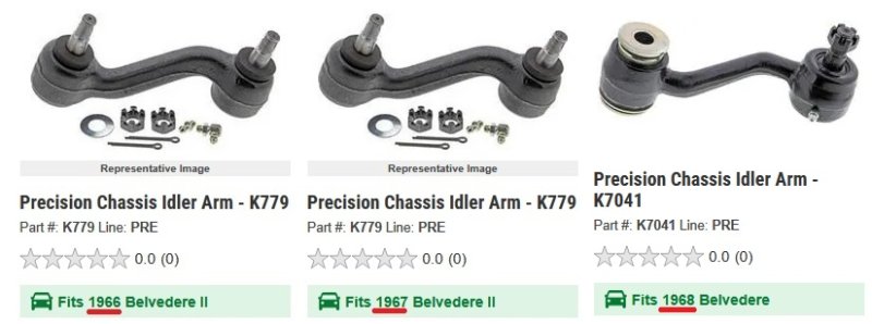

I'm too lazy to wait for three separate 100+meg part catalog PDFs to open, so went to O'Reillys to lift pics. I've also learned to never say never, so...
But I believe this is how they were.

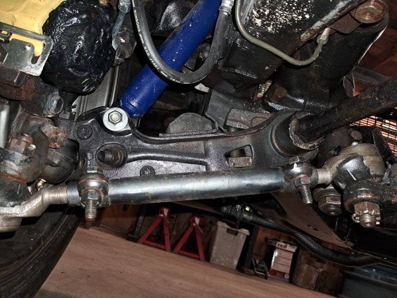

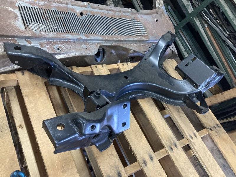

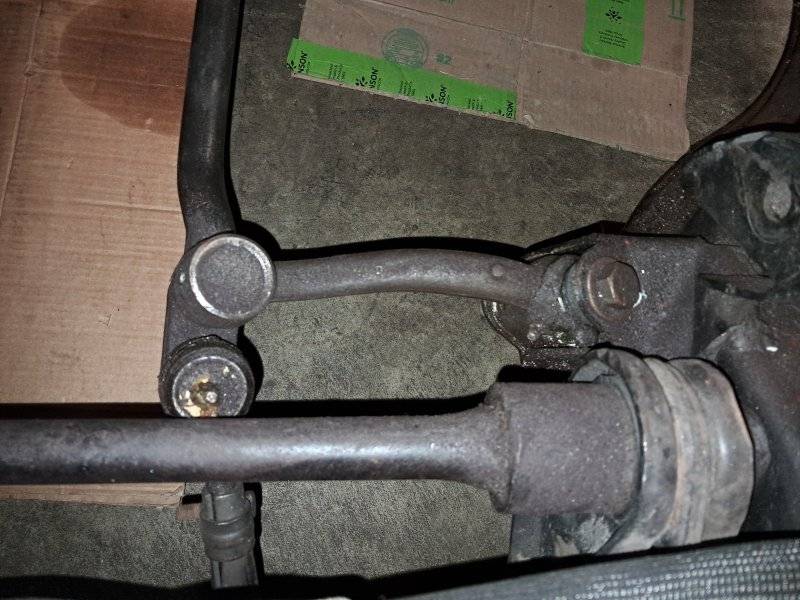

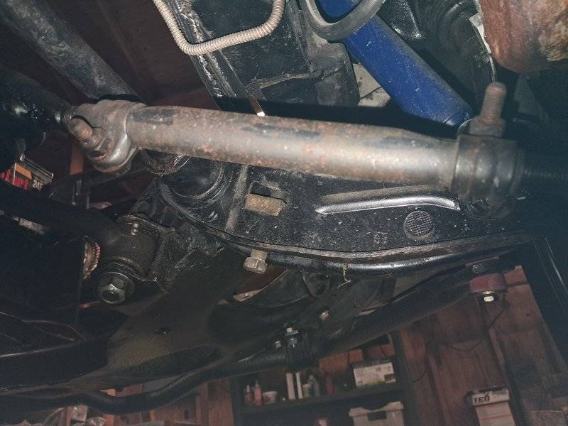

My 1966 Coronet's idler arm mount. Completely different from FSM pics below. @RemCharger @MarkLevi and others are right about my K-frame being replaced. My car came from Georgia where older cars can be sold on Bill of Sale without title. Georgia DMV has no record of my car ever having a Georgia title. Maybe a slant 6 k-frame was in it and the car was VIN swapped. VIN engine code is D for 318 Poly. 1968 K-frame could have been added to match the swapped VIN. Who knows?

I missed the idler arm mount in the photos. You are correct.

I used FSM downloaded from www.mymopar.com to post pics in post 21 above.
FBBO member told me that I have a later K-frame in my 1966 Coronet, which has complicated matters and delayed the parts purchasing process, while I and other members did research to figure out that my k-frame is 1968-early 1969.
