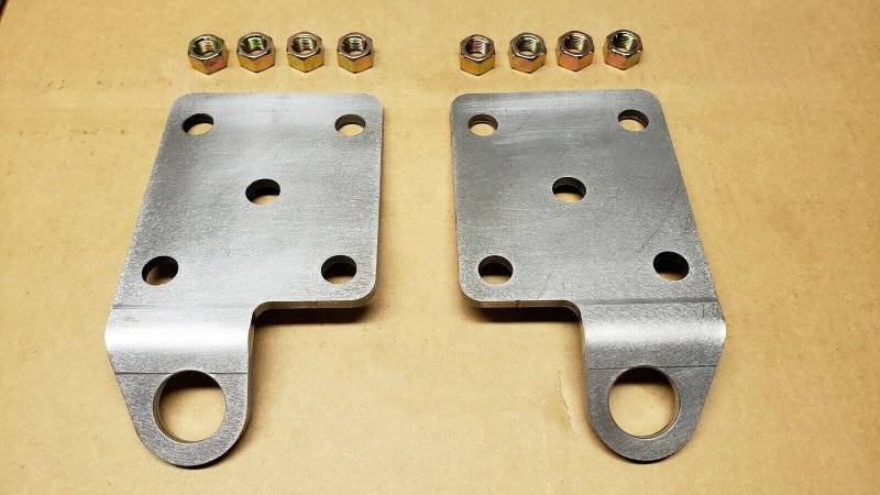

Those work real nice if you have leaf springs.

Calvert makes back hanger like those for Leaf Spring cars that work
great and affordable!

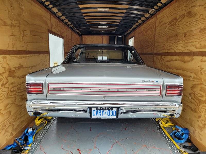

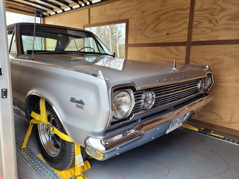

34 years of lashing cars down with nothing but a strap around each tire with ZERO issues and for many years on my open deck 34' it was just that, a 10,000lb 2" ratchet strap centre of the tread. I use tire "bridles" now and for long hauls I add 2 panic stop straps to the rear axle.View attachment 1723644View attachment 1723645
I have been using this exact method to tie down my 68 Road Runner when traveling to out of town shows. It's the only way to completely eliminate contact between the straps and paint on any underbody parts.
