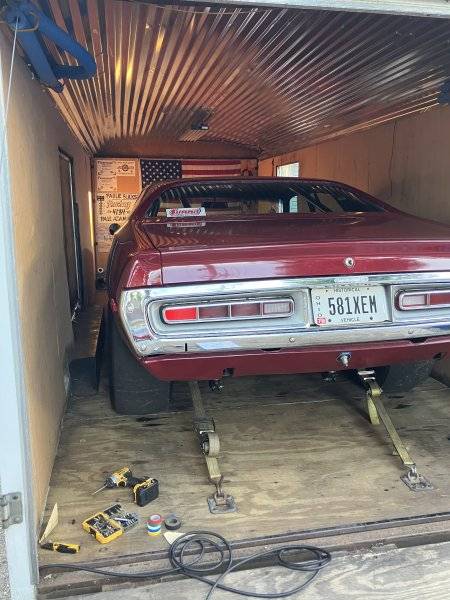

Totally agree. On a street car, I secure the unsprung weight so that the cars' chassis isn't in any sort of bind.
Not sure I understand all the logic here. Not sure what real "bind" exists here when securing the sprung weight, the car's springs already carry the cars full weight, and nobody I believe is pulling the suspension all the way down tight against the suspension stops. What "bind"?I'll add... if you're hauling a race car some guys like to make the car and trailer one so they're not cycling their shocks. A street car, I like the suspension of the car to be able to do it's thing. First time I didn't the plates went together in the battery from hammering down the road.

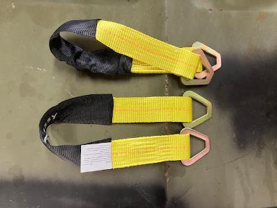

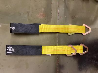

The X pattern might make sense to some people until you think about what happens if one strap comes loose. NOW the car want to move to the side still connected. Numerous videos online show what happens when a criss-cross attachment fails and it isn't good.I grab the rear axle housing with an X pattern. E strip on the front, over the tires, that way the cars suspension can do it's thing. Dadsbee has it right.

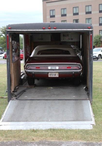

I've been using a 3500 lb winch since the late 70's and still using it without any problems. It didn't like pulling a 69 road runner with 2 flats on the same side of the car though but with the help of a buddy giving it a push once it was on the ramp, it went on the trailer. But, you can double the pulling power of what you have with a simple snatch block pulley. The down side is that will reduce the pulling speed by 1/2....Tire straps look great but I don’t have the grated tracks in my trailer floor to facilitate using them. There isn’t a lot of breathing room between the side of the trailer and a loaded Challenger to work with to try to install the tire type straps even if I had the grated track. The Magnum has a little more girth than a Challenger too!
I have 2 foldable eyelets in the front of the trailer and 2 toward the back to attach the hooks on my ratchet straps to.

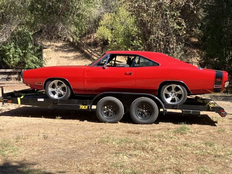

Be packing up Wednesday so no time to make a project out of modifications to the car or trailer to tie down now. I just need safe spots to tie it down as it exists now.
The car got delivered to me in a 24’ enclosed so I know it’s doable! The specs for Magnums show them to be 1" wider than a Challenger, and that spec undoubtedly doesn't include the factory fender flares. I am not looking forward to threading the needle getting the car in and out. The previous owner of the trailer installed a winch in it, but I bought the trailer from his estate, therefore he wasn't around to give me any lessons on how it works. It's a 3500 lb winch which I've been told is marginal for the job, so I had in mind maybe getting a 5000lb winch, which of course I never got around to.

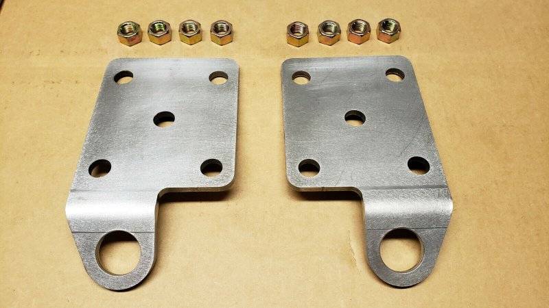

I really like the lower shock plate brackets on the rear.
And not having to deal with the axle straps back there makes it nice
I used a 'J' hook like the wreckers use on the front end....hooked it to the back side of the K member. Just had to make sure it wasn't going to come in contact with the oil pan. My race car had a couple of 'eyes' welded to the front side of the K member.Transporter us "J" hooks into holes in the frame.

The effective simple laser cut steel eye attachment that mounts to the four-leaf spring U bolts on the rear axle, could easily be cut from Ti, but I can't seem to inspire the seller to offer that option.I see a lot of guys with rings welded on. Extra weight! The horror!

The 4 strap Fore/aft is safer.
I use straps like these over the control arms and the axle housing:
The suspension can move, the car can bounce. I'm no expert but this has worked for me.
