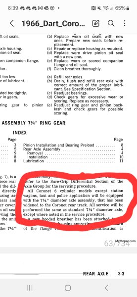

From the 66 Dodge FSM. Of course with Ma Mopar there are exceptions to every rule
