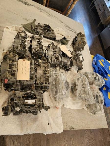

A friend of mine has spare hemi carbs.
Ive actually toyed with the idea to pick up a spare set and have them gone thru by someone with a little more knowledge than me

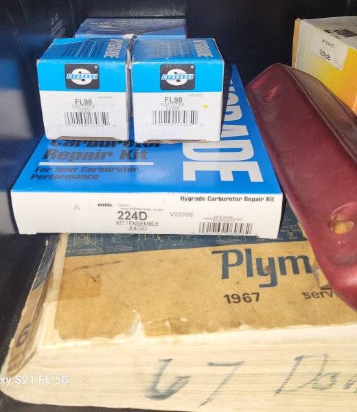

What gasket kit part # are you using--Thanks
Kit and float
