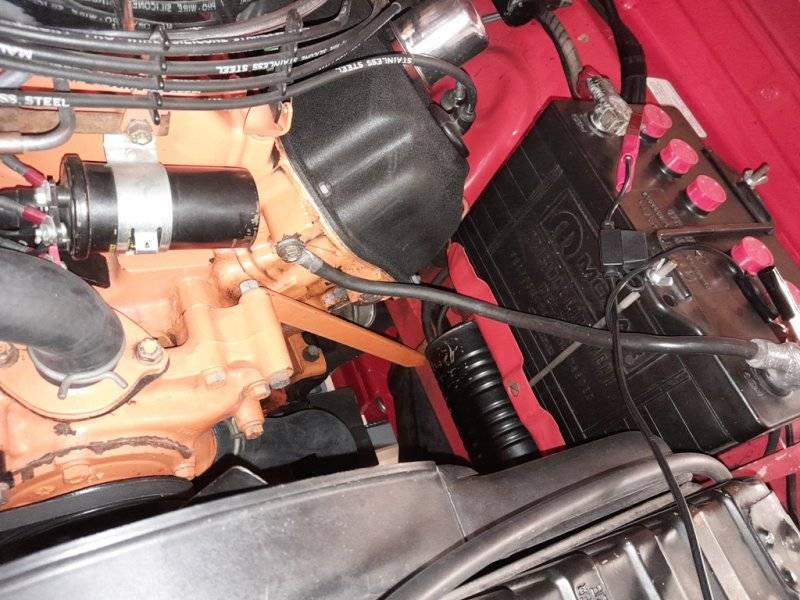

Wayne, I "created" a torque strap for my Hemi 4spd car years ago (non power steering). Been working great for 40 years. Used to tell people it was the "rare optional for station wagons" factory piece. I can get photos for you if interested.
Are you attached at the engine mount bolts or to the unused "power steering" hole in the water pump housing casting??
are you talking torque strap for engine lockdown in case of mount failure!
To the PS mount and a hole in the frame rail underneath the battery tray. Back when I made this it was solely for safety in case of a broken motor mount. Original appearance was not as critical 40 years ago as it is now. I believe the attach point on the frame horn was already there? An added benefit is it keeps the drive train more stable during shifting, which leads to better shifting! I made a couple more of these back in the day to help out with shifting issues on friends 4 spd. cars. One of them being an A12 Roadrunner. I wasn't in the shop yesterday and my car is on the top position in storage, but I will try to get you a photo today.

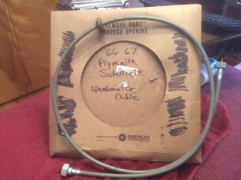

Thanks. Confirmed with RC that hex on both ends the transmission end was correct vs the knurled round ends I took out. Cable was JUST long enough and confirms why the FSM says to disconnect it at the transmission before pulling the instrument cluster forward!

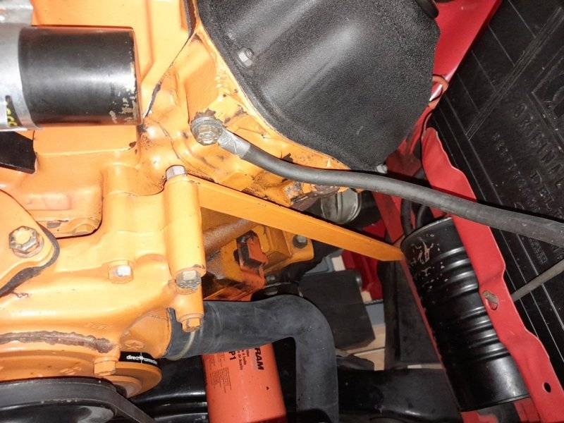

Some above and below shots of the OEM (Owner Engineered & Manufactured) torque strap.
The dog leg at the lower end was to clear the vacuum reservoir on a Charger. I fabbed at least 3 of these back in the day. They worked great and are cheap to make. 1" x 1/4" flat bar.
Actually, while mine has the hex end on the transmission, it has a knurled end on the speedometer.
Interesting. The one I took out, that was run through the wrong hole, was knurled on both ends. The repro I put in was hex on both ends like the NOS Fran shows.

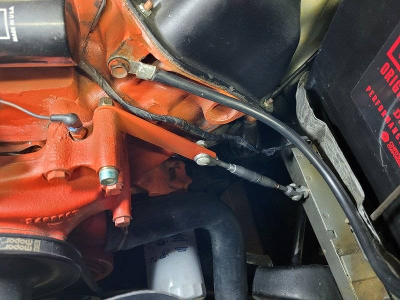

Schumacher hasn't made these in awhile but I did happen to find one on fleabay. It was for an E body but I actually liked the bracket better. Used a longer motor mount bolt with a bushing to space it out. Compact, looks cleaner and no vibration felt using the rubber isolators.
When you look a little harder and the "65" clamp on style sway bar being removed becomes a tad more obvious!

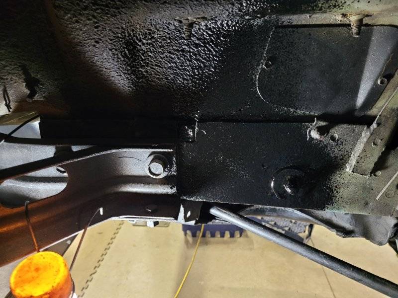

Gave thoughts to the many ways to skin the cat, but in the end just decided to use the existing transport tie down hole to drill though and out the other side, It's right in line with were I want the strap. Nice thing is, the frame rail is reinforced here to handle the transport chain hook loads. Also note the K frame splash shield is missing, but someone was nice enough to put the mounting bolts back in the rail!
