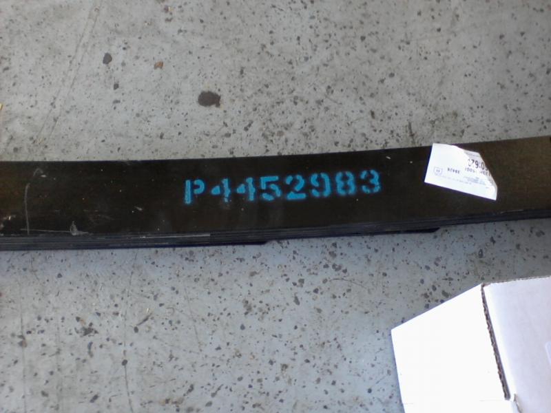

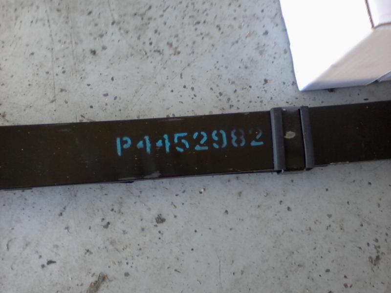

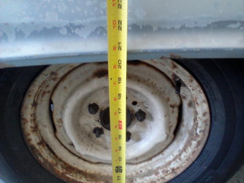

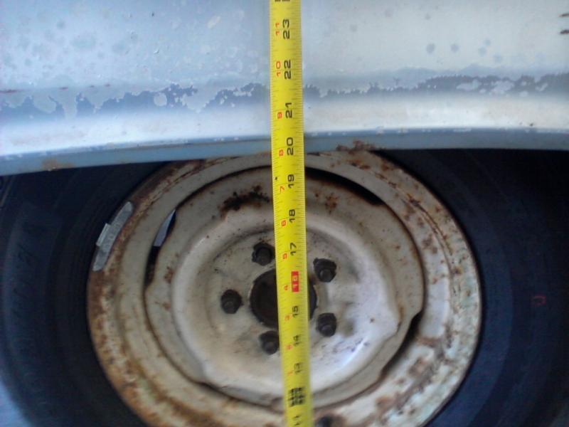

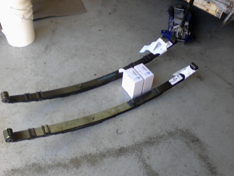

I accumulated some more parts for the ole Sat'. I decided to go with XHD springs since it will be mostly street driven with few trips to the track. Items purchased that I am waiting to receive: Rancho RS9000 shocks (99116), AR095 Front Hangers, AR107 reinforcement plates, and ADDCO 675 7/8" rear sway bar. I measured the ride height before removing the old springs. It was 19 3/4 inches in case it is hard to see in the photo. height before.jpgnew parts waiting for install.jpg982 spring.jpg983 spring.jpgNew shackles.jpgSat rearend out.jpg

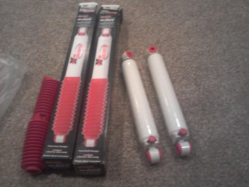

Got home yesterday afternoon with a package waiting at the door. The Rancho RS99116 shocks came in. I bought these off Ebay for $50.00 each with $20.00 shipping. The guy still has two more if anyone is looking for a good 9-way adjustable drag shock. They were brand new and the boxes had never been opened, wow. I am just waiting on the front hangers, u-bolts, and reinforcement plates to come in. I guess I will break out the ole POR 15 and get busy on the undercarriage until then.

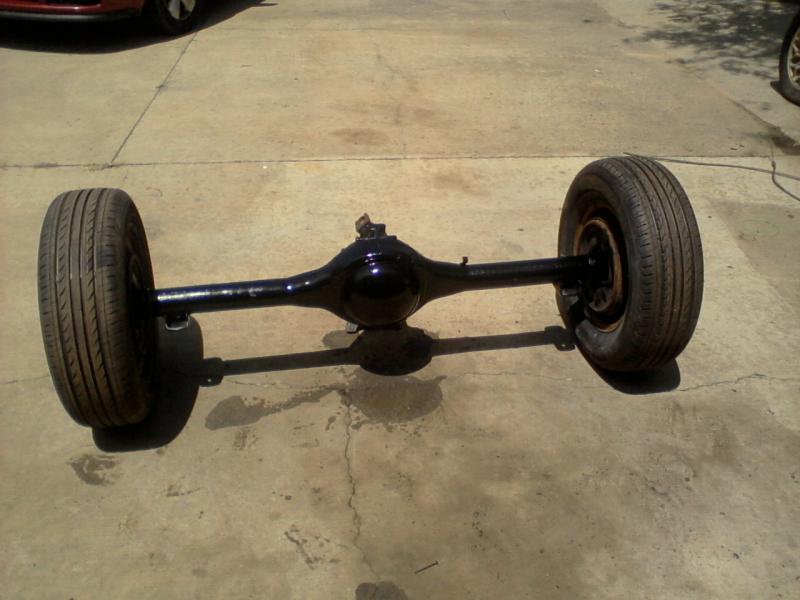

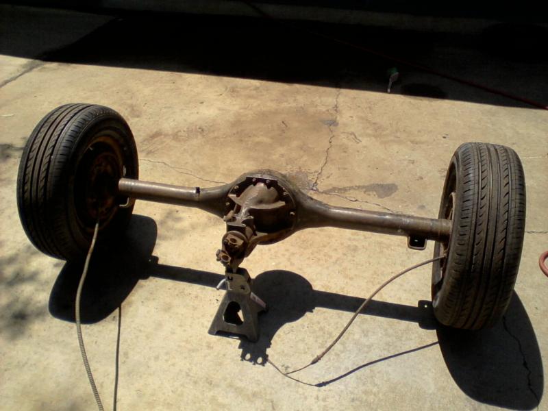

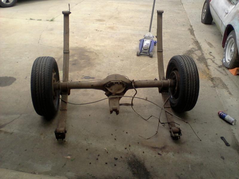

Over the weekend I had some time I could devote to the ole 66'. I pressure washed and cleaned up the rearend in preparation for paint and reassembly.rearend cleanup.jpgrearend painted.jpg

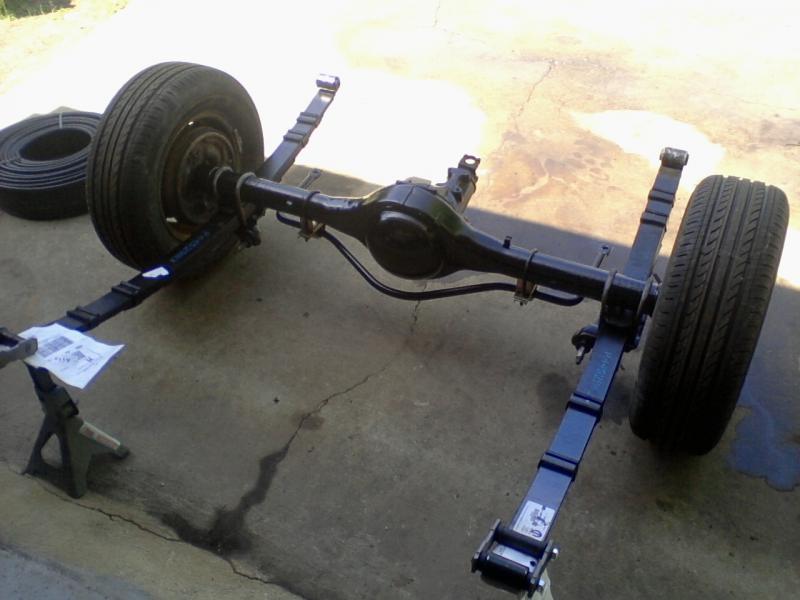

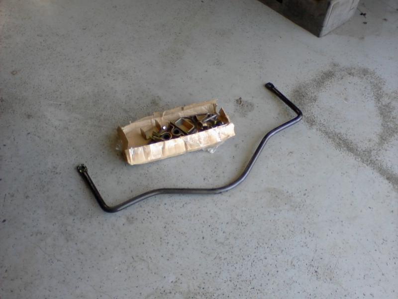

I went ahead and preassembled the entire rearend. That included the installation of the ADDCO 7/8" sway bar.

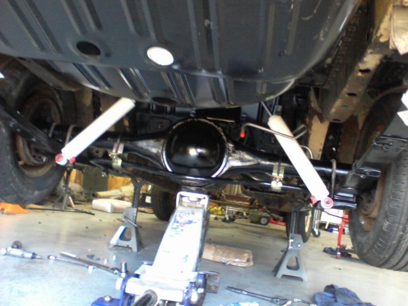

Even though my AR Engineering front hangers have not come in I went ahead and mocked up the rearend with the old ones. I did the mock up to find the placement of the sway bar end link brackets that mount to the frame rails. Oh, by the way the new components did raise the ride height by a little over a half inch.rearend installed.jpgride height afterwards.jpg

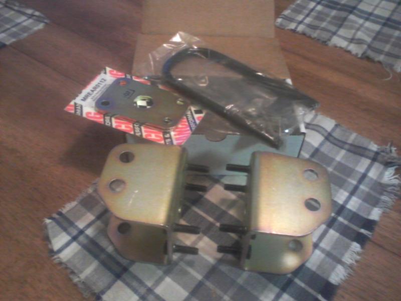

So I am currently waiting on Mancini Racing to send the following components: AR Engineering front hangers & reinforcement plates, u-bolts, new front hanger nuts, 2 degree shims, and an adjustable pinion snubber. I am hoping all the needed parts come in this week so I can get started on something else.
The ups truck showed up yesterday with a few more parts. One more shipment should be coming by the end of the week with the remaining parts to complete the rearend installation.

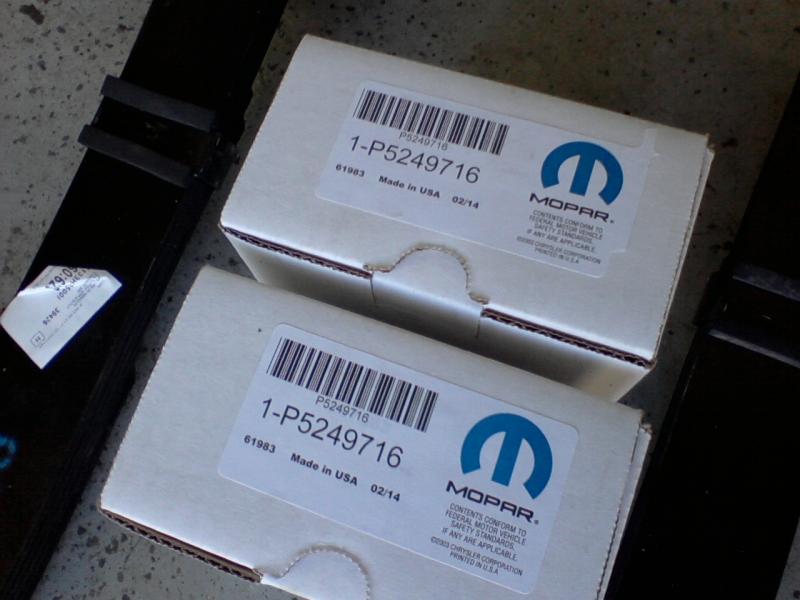

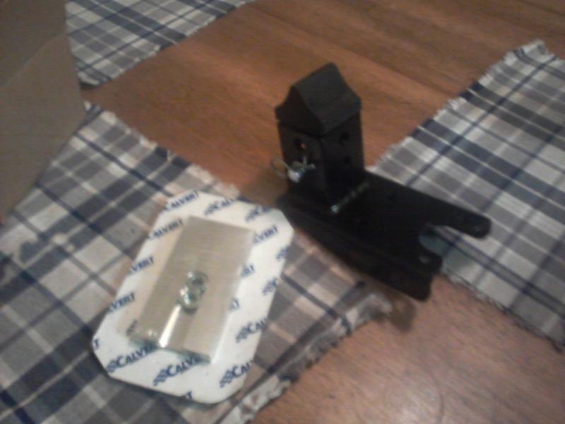

The UPS man brought the last of the Mancini Racing parts needed to complete the rear suspension upgrade. Yep, the adjustable pinion snubber and some 2 degree shims ought to help planting those meats to the pavement. I hope to complete the install this weekend. I will have to work around travel soccer and travel baseball tourneys though.Adjustable pinion snubber.jpg

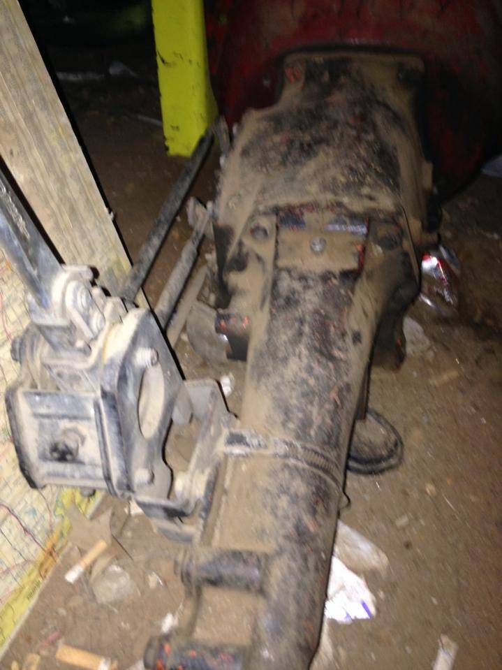

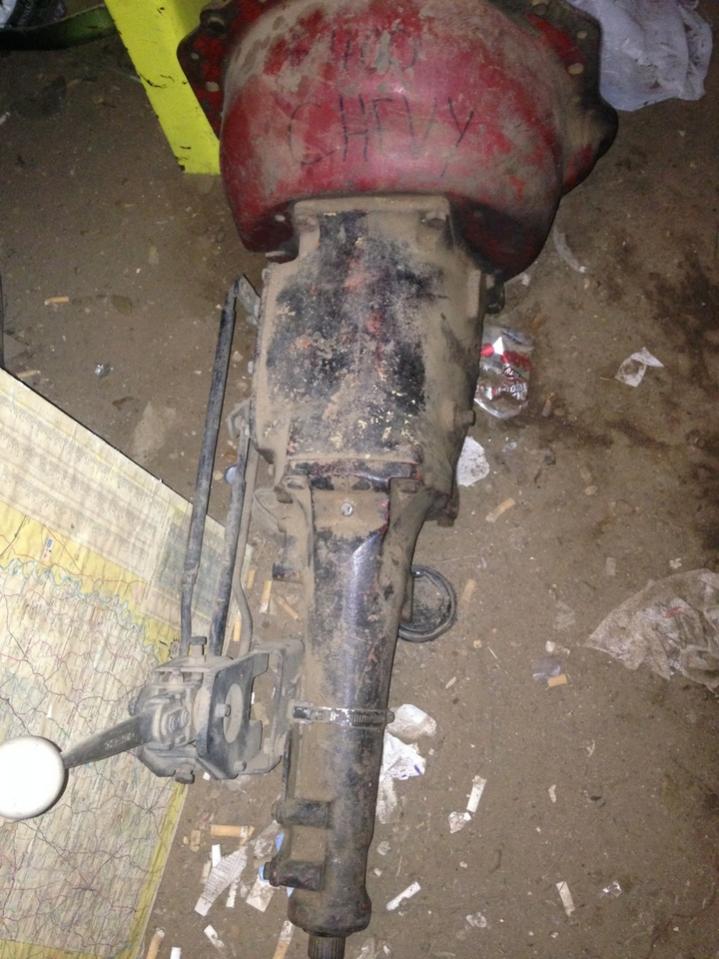

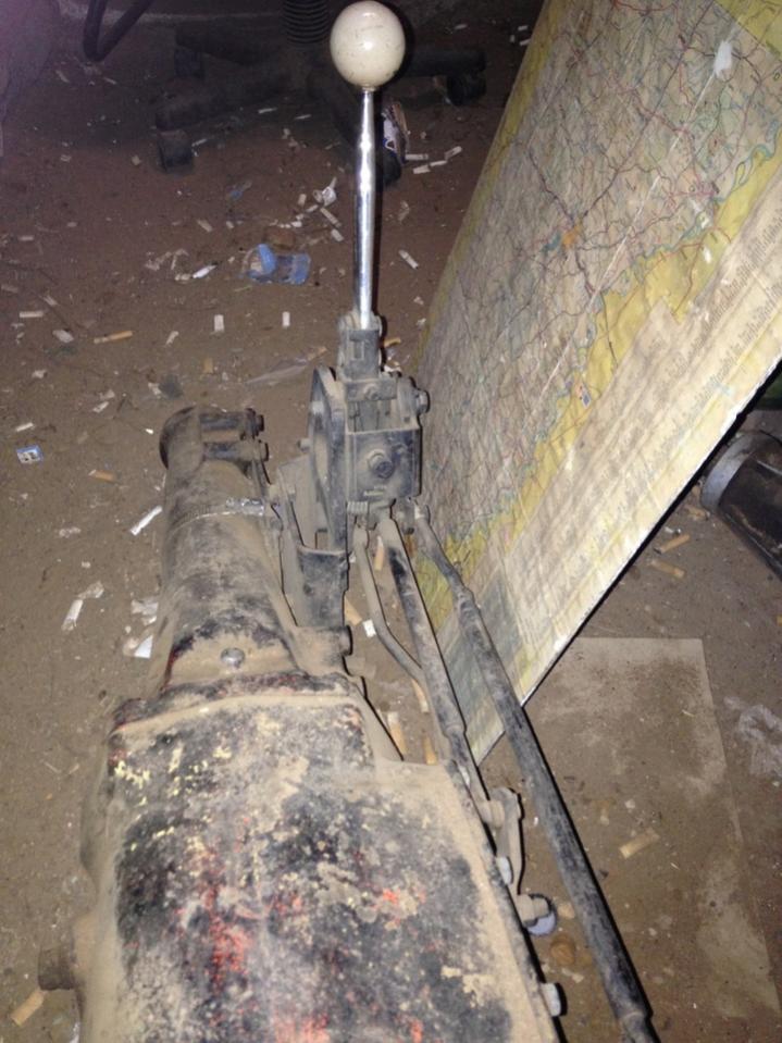

Well I picked up a tranny for my project yesterday. Guess I will be adding another pedal in the car. I purchased an 18 spline A833 Hemi 4-speed yesterday for $500.00. The real kicker is it came with a Hurst Super Shifter. One more piece of the puzzle has been found. Attached are a few pictures of the acquisition.
