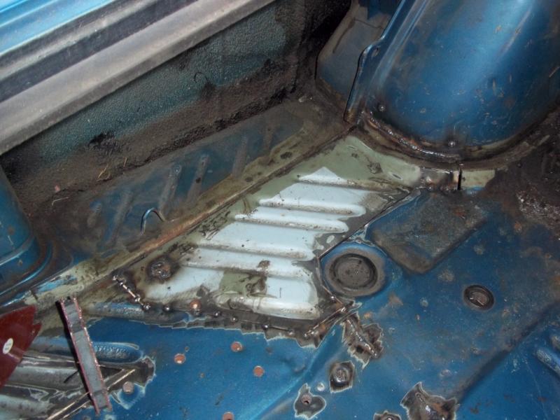

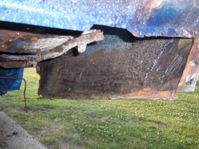

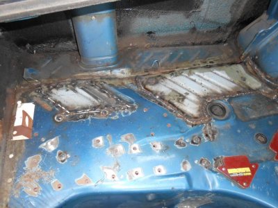

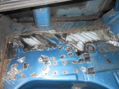

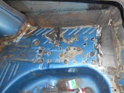

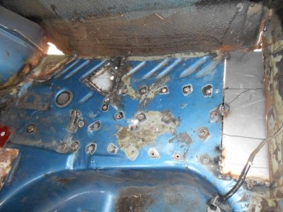

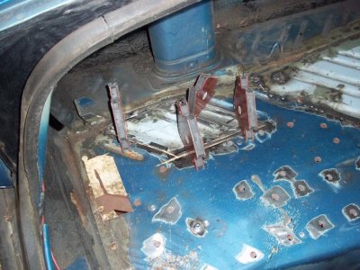

I started patching up the trunk floor last night and got one big patch tacked in before running out of shielding gas (thats starting to get annoying).
Pics as promised. Some of the patch i started welding in, another of one of the others ready for welding and a couple of some of the recently acquired sheet metal. Also on the way is a quarter patch panel from rock auto for the pass side to fix up the rust spots in preparation for putting the trunk extension back in.
A few more of the progress. All but one of the trunk patches are at least tacked in. Once i finish welding and cleaning up the welds in the trunk I will start on the passenger side quarter panel. Then I can get the trunk extension back in and be done with the trunk once and for all.:icon_fU:

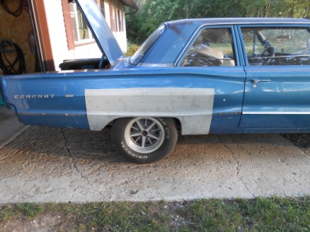

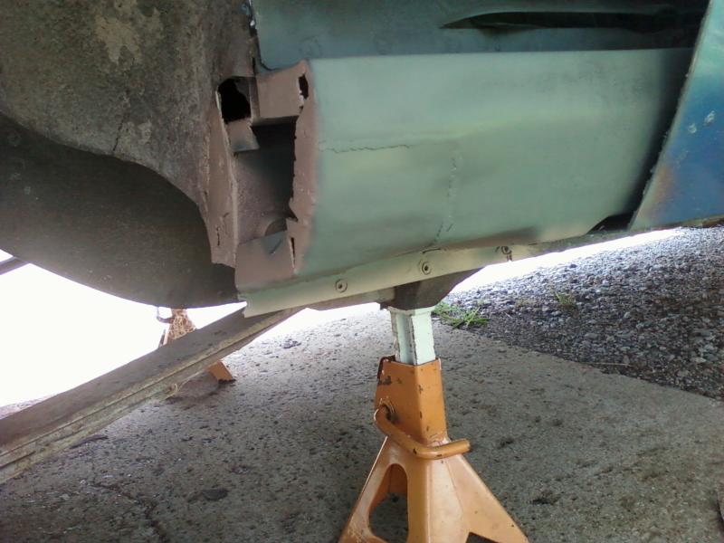

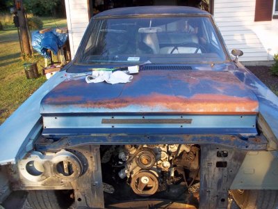

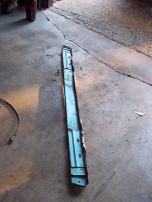

I did stick the patch panel on the quarter where it will go, now I just have to cut and figure out how much I want to use. Photos:

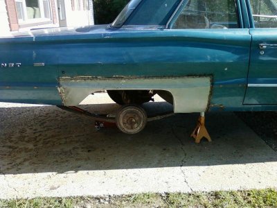

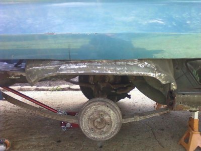

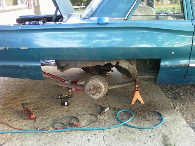

I managed to finally work on the car again last night but it was cut short by lack of daylight. I did get the pass side quarter panel cut to accept my new patch panel though I have lots of patchwork quilt to do on the wheel house. Next time I remember I'll post up some pics but nothing with me at the moment.

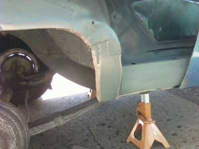

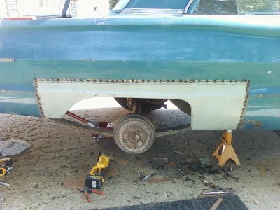

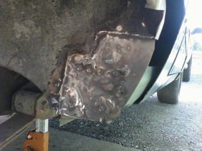

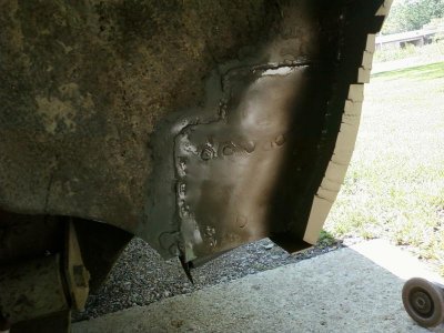

I managed to make some killer progress on the car today. I got the wheelhouse all patched up and even got the quarter panel welded in with the exception of welding it to the wheel house with spotwelds. And of course I still have plenty of weld grinding to do.

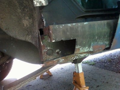

I didn't have a rust free wheel house down in the front corner so I had to make the patch myself hence why it looks a little funky. But being behind the quarter panel I was less than concerned.
looks good.I see you did get the body lines matched up.heck of a job well done.
