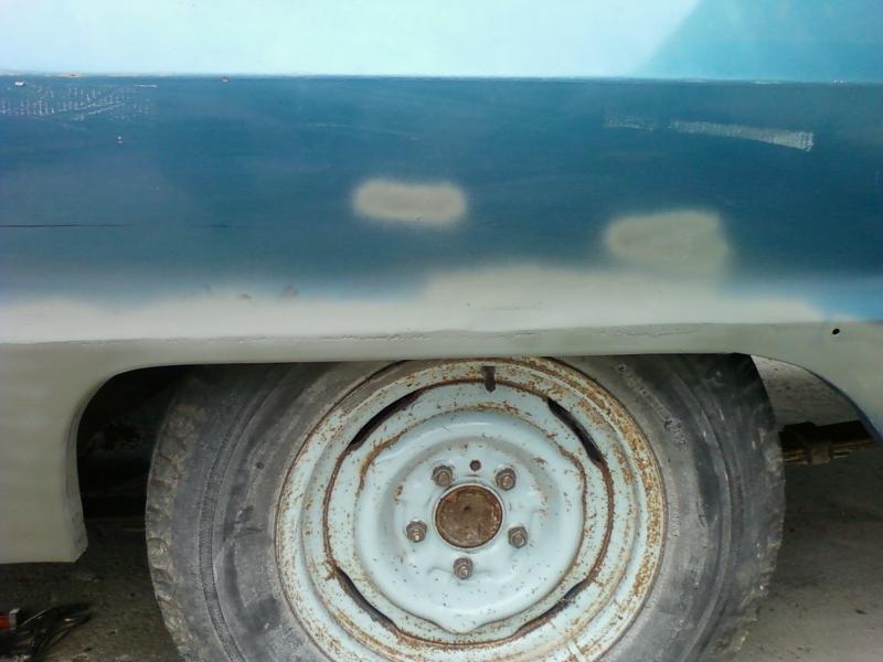

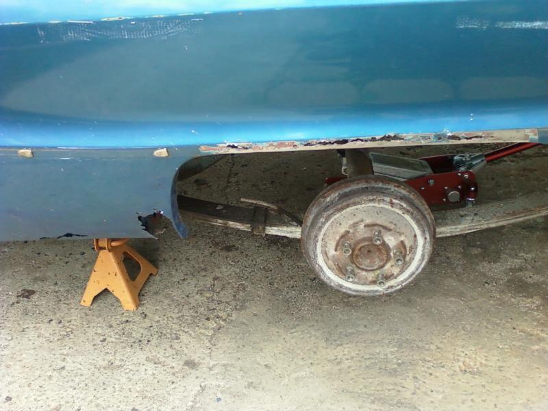

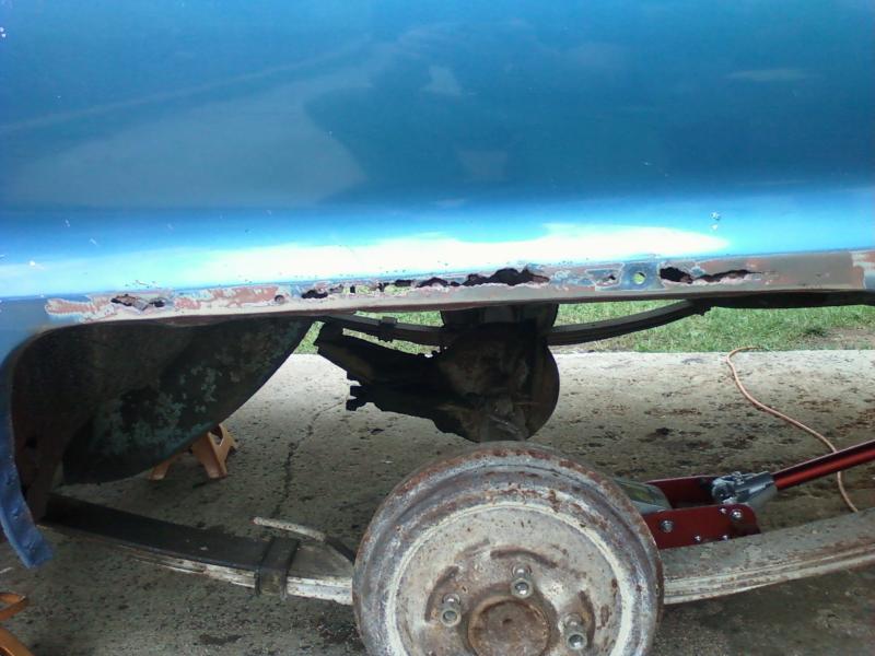

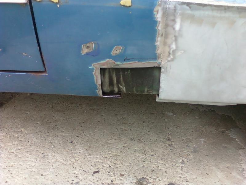

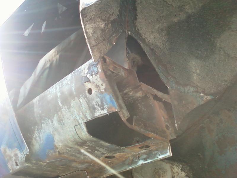

I got a tid bit farther today but unfortunately my trim was hiding a few surprises on the Drivers side. So if anybody can supply a patch panel rust free in the area in the photos let me know.
I did manage to completely finish the pass quarter though. I primed it for now until I start the actual body work. Now I have to finish the other side, put the trunk extension back in the pass side and put the cross rail in the back in.
Are you sure your new to this lol... I have to ask, anything new on the Hemi going in?
Great progress so far, to fix that one area I would make it from scratch, doesn't look too bad to fix. Just get some 18ga steel and cut a strip to fit and cut the rusty part out at the bodylines.

Not yet Ron, Its in the car and just needs to come out for paint and for me to paint the firewall. I am trying to get the rust knocked out so that with any luck i can get this thing ready for body work by this winter. I do intend to hear that thing run sometime this fall so keep tuned...we are getting there.
I will probably toy with that except that look at the second photo down by the bottom. I need to re-construct that whole lower front quarter area and a patch would make that really simple and ensure it looks right. I am trying to do it cheaply but I still want it to look great when I get done. At least the Sherman panel i used on the other side is only $108. I may have to just order another one.
Yeah I know what you mean, I bought the sherman trunk extensions for my Dart because I just couldn't justify the AMD panel when I only needed a small piece. The sherman piece was junk and I had to cut and reshape it to fit and I still wasn't happy so I just made a new one from scratch. I think you could tackle that part with out a patch panel, save those pennies! You have the skills I know you do!
Yeah I think I will work on making the patches for the Drivers side tonight. Worse case scenario if I tack them in and it looks bad i can order the patch panel and cut that area out again. (not that I enjoy re-work). I do have to re-construct the trunk extension as well but I should be able to make the damaged portion out of flat sheet and I will have to get ingenious for making the beads.

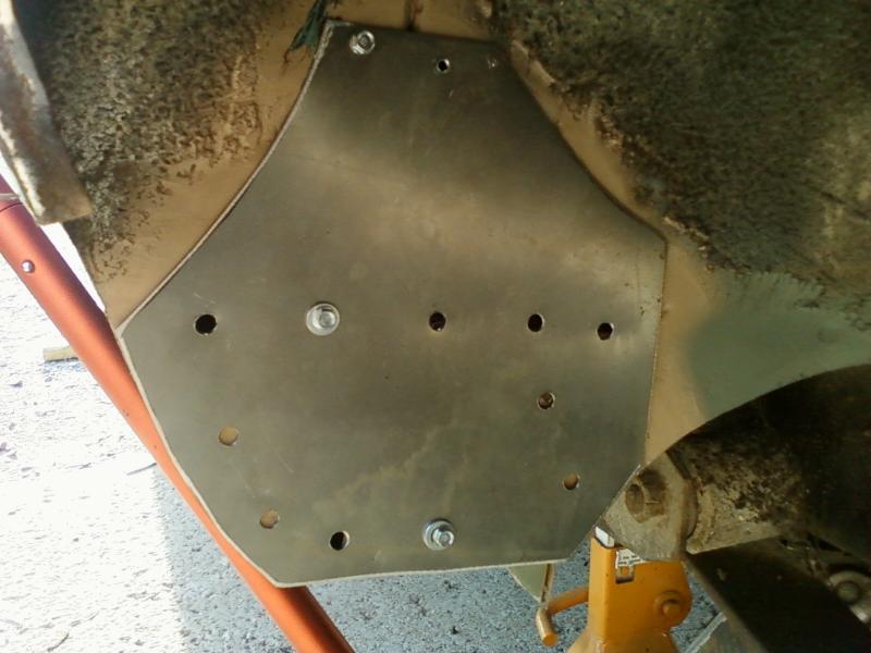

I got the drivers side quarter work started last night. Got a good start on the inner fender and hope to continue on it tonight. I've spent way too much money on parts this month and keep finding stuff....somebody pass me their winning lottery ticket :p
I should get some more done and hopefully get the outer skin tacked in place tonight. I'll throw up a few pictures once I get some more done and get the ones off my phone.

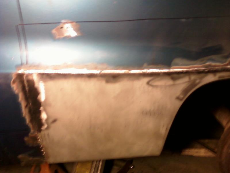

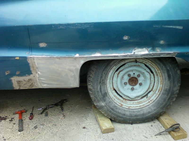

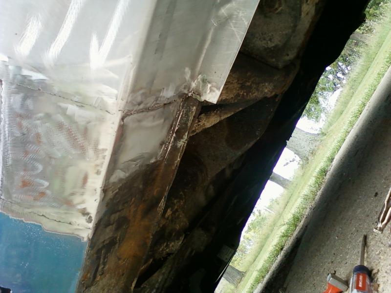

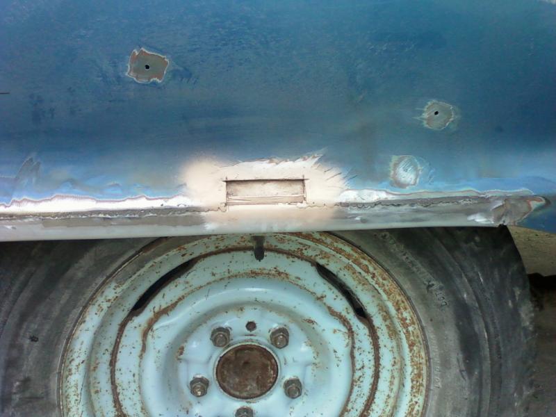

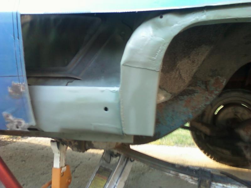

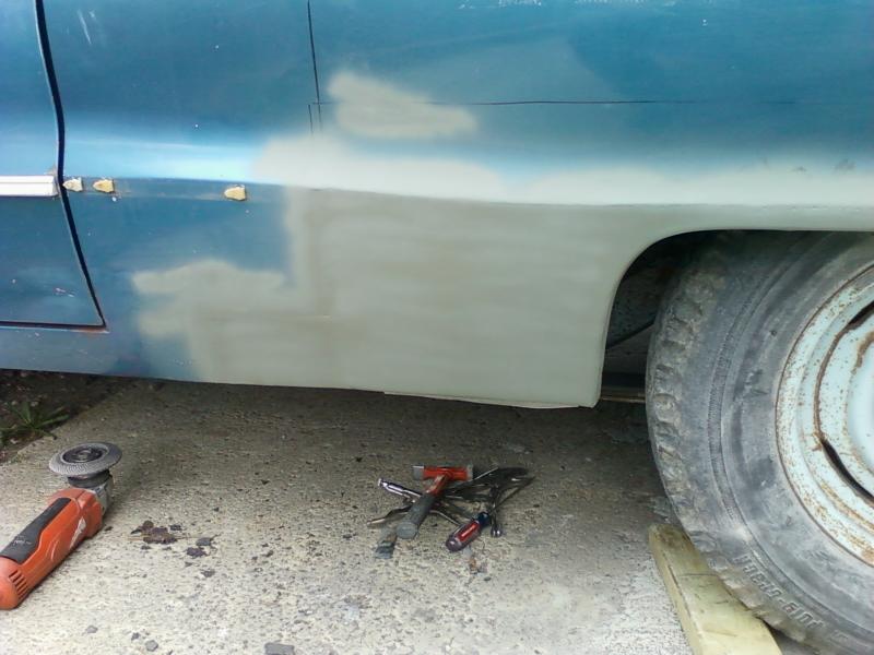

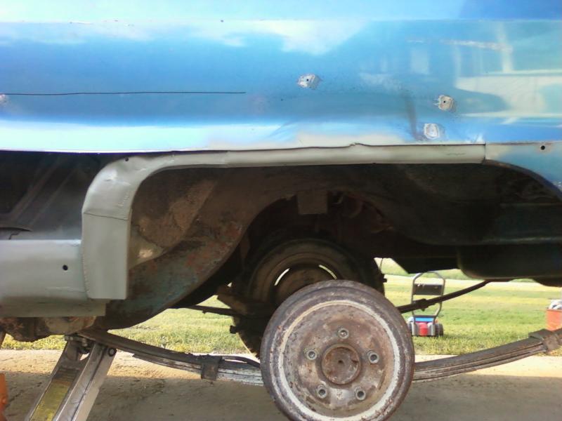

Well I got most of the drivers quarter work done today. I still have some additional patch to do just in front of where my panel stopped. I also have a thin spot to replace but other then that so far its turning out well.
I'll let the photos speak for me. Sorry about some of the blur but my phone camera is unhappy at night.

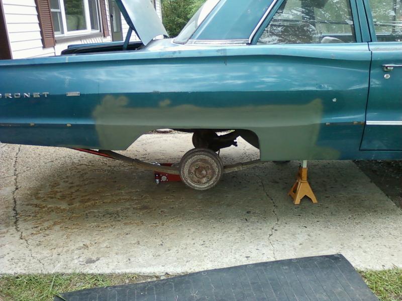

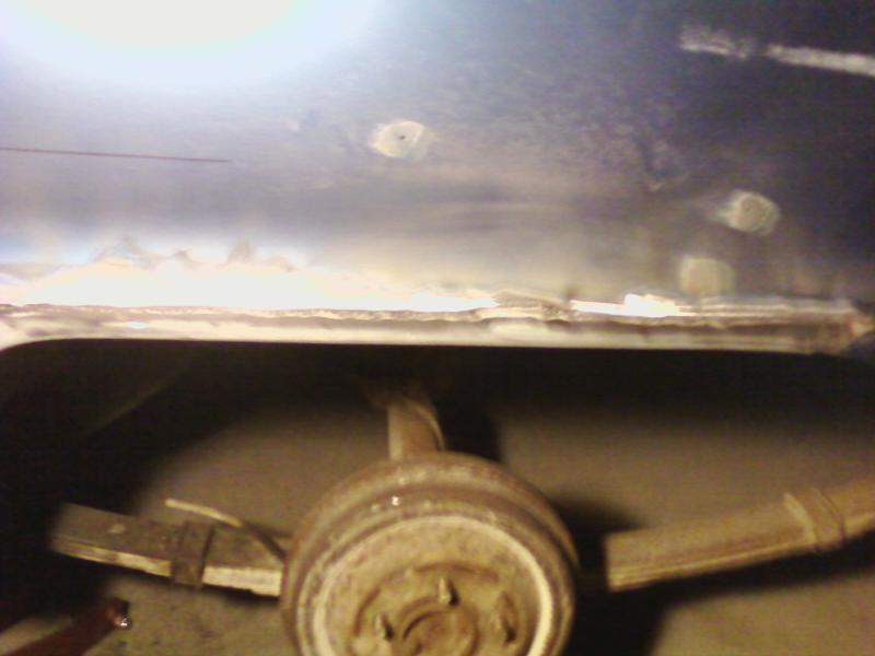

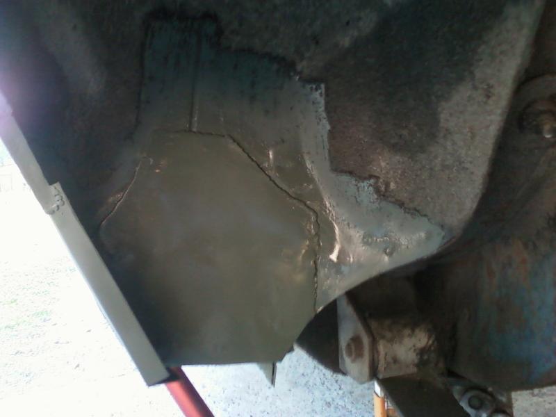

I finished up some more of the work this morning. I pretty much only have to add the spotwelds on the lower pinch and the fender lip opening. I'll do those another day since its raining now. I am very happy to have this work behind me so I can more on to more fun stuff. I can't wait to see this thing with filler all smoothed out and ready for paint...but that won't be this year.

Impressive work, thanks for the update, I look for your updates every visit to the site.
that is a hard area to get smooth,but you did real good on it considering what you had to work with. Do you have/use a straight edge sander?
No, I didn't use a sander, just my angle grinder and 90 deg die grinder. There is still no filler on either side of the car and I just primed it until i start that work (or have it started depending on costs here).
This side was considerably worse then i had anticipated so I am still please with how it came out and it should clean up well with a thin layer of filler. Which given me being a first time body guy I am satisfied with.
