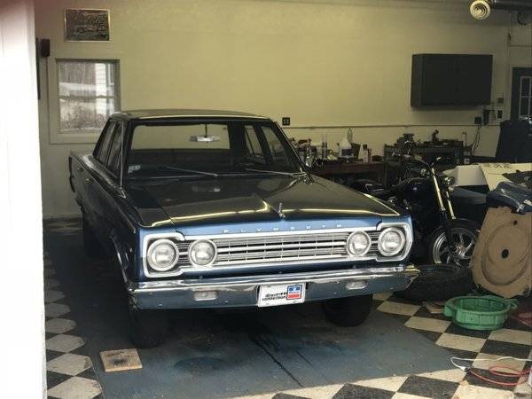

1967 Plymouth Belvedere II

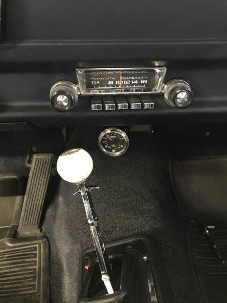

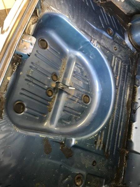

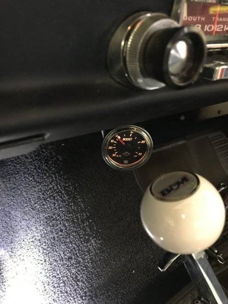

On a side note a friggin’ tree fell on my wife’s Jeep a few weeks ago....got to love it.
290F61EC-2064-4BA7-B0E1-75B50863A0A8.jpeg 2BFD7C86-B67F-4BBB-9294-6A6E87B01D67.jpeg 48099C7D-4295-4975-B914-3EFA5AB362FB.jpeg

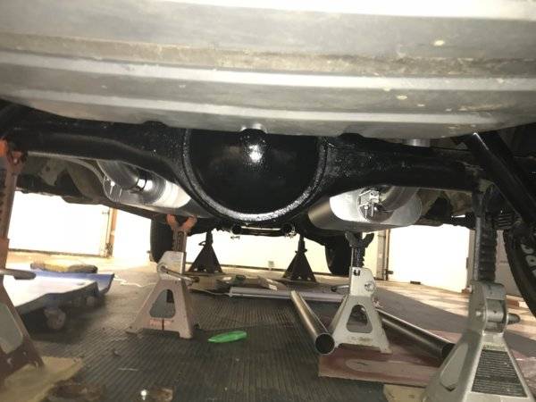

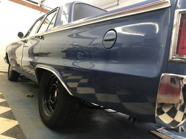

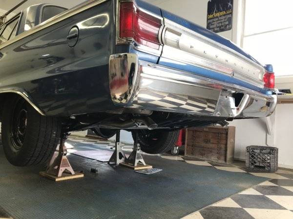

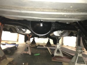

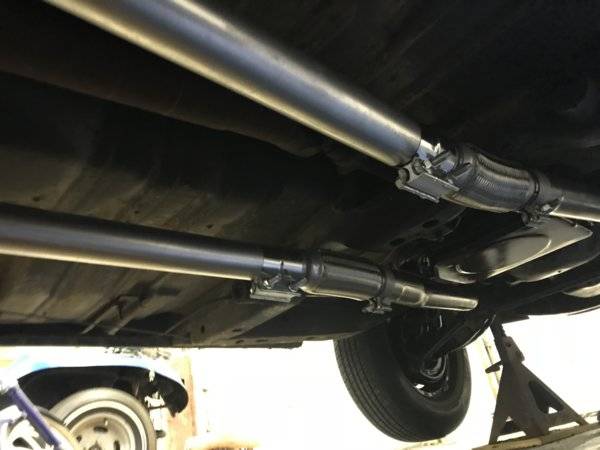

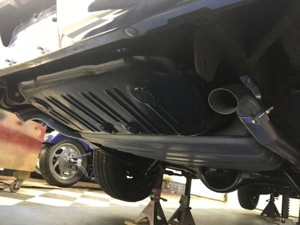

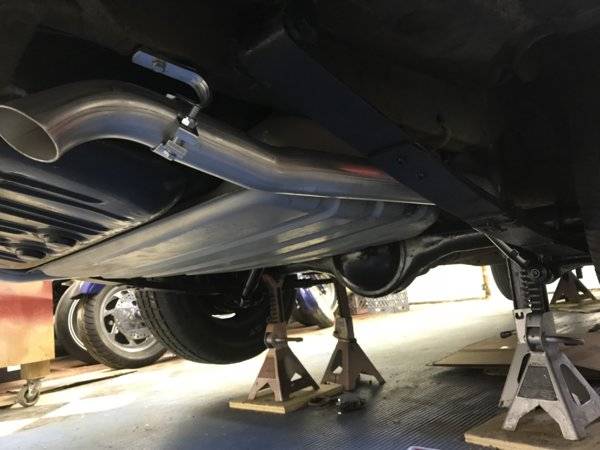

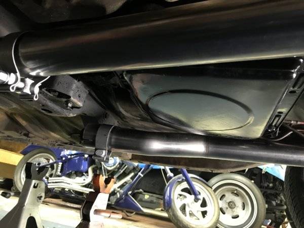

Started mocking up the tailpipes courtesy of Accurate Exhaust. Very impressed by their product. High quailty!!
73499BD3-1D8C-4C5F-B1B3-C6A67C8C86EE.jpeg EA9A55E3-3876-4870-BEF8-6F5E3D45461E.jpeg

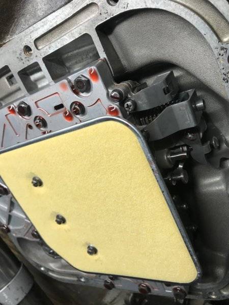

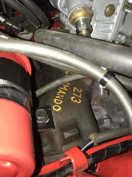

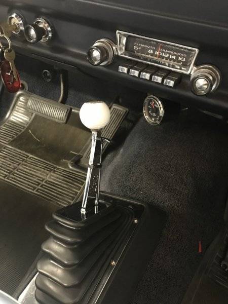

Pulled the tranny pan. i had noticed a leak. It appears at some point the PO had put bolt that was not fully threaded to attach thebl B&M shifter plate. I changed the filter, gasket, and put the correct bolt in. My mufflerd, pipe, and clamps are on there way.

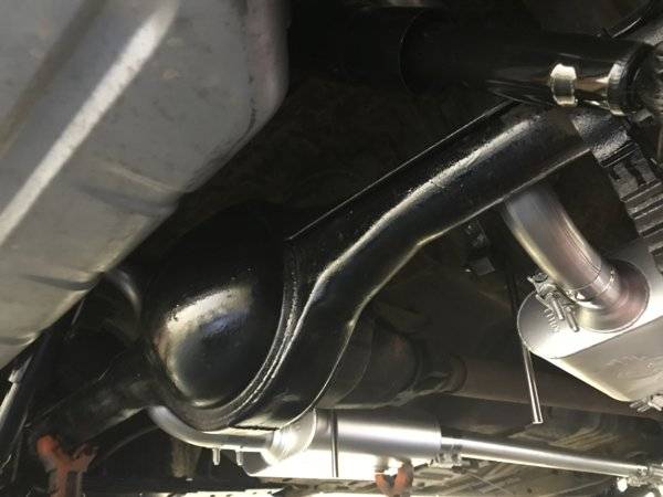

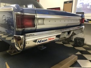

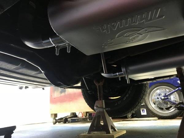

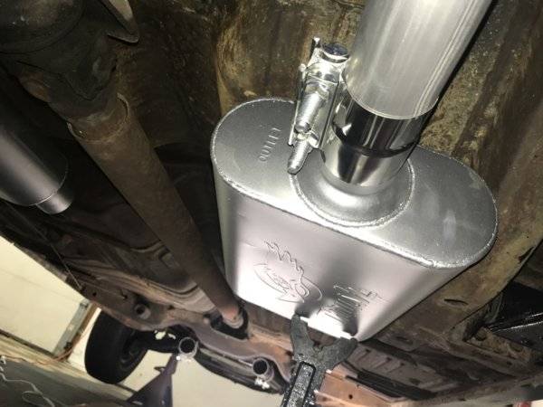

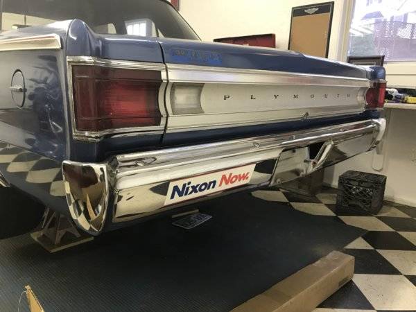

Started hanging the rest of the exhaust. Opted for the welded 2 chamber Thrush muffler. I have used these before, very close to Flowmaster but less than half the price. Also got my vintage Richard Nixon campaign bumper sticker for the rear.
710CA3C9-48D8-43DF-B9D5-5D193E65173F.jpeg 39A4184C-42EB-4B40-8D2A-3628C67C1A4D.jpeg EB80F1E6-06AD-40BD-8D3F-E028D6951BC8.jpeg

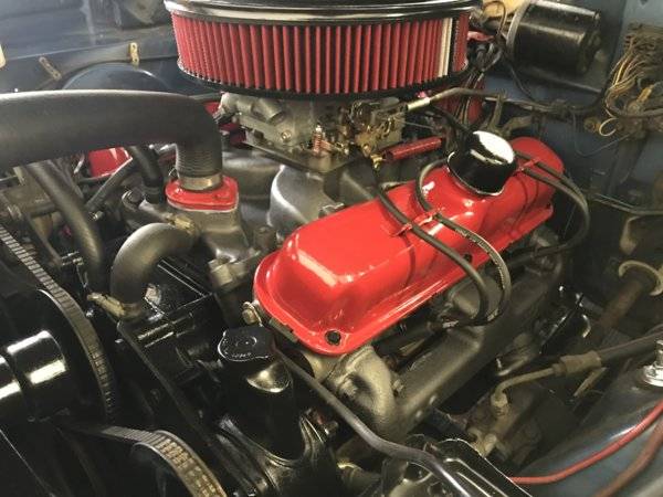

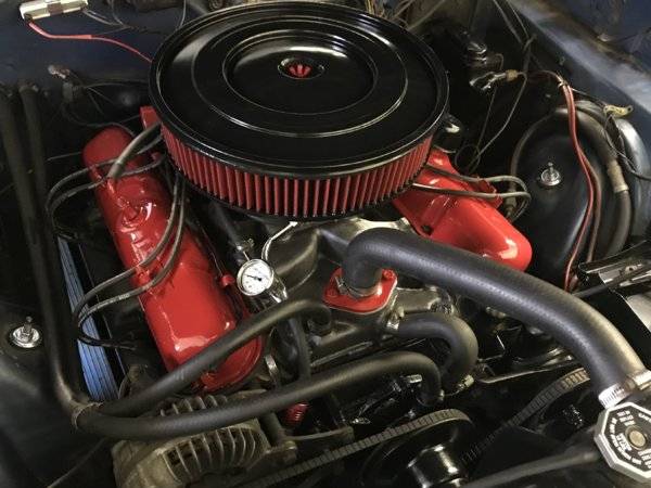

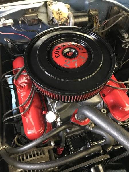

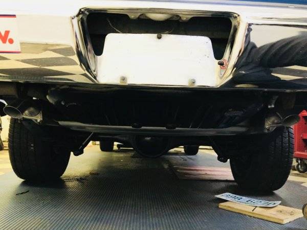

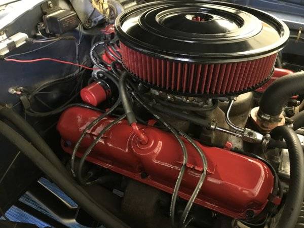

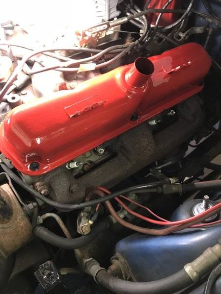

I’m just about finished the exhaust. Have to tack weld a couple hangers I installed. Painted up the valve covers. I plan on painting the air cleaner and brushing heat paint on the manifolds.
Just ordered a new air filter, MSD Blaster Coil, a new rubber gas filler elbow, and a small Sunpro tach.
1070555B-CFD0-4469-84A0-B858D299CC80.jpeg FB473BAA-E154-49FB-AAF3-4A1E0918190E.jpeg 075E53D3-8829-4416-B8FD-7F5E52381AB1.jpeg E1F70DD7-64A5-4994-9F95-886C48B921EF.jpeg

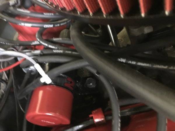

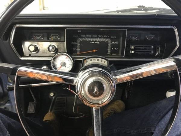

Put in a blaster coil to match the MSD Distributor, new air cleaner etc. I started wiring up a mini Sun Tach.
