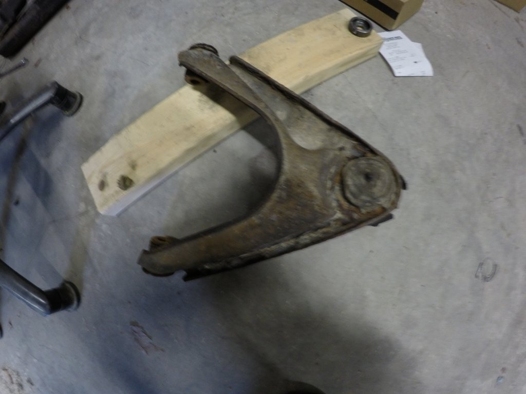

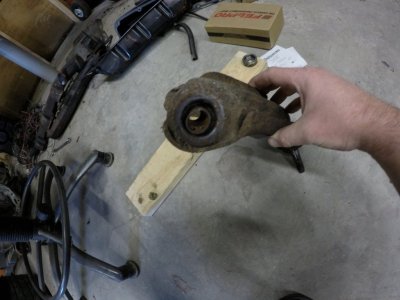

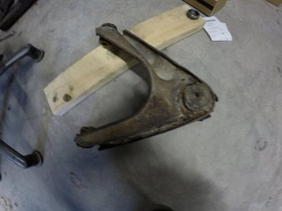

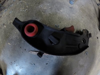

I spent some quality time with Ramrunner last night I removed the lower control arms, torsion bars, upper control arms, shocks, and strut rods. I picked up an Energy Suspension Poly bushing kit a few weeks ago to replace all of my worn out rubber bushings (and MAN! they were shot!) no wonder Ramrunner handled so bad at the autocross.
While removing the torsion bars, and lca's I damaged the pivot shafts. I shopped for some this morning, I can't believe they cost $65 bucks. By chance does anyone know where you can get them for less than that? Also since the torsion bars are out I think they will be replaced with the big block bars, I have not found a source for those yet.

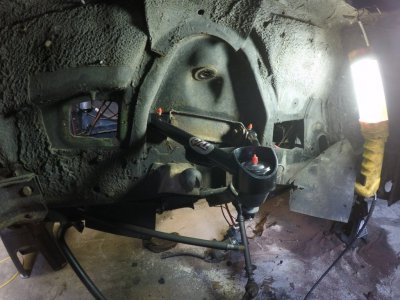

Oh I forgot to mention the QA1 uca's. Wifey got me those for Christmas (isn't she the best).

As of yesterday I got all my new parts installed. I also got the engine and transmission back in. I did not pick up a 1996 and new kegger intake, so I had to fab up an EGR block off plate, and plug for the EGR tube. I'll get some pics later today.
