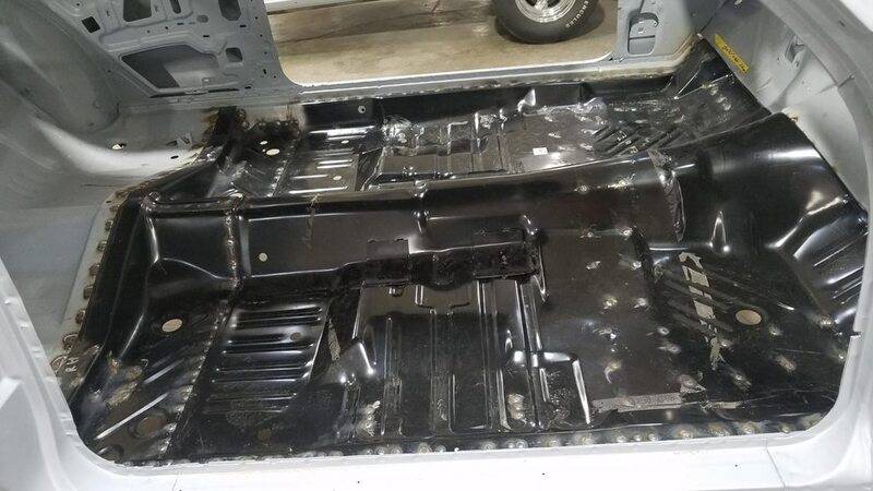

Floor pans are in....

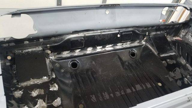

Cabin floor spot welds all knocked down and dressed

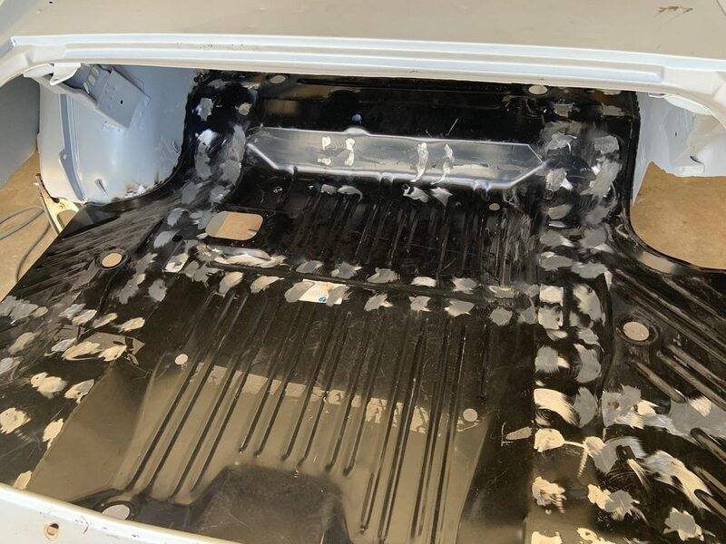

Trunk floor is also in now

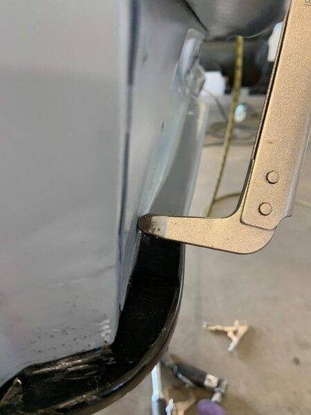

After some straightening, the driver's side quarter panel end cap fits greats now. before and after...

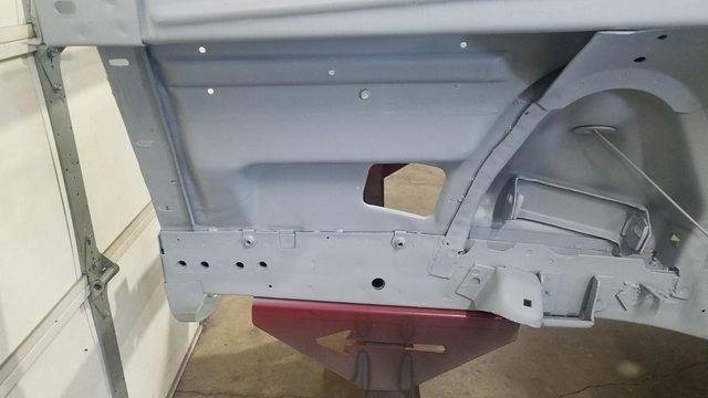

The area under the battery tray was rusty. Used a solid original donor...

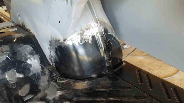

A previous owner cut out part of the passenger side wheel tub...apparently for a patch.

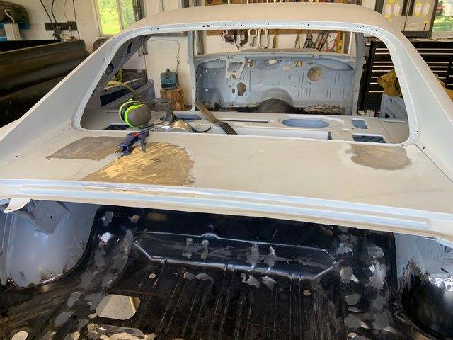

Next step is to remove some of the dents, dings, and creases. The right quarter panel was definitely the worst but the dutchman's panel had some big dings and the passenger quarter had a few too.

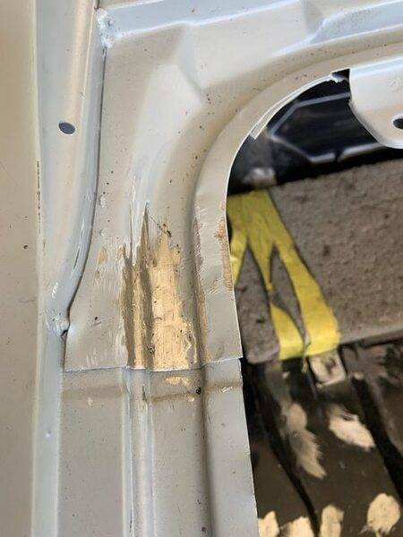

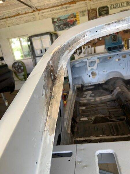

Time for some rear window channel rust repair. It's interesting that this charger didn't have one spec of rust in the lower channel. The rear lower corners had a few pinholes. I'm sure that it's because the rear window had been out of the car for 20 plus years. But....there were some small holes in the upper channel.
There were also a few pinholes in the trunk gutters where the forward gutter (dutchman's panel) overlapped with the side gutters

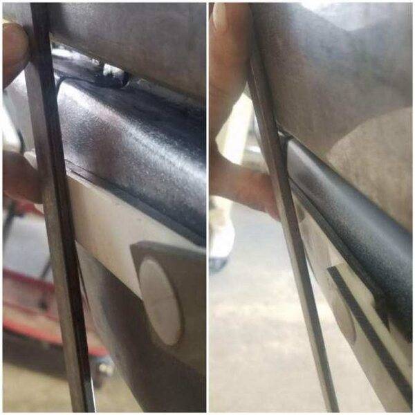

Your doing the fun stuff now, Great work! Great pics also!.. I did most all of the same stuff on my 68 that your doing, that we all do on the crusty ones.. I really enjoyed that part. Makes me want to do another one. Depending on how much you did in the corners of the window and if you haven't already, you may want to put your rear window chrome/ss trim together, with tape, and lay it in place to check your corners. If you have original trim, you usually can see exactly how far the trim pieces go together, one into the other, by looking on the back/inside of the trim pieces where there should some stain marks from age. This will give you a good check without messing with the glass.

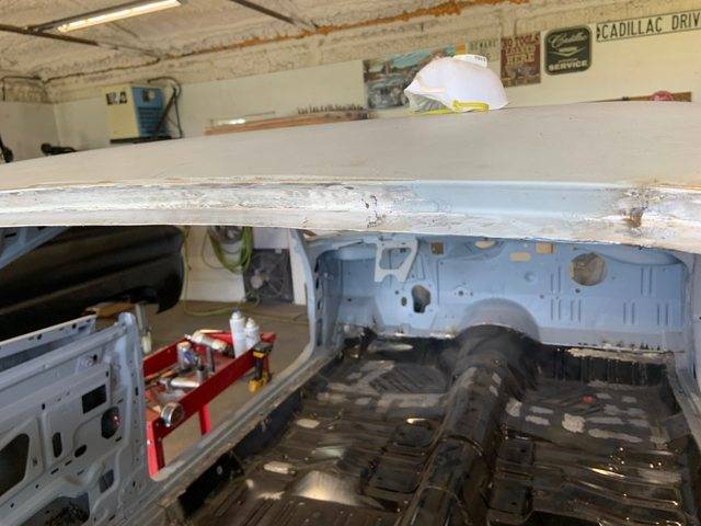

A few more cleanup items on the battery trey area and a big dent on the leading edge of the roof
Back side in bare metal and then in primer...

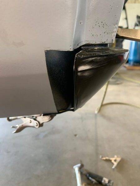

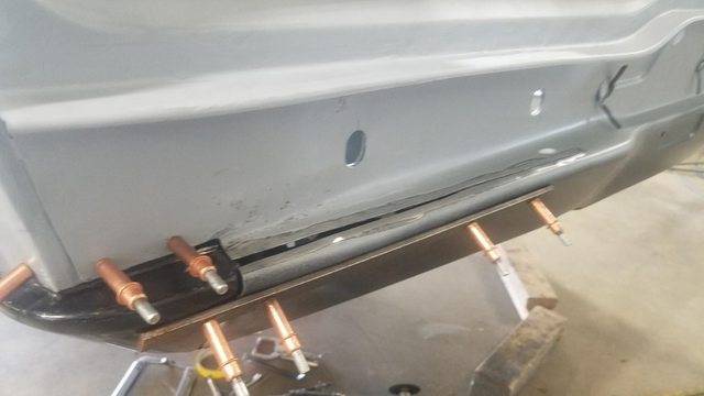

The rear valance corners just didn't want to fit. As you can see, they gap on the forward edge and they don't line up with the tail panel character line either. Hopefully this series of pictures can help some future builders.
A section was cut out. The piece was rotated slightly and welded back in. The rotation created a small "pie slice" shaped gap at the forward edge.
Next the rear valance was sliced along the top to again bring the edge out
