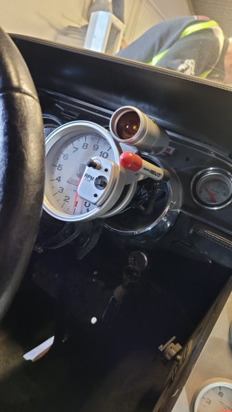

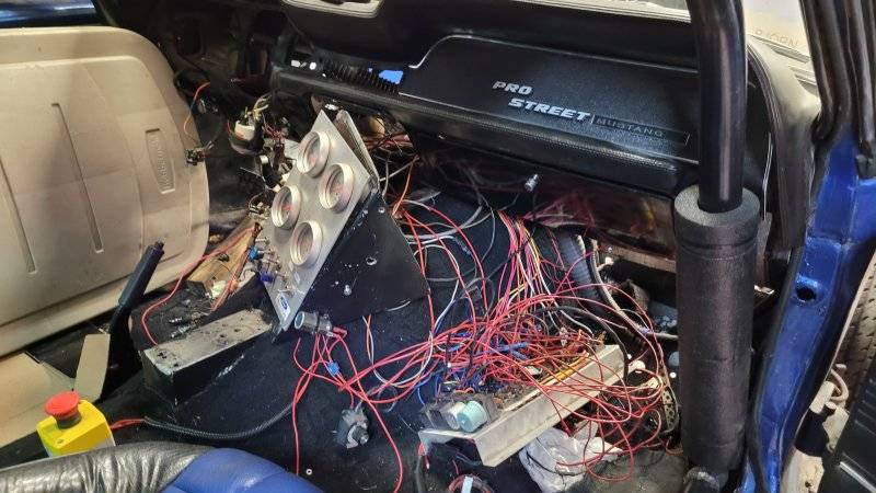

It came without engine, it's an old Pro street car with a cage and everything that's been sitting for many years since the previous owner got tired of repairing the blown engine after several brakedowns and sold it. I'm currently helping out with the wiring which was a mess. I tore everything out and started from scratch with a cheap "21 circuit hot rod wiring harness". Almost the same job as I did on the Charger. Trying to clean up the cluster and fit the autometer gauges that came with the car inside the cluster for a cleaner look. We'll see.

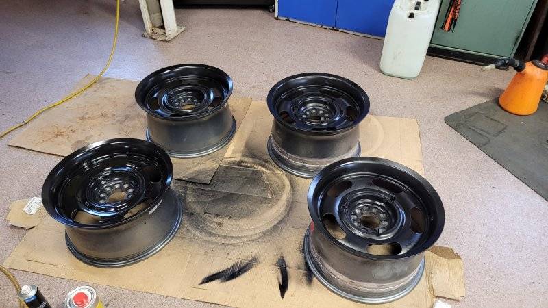

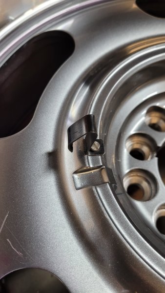

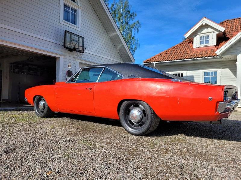

Finally had som time over the holidays to work on the weels. 275 in th front and 315 in the rear. The rear rims have been widened with 1,5"(42mm) to 11,5. The fronts are 10". To mount the hubcaps i found some steel clips from a VW beetle, 60s that seemed to fit and I got lucky. They fit great! Sprayed the rims with matte black plastidip temporarely, not sure what I want yet, spray satin black or bright red..? The fronts touched the brembo calipers so I need to find a suitable spacer, the only ones I had are 35mm which is way too far out, 10mm will probably be fine. Might need longer studs, anyone know where to order that from?

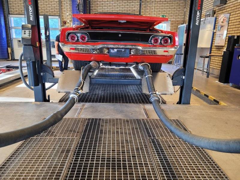

The emergency brake will not get approved, turns out the Swedish standards for how much force they should hold up differs from US standards. the SSBC rear brakes doesn't hold up good enough. I'll try and tighten everything as much as I can and also add some more support to the steel plate holding the 2 rear cables. it has some flex in it now and getting rid of that is the first step.
Not much else to do before I can take it in for the vehicle safety inspection to be able to fully ensure it and drive it around for real.. looking forward to that.
