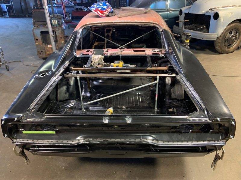

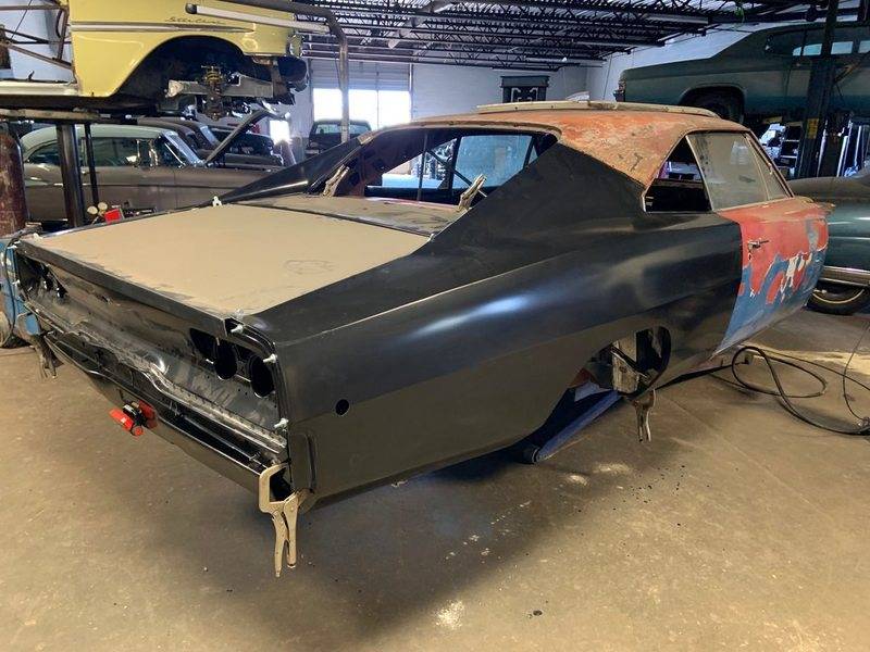

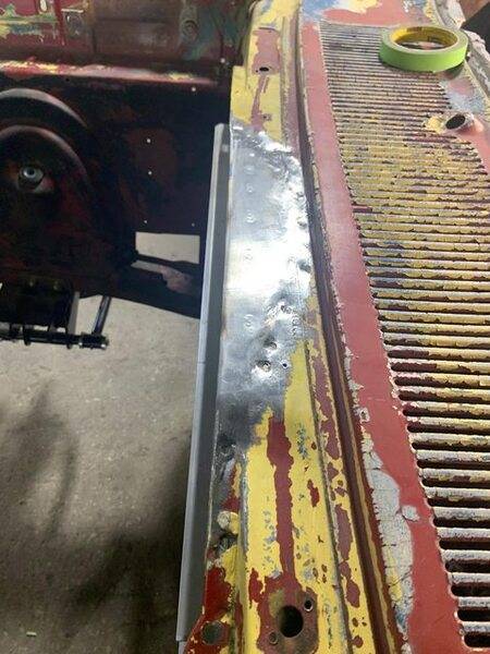

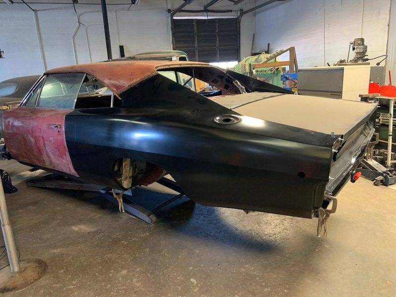

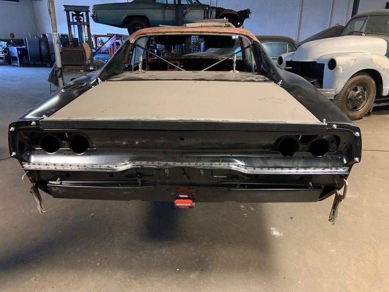

Well, a year later its making some progress...new AMD quarter panels, dutchman's panel tail light panel, rear crossmember, rear valance, one piece trunk floor, and trunk floor extensions.

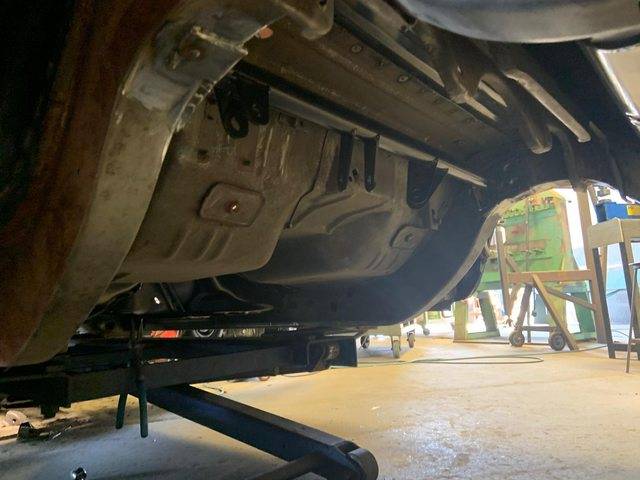

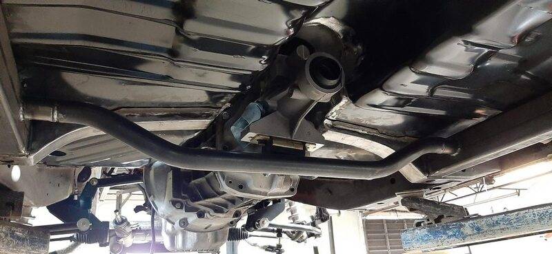

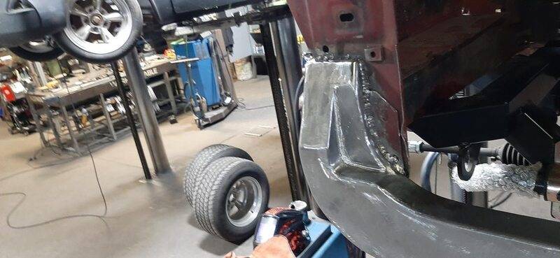

The RMS 4 link bar has been welded in. The Ford 9" rearend will be narrowed to fit my wheels and tires.

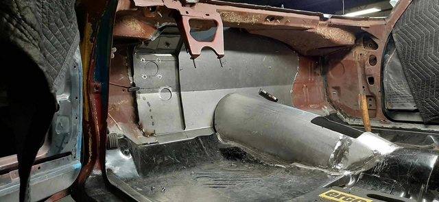

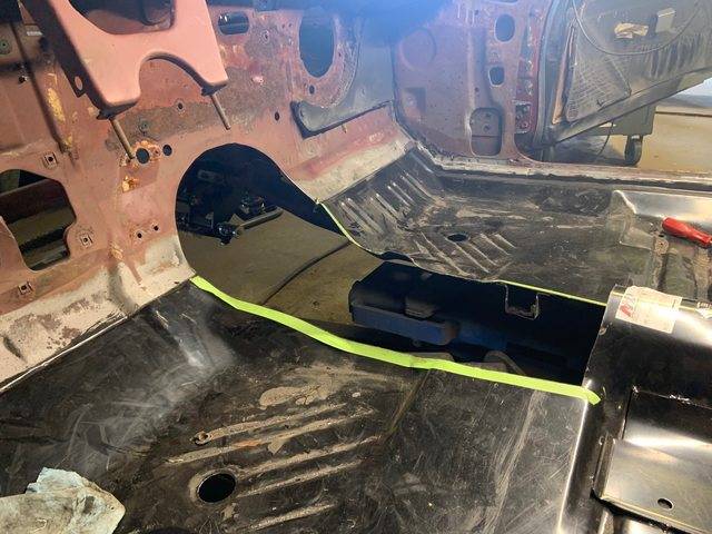

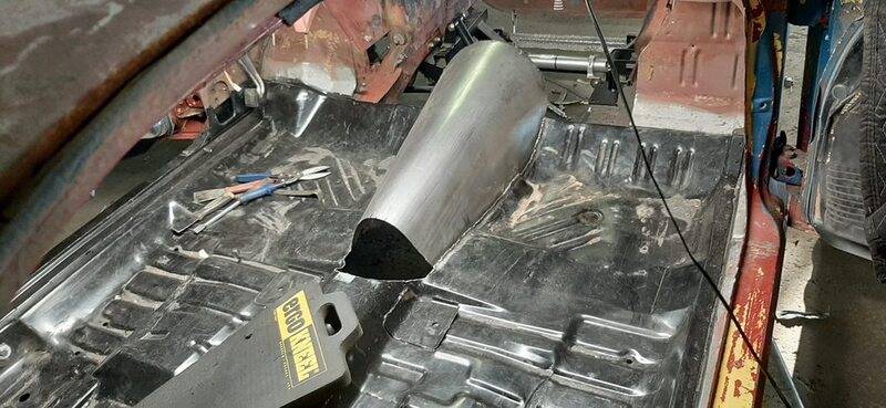

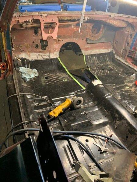

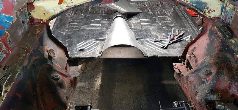

Also, I changed direction on the transmission. I had a TR6060 laying around in my shop from when I parted out a late model Challenger SRT8 so I'm going to use it. So the tunnel had to be enlarged...

Why a 9 inch?

Love the direction this build is going in and the work going into it, great job so far. You won't regret the decision to go with the 6 speed, there's the reliability and then there's the fun factor lol. I only drove mine one year with the auto before switching to the Viper trans, instantly doubled the miles I drove it and opened it up to long relaxing hauls.

Why a 9 inch?
Because I parted out a wrecked 1970 Challenger restomod that I bought from IAAI. When it arrived, the rearend was a BRAND NEW Moser 9" with 4.10 gears and Baer 6S disc brakes on all 4 corners. I was expecting an 8.75 but got a nice rearend with sweet brakes. It's pretty much free.

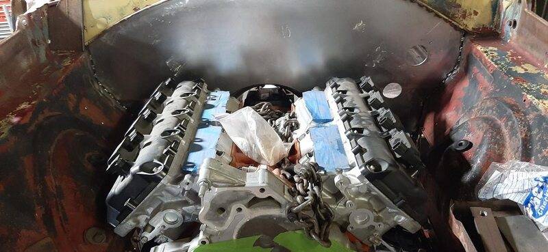

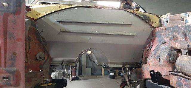

Firewall is in place...also the 6.4L BGE Hemi and the TR6060 were mated and installed for mockup of the transmission crossmember.

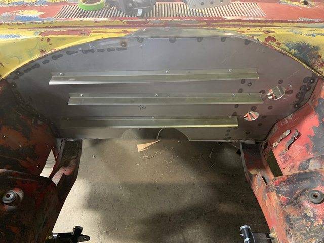

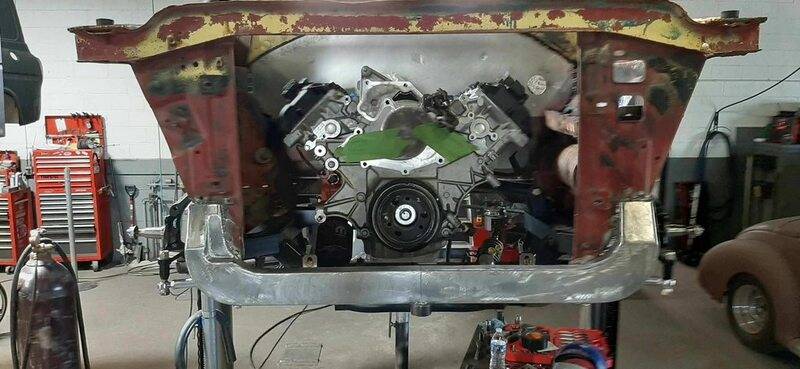

A front lower radiator support was built since I'm not a fan of some of the other aftermarket offerings. It's got a pocket on the passenger side to account for the vintage air conditioning condenser/hard lines.

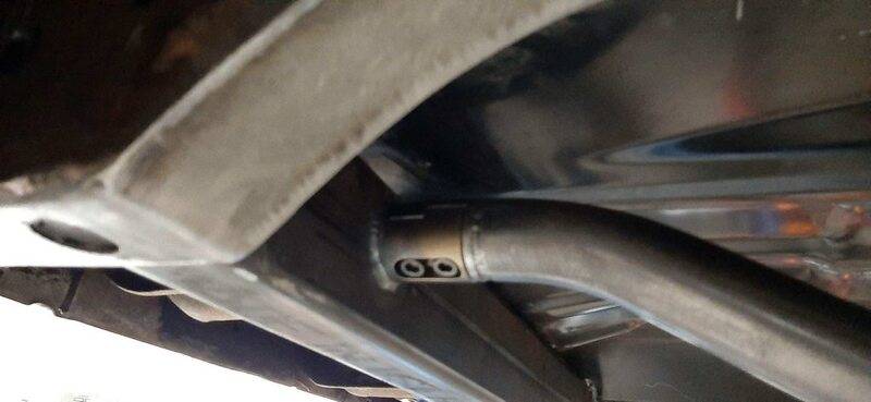

Since the TR6060 has a fixed flange (not a slip yoke) I ordered a Magnum conversion kit. This makes the transmission crossmember much easier. Transmission crossmember is in place
I love trans cross member!
