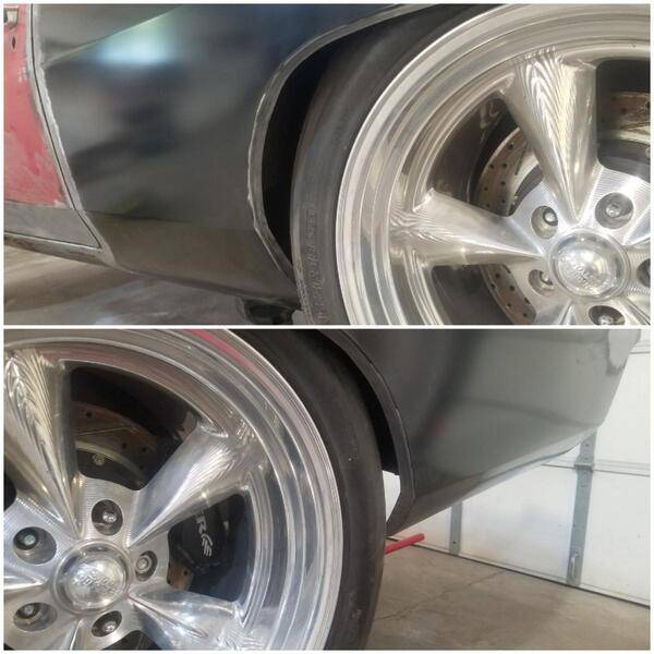

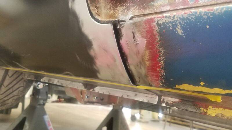

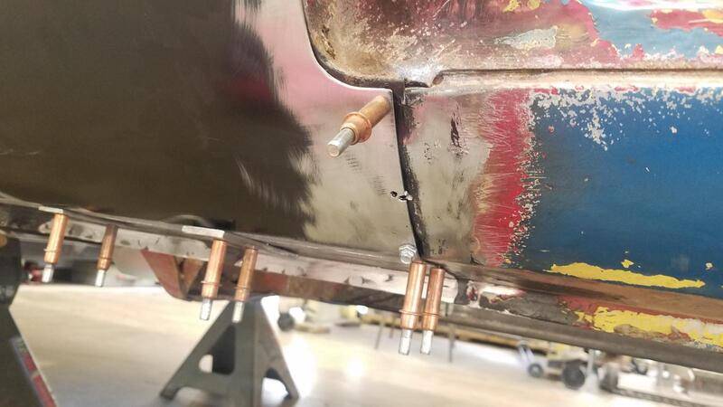

A cut was made along the bottom right quarter panel so the quarter panel could be pulled in match the door profile.
Right door hinge was rebuilt and then the right door to quarter gap was set before welding the leading edge of the right quarter...

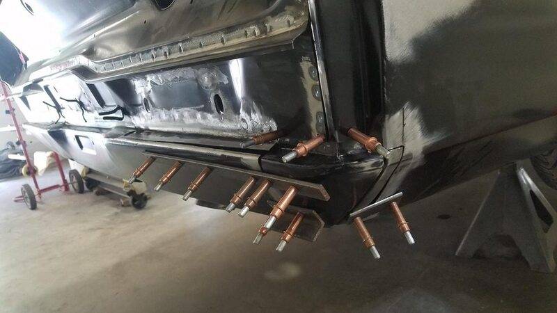

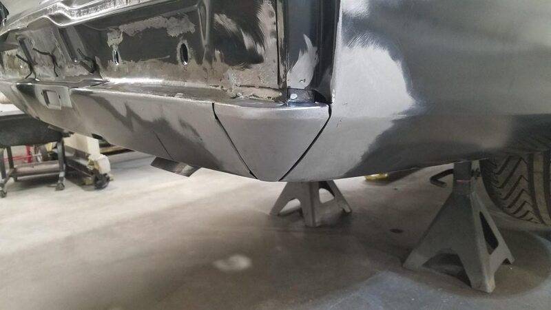

Next up...fine tuning on the rear valance and valance corners. They always fit terriby.
A pie cut was used to straighten the upper line on the valance.
A pie cut was also made on the quarter just forward of the corner. After...

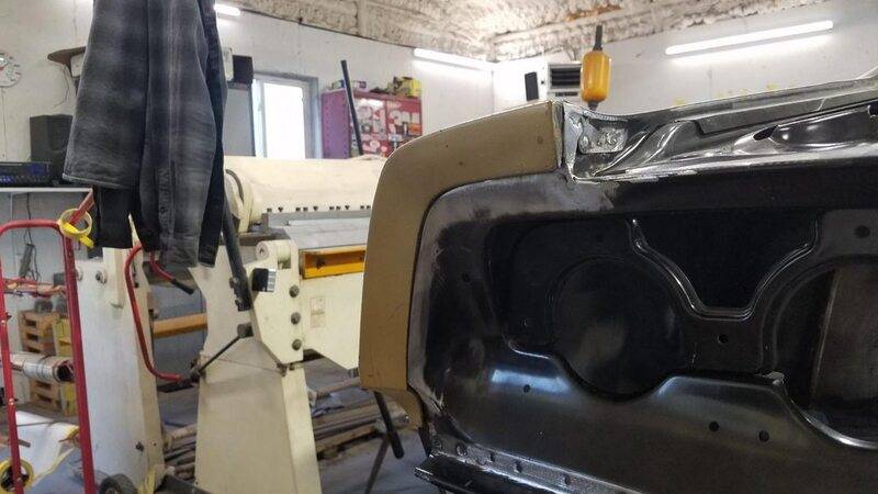

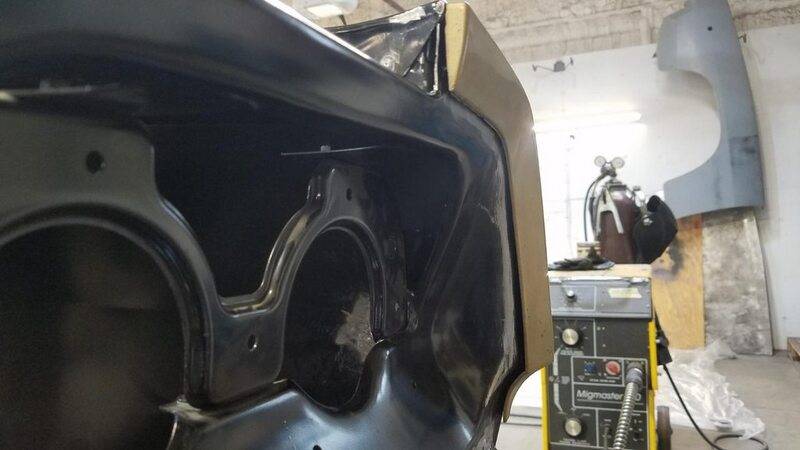

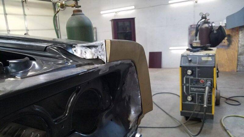

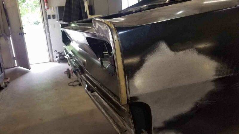

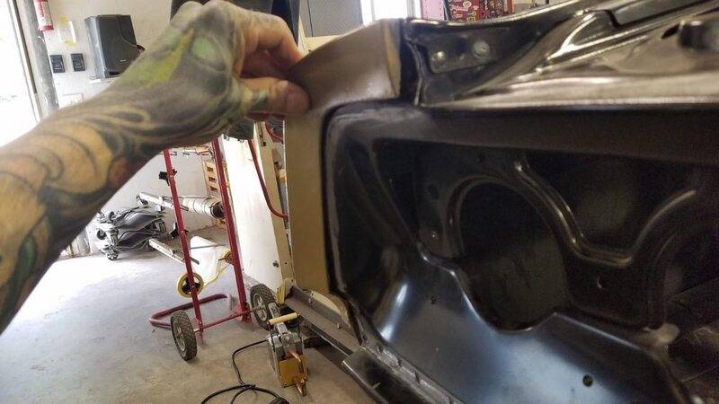

The quarter panel caps didn't fit very well, so the quarters were massaged to get a better fit.

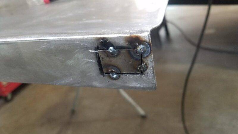

The decklid lip had some rust bubbles so a patch was made...

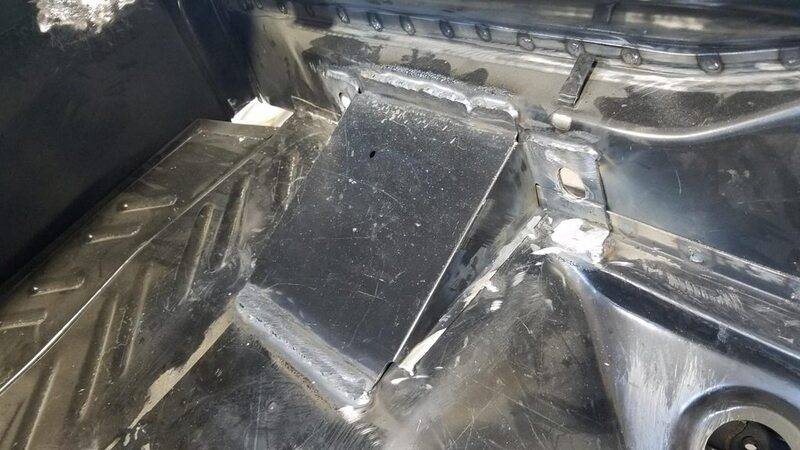

Trunk floor braces were welded in
Excellent work as always

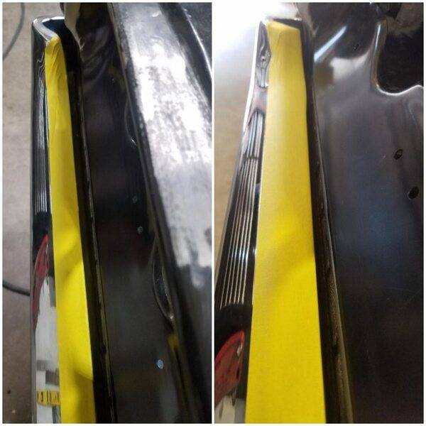

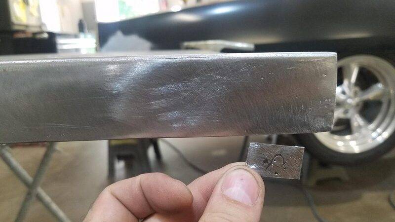

I bought a new AMD rear bumper for this car....I've been a bit disappointed in it. The yellow tape to show you the profile of the edge, which wanders. It will be powdercoated satin black anyway, so the edge was shaved so it would be straight/parallel with the taillight panel. Compare the gaps between the bumper and taillight panel and you will see the difference
Well to be honest, even the stock ones were not all that straight and you obviously have higher standards than a typical restoration so I guess modification is or should be expected.
