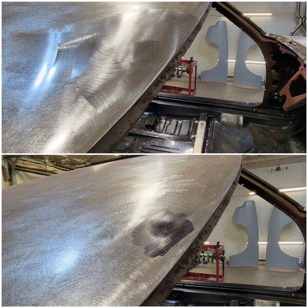

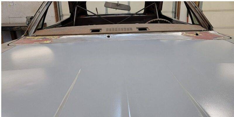

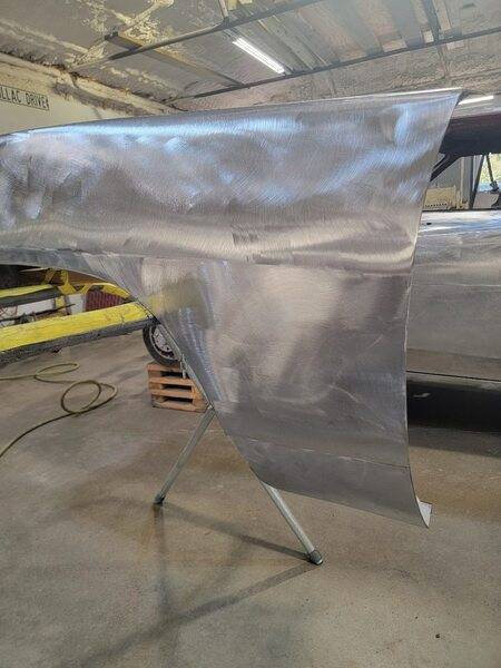

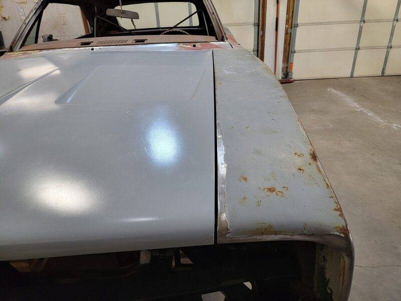

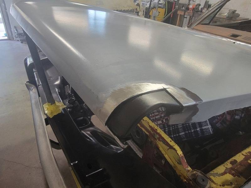

The hood alignment was good except for the fit to the after market passenger side fender, which was a little too long at the forward inboard corner. The fender was cut at the leading edge, trimmed, re-arched, and welded back up.

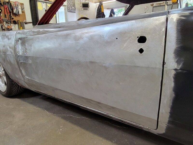

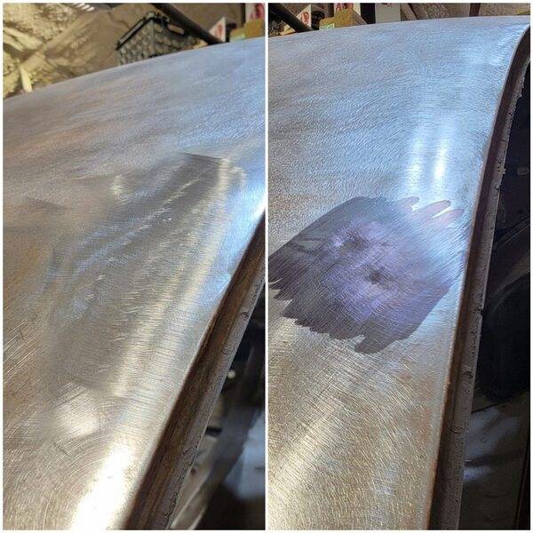

Good job! Wouldn’t that filler with aluminum in it filled those divets?

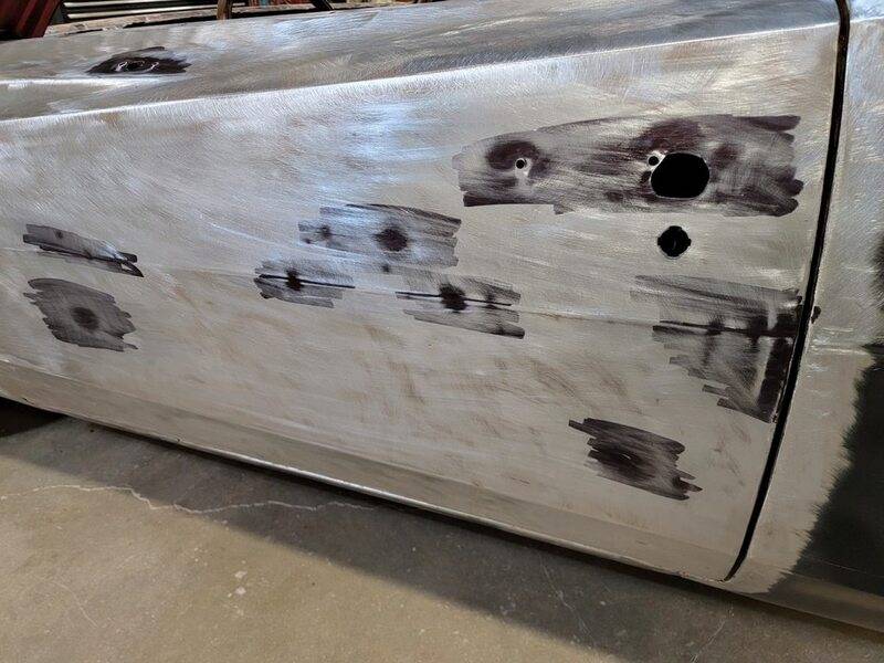

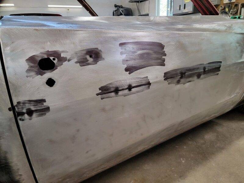

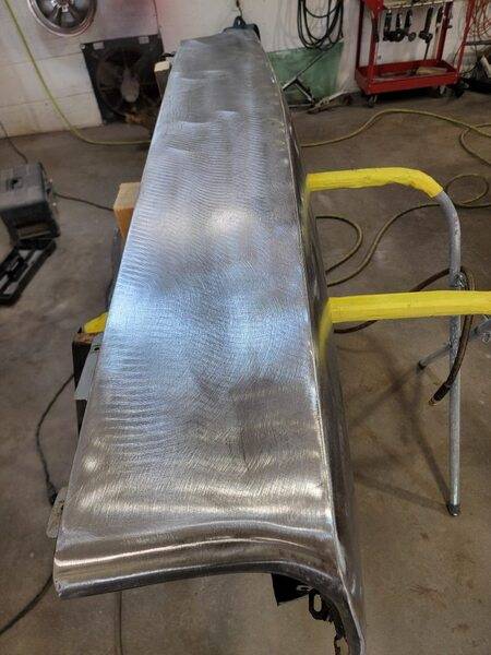

The left front fender looked decent in epoxy but had plenty of dings from over the years...

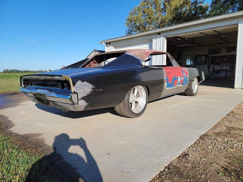

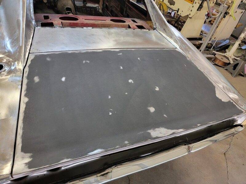

May as well get some cool pictures in bare metal before it all comes apart for media blasting inside and in all the nooks/crannies.
Clear it! Lol!!! Looking good!

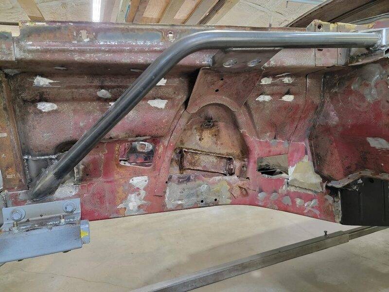

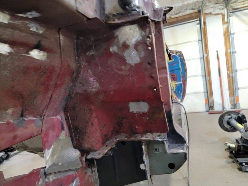

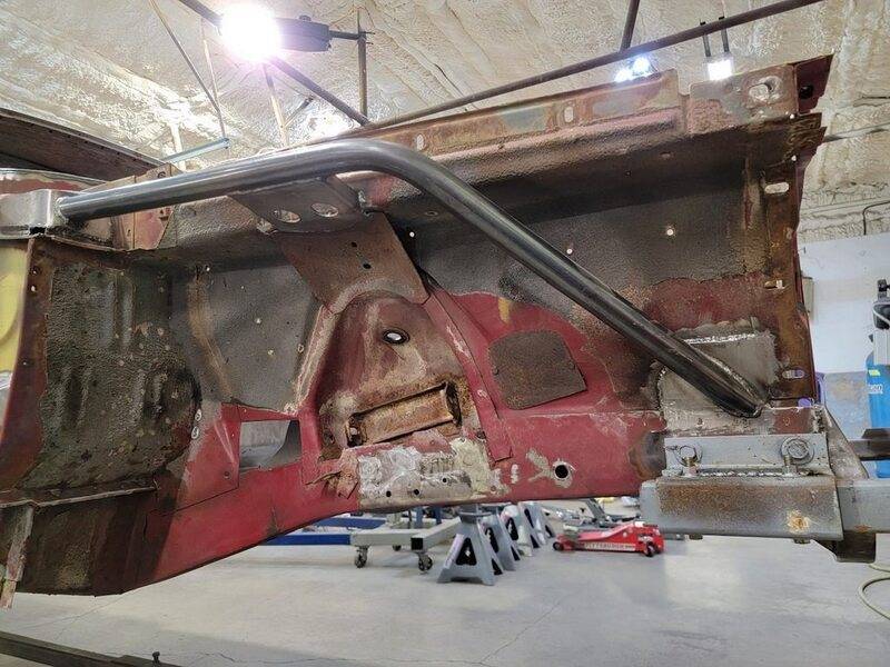

The exhaust was running pretty close to the rear frame rails, so the rear rails were narrowed next to the cylinder mufflers. The firewall welding was also finished up.
