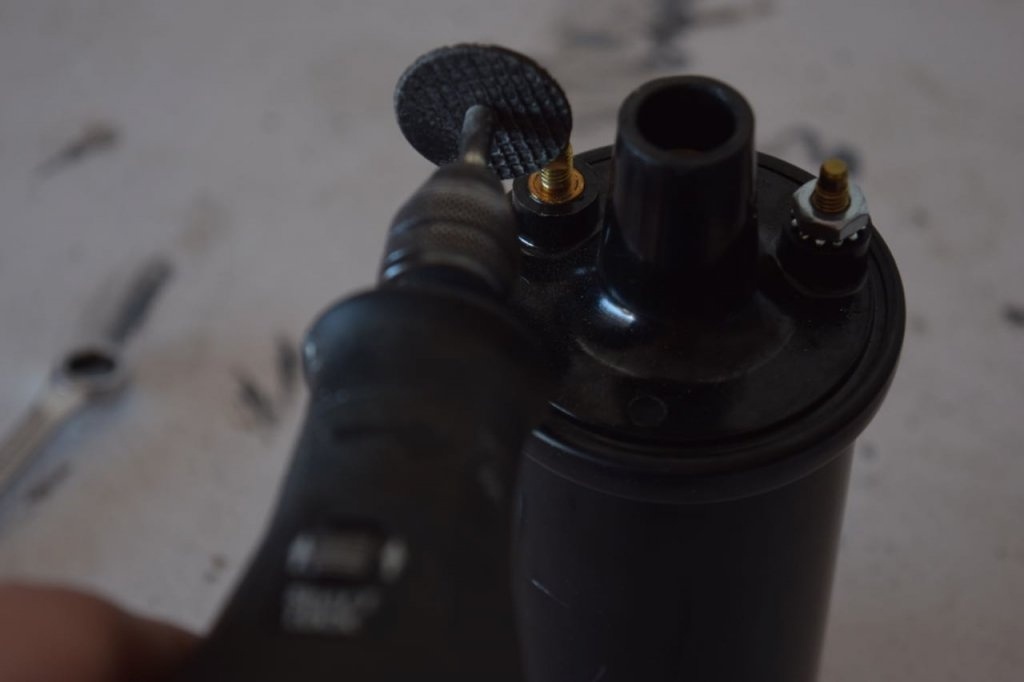

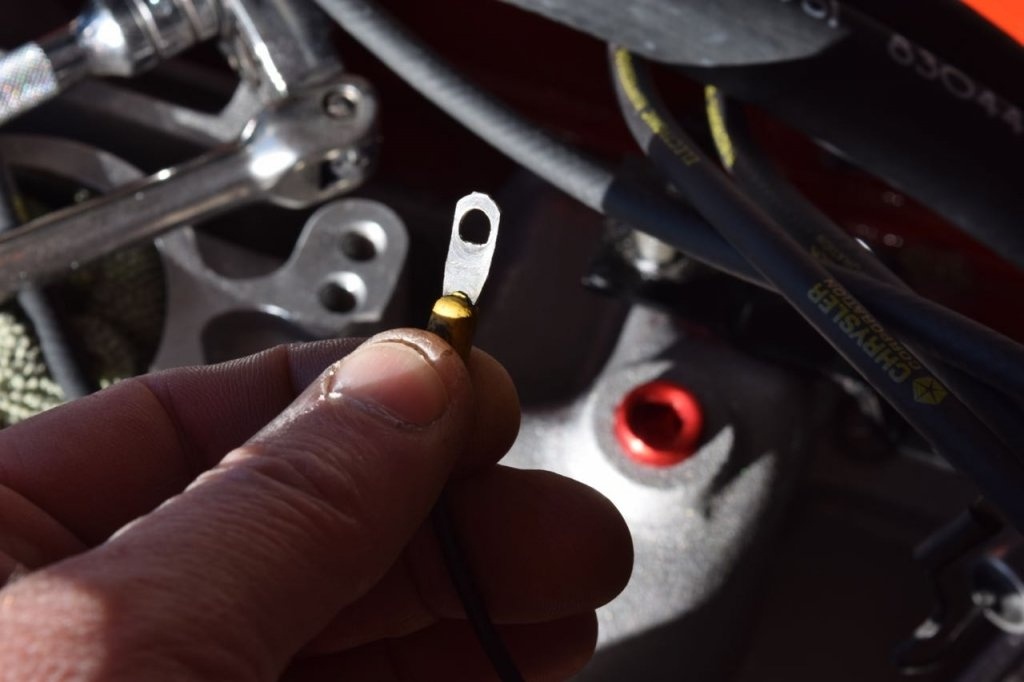

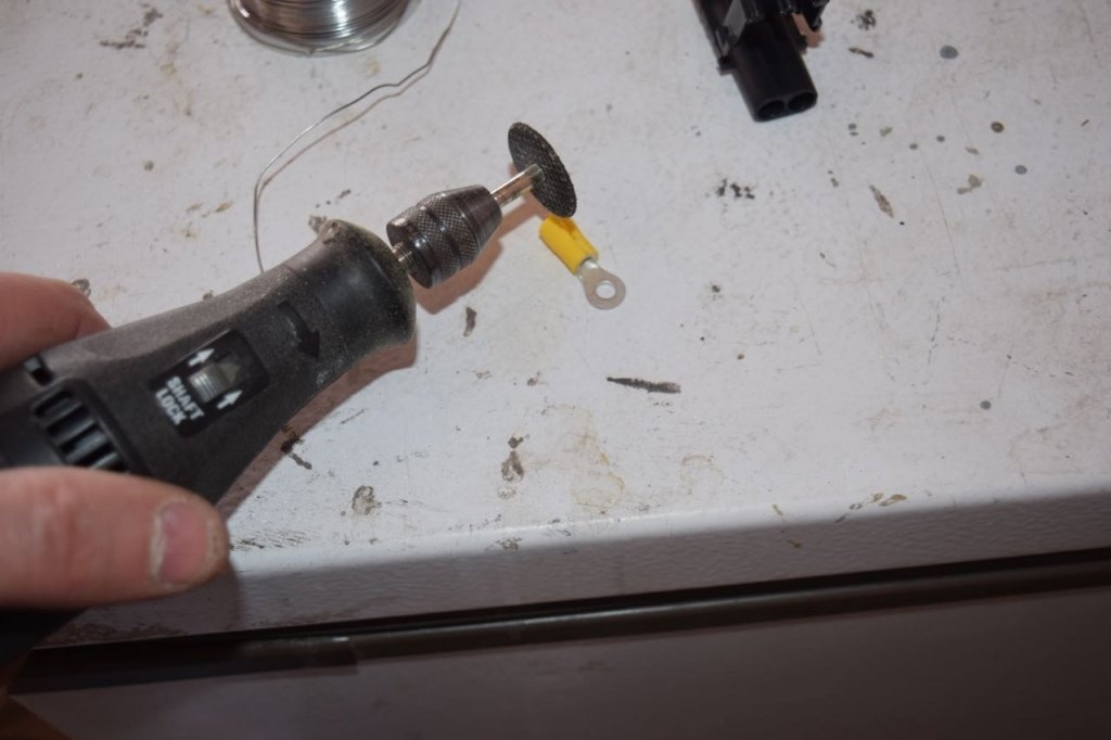

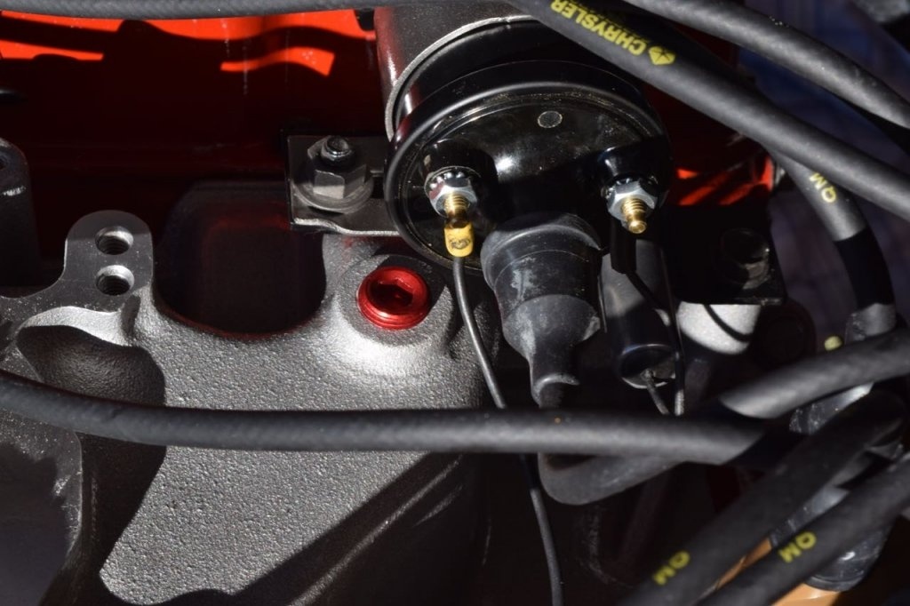

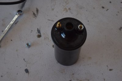

Day of little victories. The new reproduction Mopar coil did not have the flat spot on the distributor lug to fit the "D" hole in the wire so I fixed that with my dremel tool..

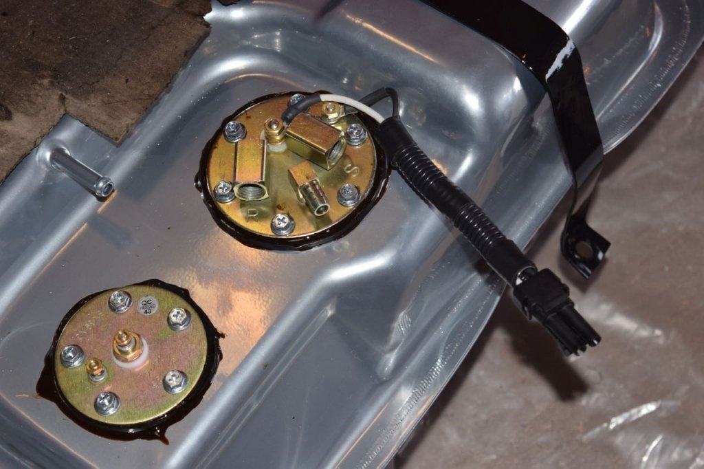

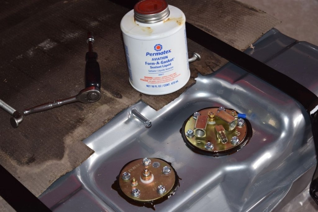

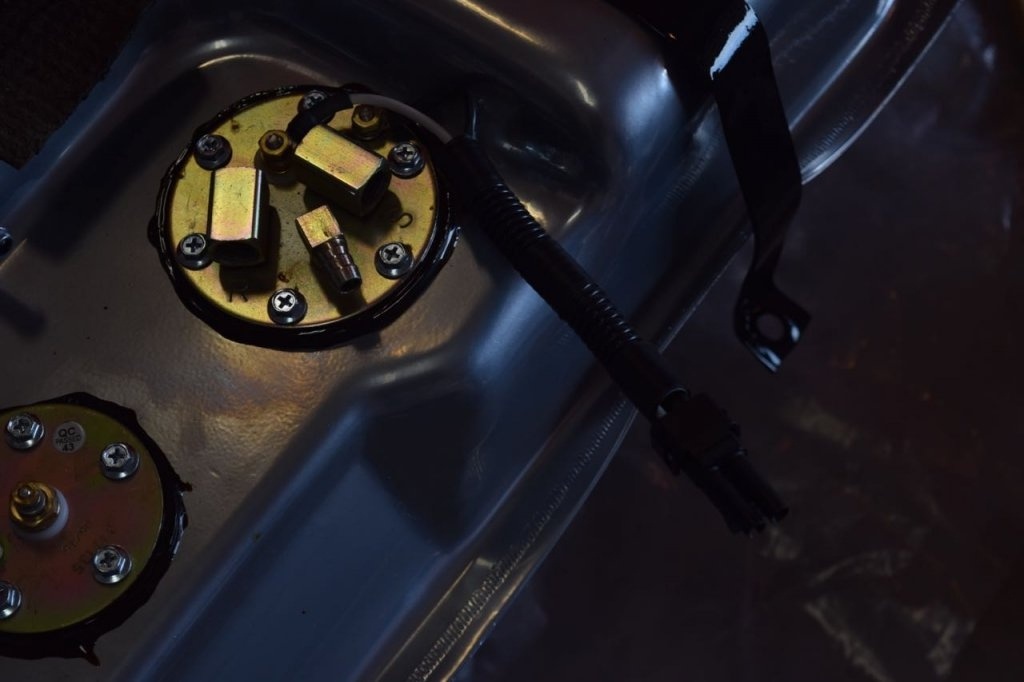

Had to go to town for the daughters singing lesson so got to go to the auto parts store to buy the nasty Aviation Sealer for the Tanks Inc tank... nasty nasty stuff... been a long time since I have smelled that smell..
I made sure I triple checked the float and resistance values compared to the stock sending unit (which is clearly starting to die).

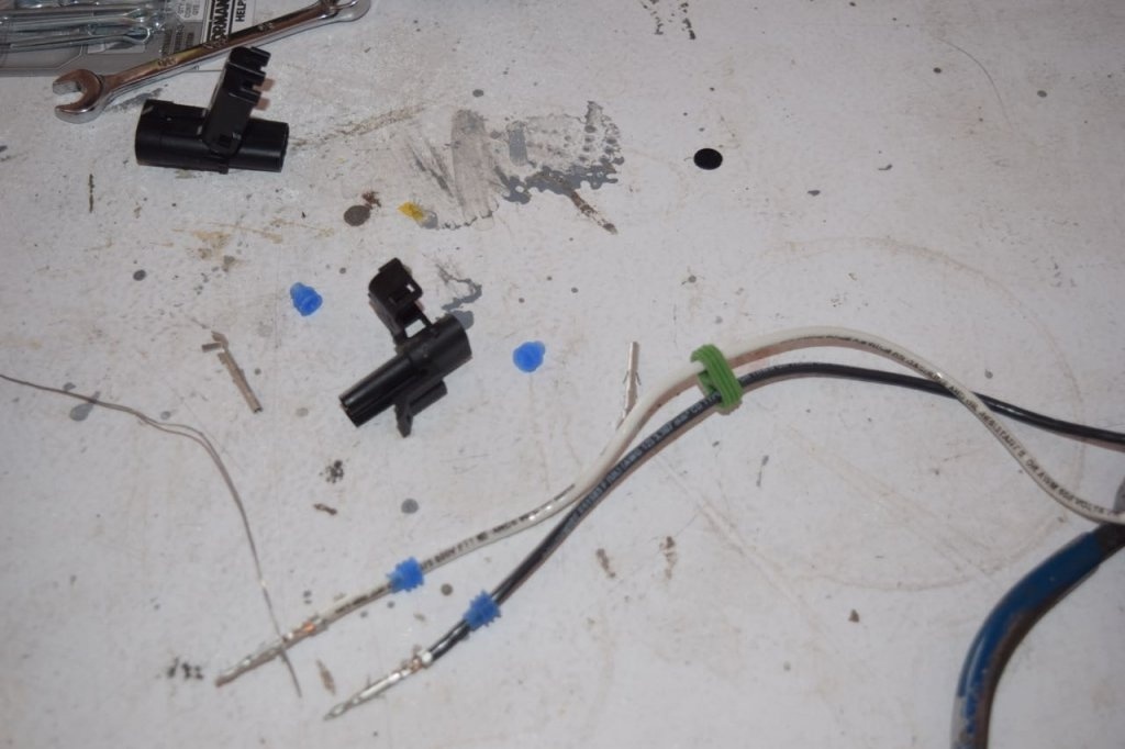

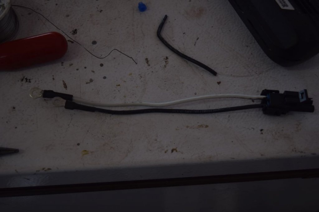

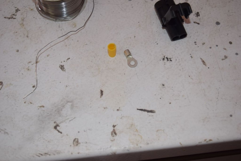

Then turned to the wiring. I bought a few Delco Weatherpak connectors off eBay and will use them to create quick disconnects at the tank. Simple to solder and assemble. Then cut off the plastic on the lugs and soldered them on to finishing them up with heat shrink tubing and wire runs... I forgot to buy 24 gauge wire at the store so the sending unit will have to wait till later in the week. Note I am going to make one the socket end and one the pin end so there is no chance of plugging the sending unit into the EFI pump controller :)

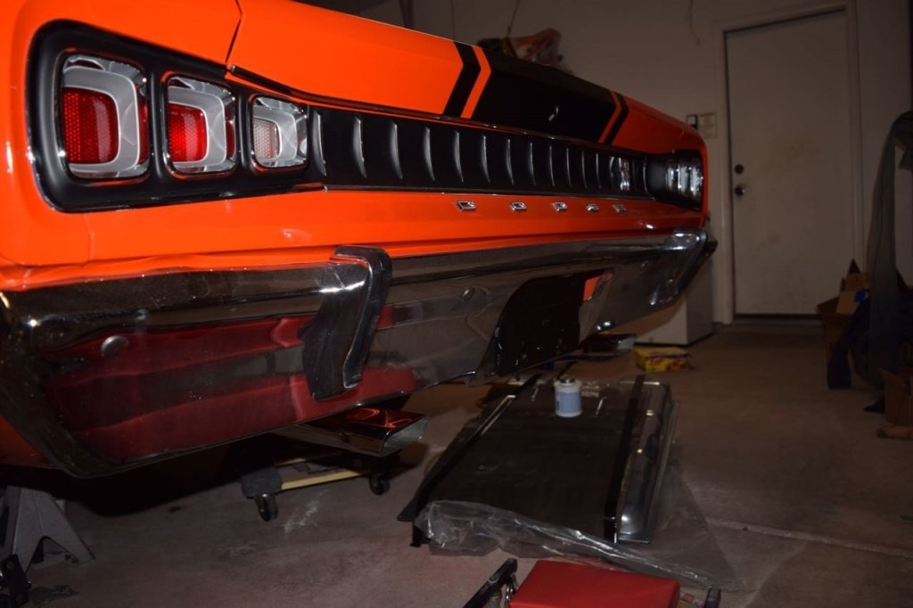

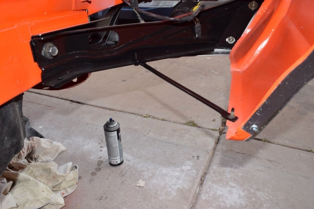

Last one little victory before closing the garage door was installing the fender supports.
I love doing wiring and especially soldering. Looks good. I have a can of the avation sealer in the garage, works fantastic on the 727 pan gasket and on the other gaskets and o rings.

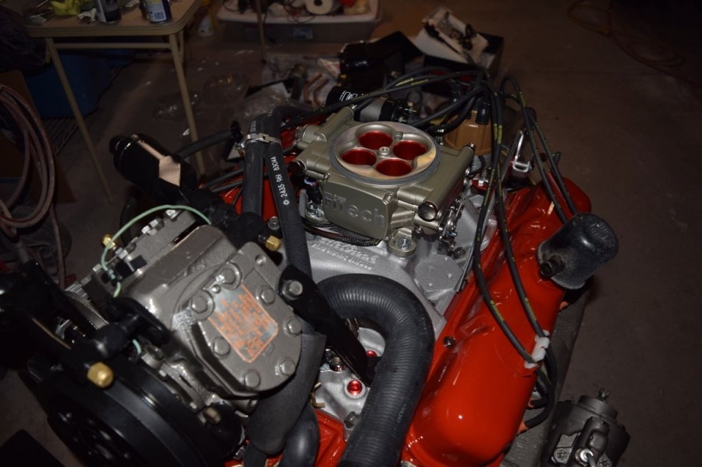

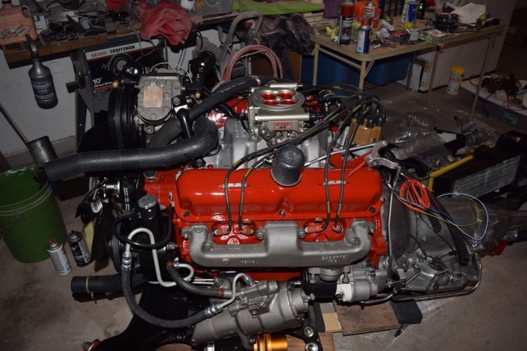

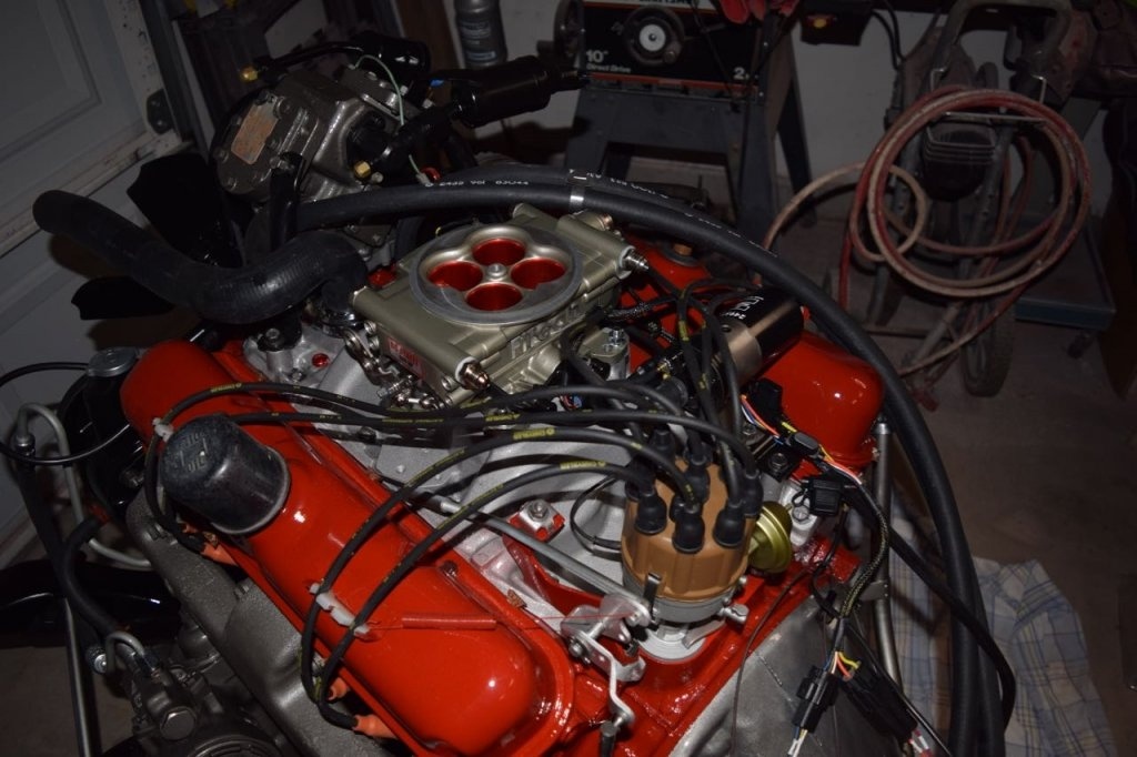

Nothing to see here... nothing but a stock little old 318....
Oh my what is this .... Look ma no carburetor......
And if you notice the label on the side of the throttle body just by bolting this on I now have 400HP!
It is like Christmas in February (and the poor house in March)....

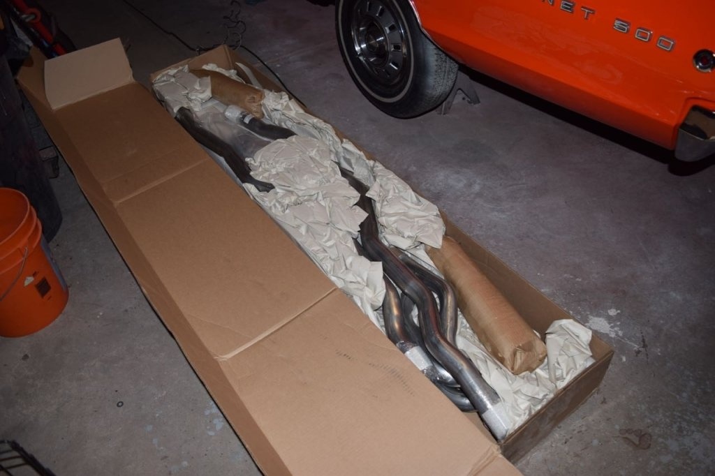

What's in the box?

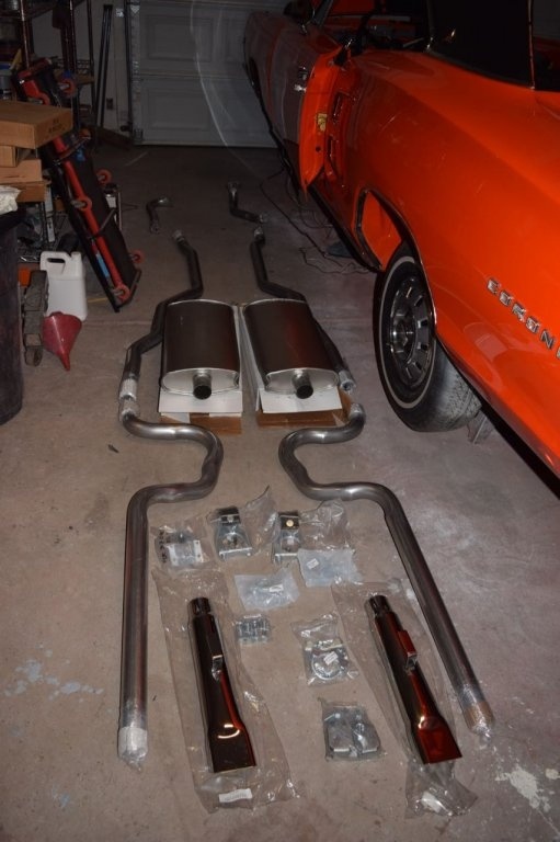

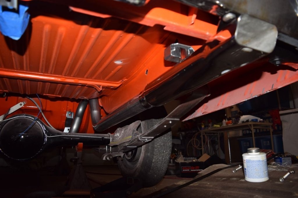

Oh my it is from Accurate Exhaust.....

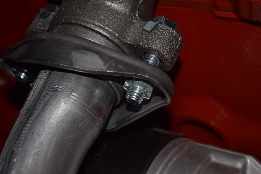

Way cool. Even down to the original manifold bolts and spin clips!

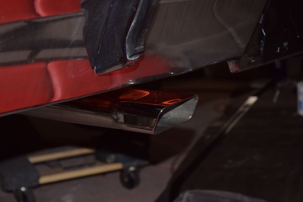

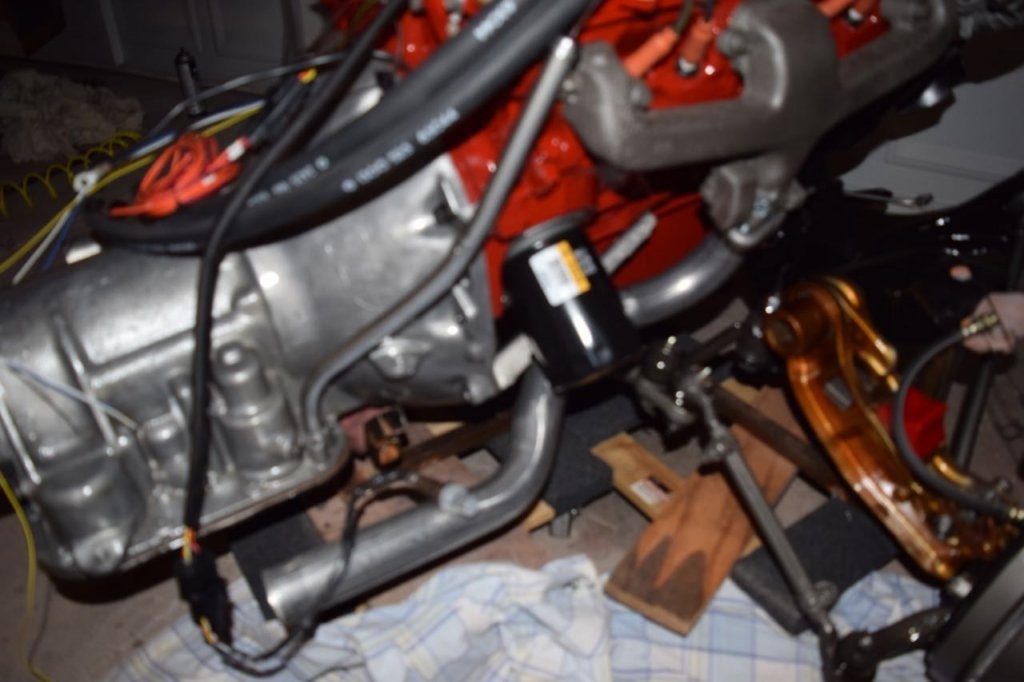

Look mom I'm a Super Bee!
Wow, that looks nice. What kind of mufflers come with the kit?
$1100?! Yikes. As nice as your undercarriage is, you won't sleep until it is right. What's another $40?
Yes it was not cheap but it is the nicest aftermarket exhaust I have ever handled. I picked up a pipe and about dropped it on my foot. That is some original gauge steel there.... The box weighed almost 100 lbs. The exhaust itself was $900 and the "Super Bee" tips where add ons plus $160 shipping.... This is a 15% off sale going on too so I was more than that.
